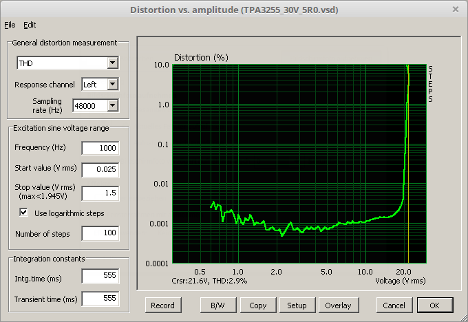

At pure resistive load, the advantage is very minor, especially at output levels below 10W. With complex loads, PFFB might control your speakers better, but this is something i haven't "tested".
I.e. the actual board performance in PreFilter PBTL without an extra AFE and no PFFB is actually like so. (PVDD=30V, Load 5R, no heatsink:
attachment.php
10V = 25W
Plot taken by Voltwide. When using "low cost inductors" the advantage of PFFB is pretty obviously. Also/especially with TPA3118/TPA3128.
Thank you Dr. It would seem you would still want to use a high quality output coil but with the PFFB circuit going to the best coils as found without the output inclusive circuit may be overkill? Would it make a difference between the Wurth and CoilCraft inductors with the PFFB?
As said (also by Voltwide), it is some kind of hairsplitting. PFFB might tighten the control of complex speakers/loads. You'd better ask Voltwide about this. If you need to get better by like 0.002% THD at 1kHz compared to the coilcraft, you may try.

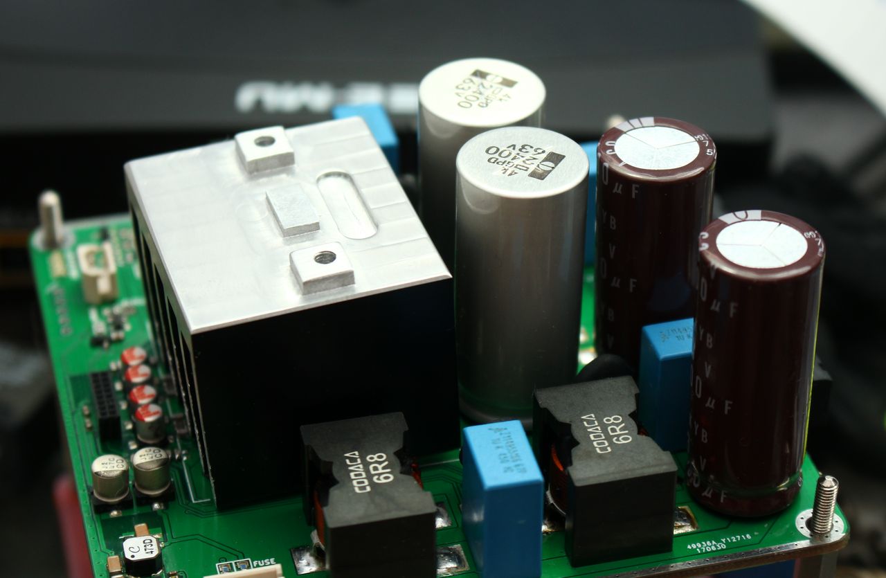

attachment.php
My modifications :
Filter :
1.
choke CoilCraft VER2923-103
2.
680nF EPCOS instead 470nF
3.
NE5532 instead TL072
4.
6 x Nichicon Fine Gold 10uF in the signal path instead 6x22uF
5.
LM2575HVS-15 instead LM2575S-15
6.
choke in the stabilizer 220uH (221) instead 22uH (220)
7.
2k instead 2.2k (stabilizer LM317)
8.
220uF (Low ESR) instead 22uF (LM2575HVS-15 - 15V, LM317 - 12V)
9.
capacitor PVDD
1500uF Panasonic Low ESR instead 3900uF Elna(???)
10.
10k 1% instead 10k 5%
