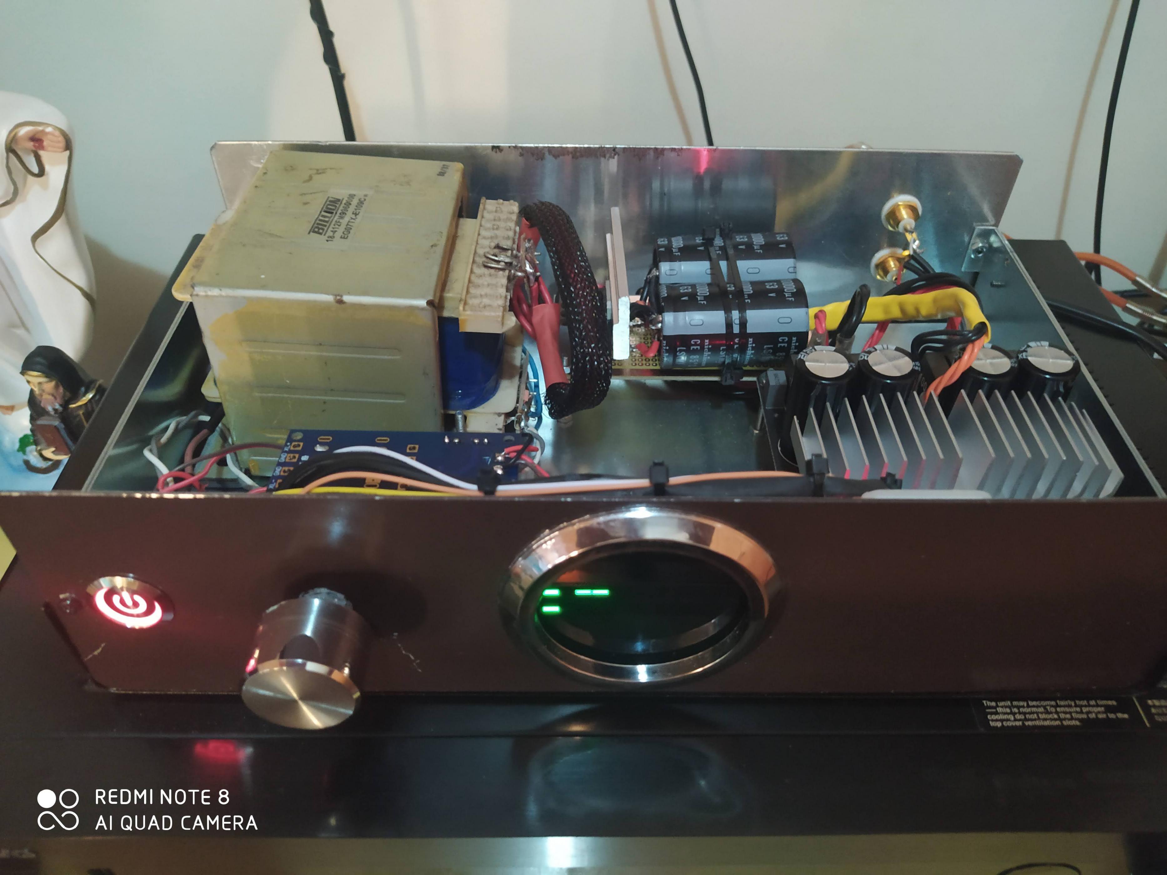

Claredes,have you tried bypassing the tubes? I actually prefer my board directly run'd balanced from a very hot dac signal. So the onboard opamps are not in use. The SNR is almost certain ruined with the tube circuitry. The 3255 scales superbly with a good dac. The 3255 haven't got any harshness to it so I feel it doesn't need tubes to melow it out.

I did not turn on the TPA3255 without the preamp.
I already configured it that way.
I have no signal source with balanced output, only RCA.
But your information made me curious about the performance of the TPA3255 running without a preamp.
Although I really liked the final result of the current configuration.
I think I'm going to do some tests.
Thank you very much for the suggestion!
The only thing that has worried me is the heating in the amplifier's heat sink and output inductors.
I have a 44VDC power supply and 5ohms speakers and the heat sink is getting really hot. Even though the fail or OTW leds do not light up.
I don't feel good about electronics heating up too much. Especially when they are Class D that do not usually heat up so much.

Incredibly, I turned on my amplifier now to listen to music and the preamp is humming.
I will remove this preamp.
Do you know if a signal source with 700mV is able to excite the TPA3255 from 3e Audio?

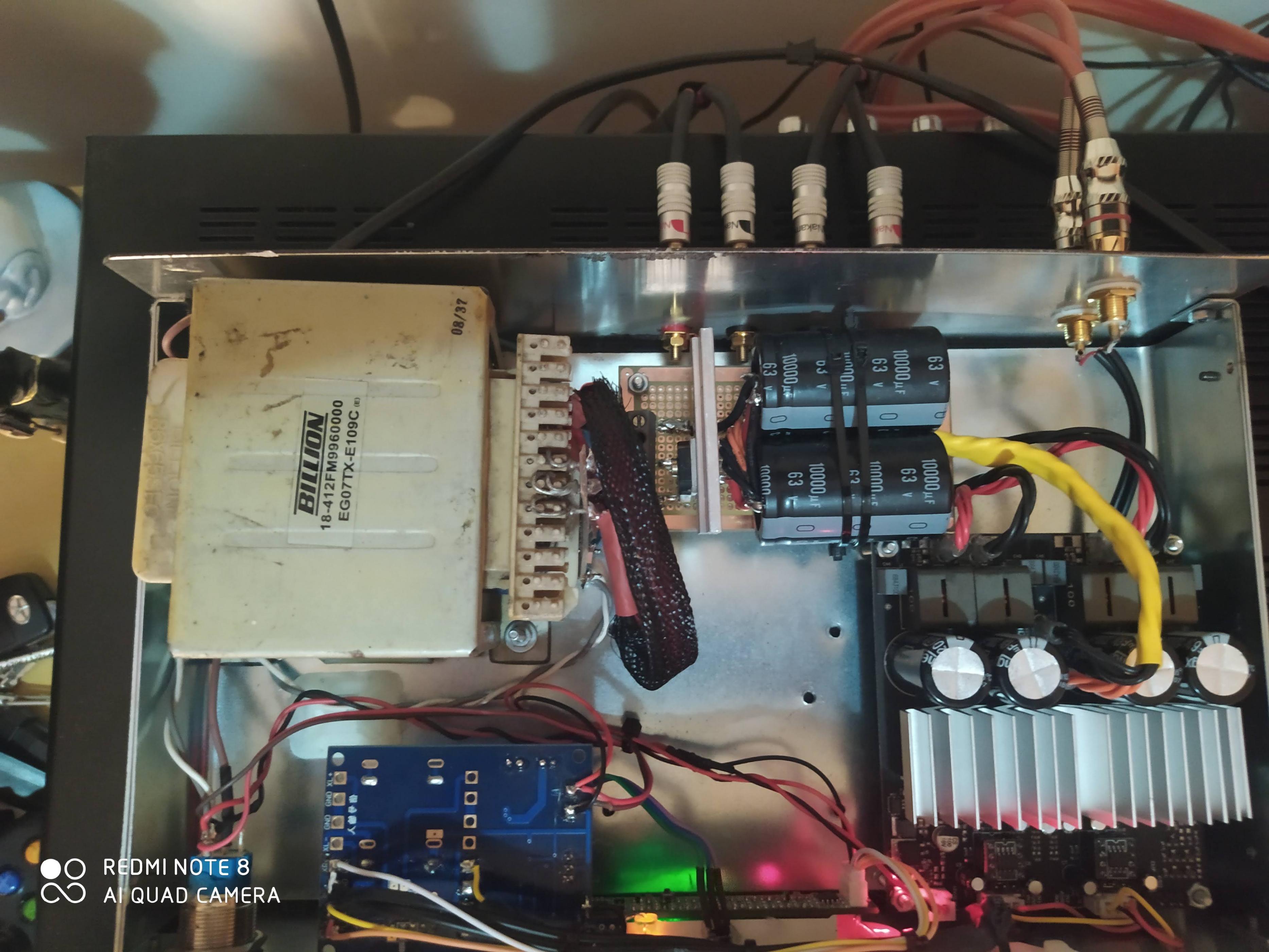

The large black block capacitor enhances the power supply at the moment of power supply.
The method of connecting a large-capacity capacitor like this is often used.
saran008
For big black cap need short and fat wires.
this wire - garbage.

Hello my friend!
I did the test today by connecting the 3e Audio directly to my signal source, without using the tube preamp.
What can I say...
It is quite another amplifier.
I immediately removed the preamp that was interfering negatively in the sound, in addition to having started humming.
In order not to lose the function of the display that I created for the valves on the panel, I placed a LED VU meter.
I also replaced the power transformer with a 26 - 0 - 26 and now I have approximately 36VDC and the 3e Audio board no longer heats the heatsink as before. Only if I use the volume too high, which I rarely do.
Thank you very much for the guidance of testing the TPA3255 without a preamp, really, it doesn't have to. His sonority is already very good, including the input sensitivity.
