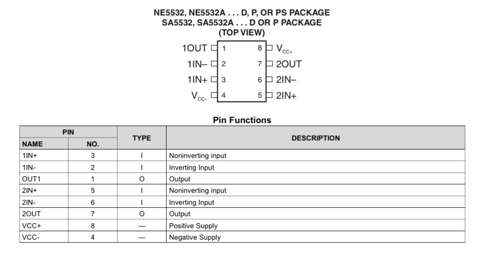

Is there a reason to jump the inverting inputs to the "out" pins instead of the non-inverting inputs?

OK so the opamp is bypassed. Dont you still have all the coupling caps?
If Your DAC has no DC offset I don't see why you cant direct drive the dif input.
You still have all the op-amp supporting resistors and caps in the path, should you remove those as well?
Input caps shorted. Resistore in Path i tought ti leave in place. I tryed to short ramainig electrlytic caps but fault led light up
Pin 2-6 non inverting input pin 1-7 output
Am I misinterpreting things because it’s a balanced input?
Just askin’.
Just askin’.
Yes balanced

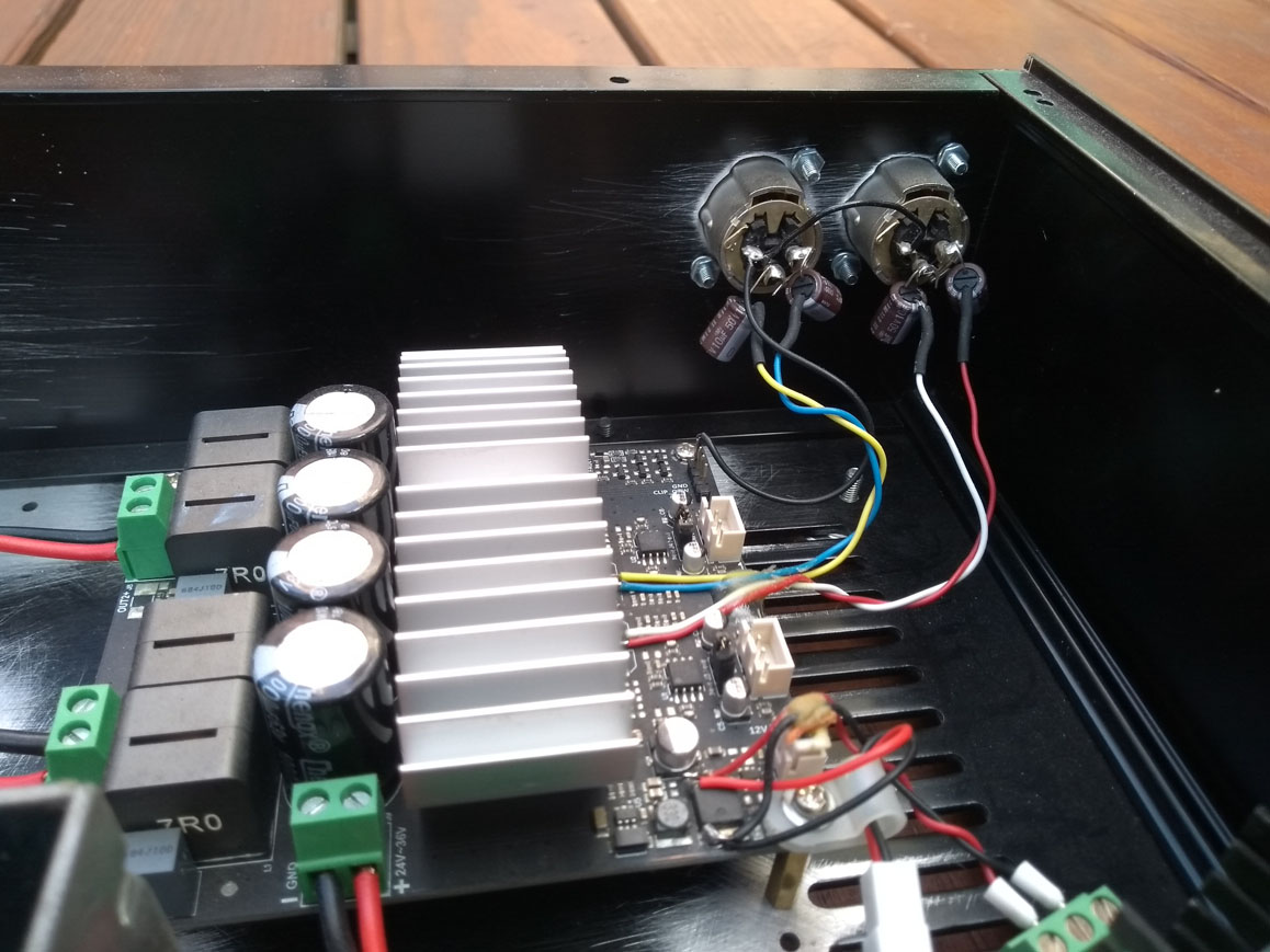

Input caps
I ask to experts: may short input 10 uf caps and mount 4x10uf MKP caps on a dedicated board before input connectors?
10 uf is best value or i can try something different?

Yes. Or depending on how big (and heavy) your new caps are, you could solder them directly to the XLR jacks, as I did.may I short input 10uf caps and mount 4x10uf MKP caps on a dedicated board before input connectors?
