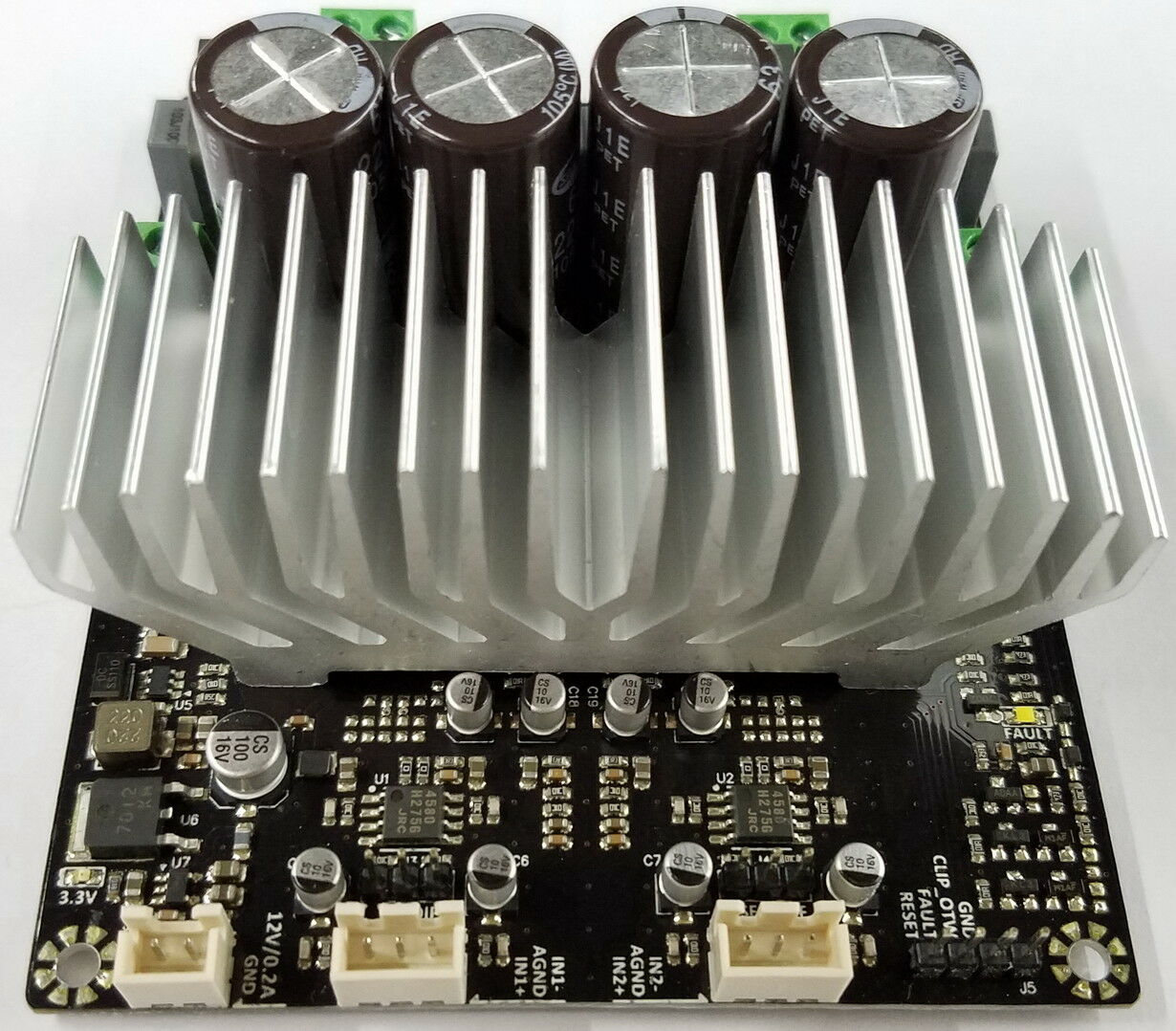

Hello guys.
Does Anyone knows how to bypass input OP AMP on
The 3eaudio 2x260w board AMP ?
A picure could be a big help.
I do not need a lot of power and i would like to try to use it directly with a topping dx7pro (balanced output).
Someone mentioned (in another Forum; I’m trying to find the link) to just remove the op-amps and feed your input signals into the output pin/connections of the op-amps. The post had more information on the particulars of doing that

That is exactly what I plan on doing. I bought a set of Nicron gold caps but think I will just go for the direct connection from my new DAC.
Thanks a lot for your answers. I'll try to contact linuxfan if i do not understand how to do this.
I've found some infos here : https://www.diyaudio.com/forums/class-d/276982-tpa3251d2-145.html#post6186207
If i'm right, we can replace Op amp with this : 10pcs 8Pin DIP-8 SIP Round IC Sockets Adaptor Solder Type IL | eBay
and solder input from XLR as mentionned in the first link.

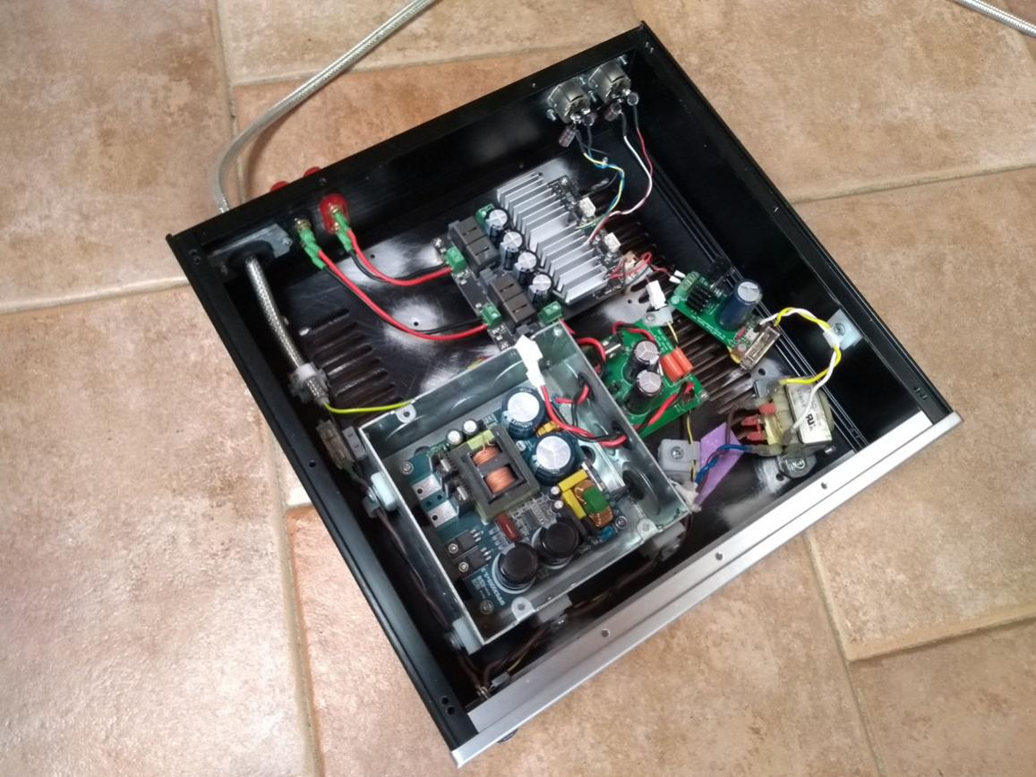

tpa3255 + psu, testing.
Waiting with positive anticipation.
I think this may work as long as dc current fed into the op-amps output is low (i.e. in the ballpark of 1mA). Otherwise you may insert dc decoupling caps into into the feedback network.Thanks, I know, please see below where you will find the opamps use symmetric supplies. The question concerns the 1/2Vpp the tpa3255 outputs are on - typically 25.5V with a Vpp of 51V. Doesn't the dc imbalance between the driving opamp output (0V) and the OUT_X (Vpp/2) mess up the control loop ?

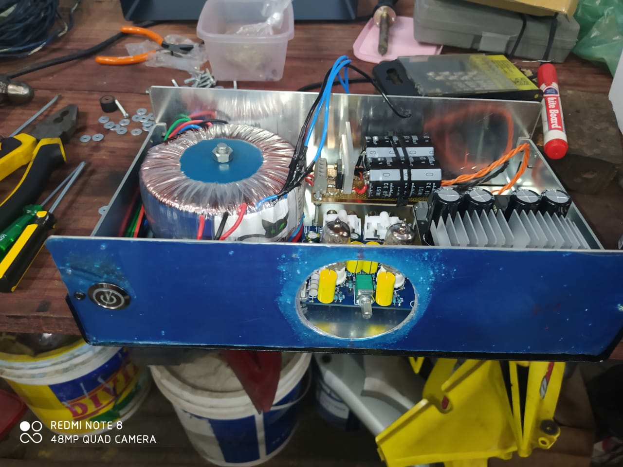

Beast in building..New amp+PSU
Now in Action..tpa3255 + psu, testing.
Excellent Build doc..
It seems to me the DC will be divided by R_fb (33k?) and R_in(2,7k?) which would make the DC offset before the input cap abt 0,08* the offset on the output.
As mentioned before, it would probably be the current that could do something to the OP-amp.
