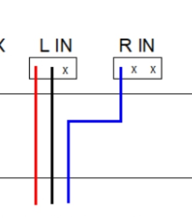

Can please verify the below schematic is correct?
1. Most of the front panel ON/OFF push button used to ON & OFF amp.
2. IEC cable connected with PC Multisocket power strip, AC POWER ON/OFF controlled from there.
3. USB DAC for PC USB & RCA for Mobile, will be used as inputs.
4. using SE inputs only, no Balanced Inputs.
5. Simple Desktop PC amp purpose, as of now
Kindly advise.
Why not connect the GND for the R IN?

I think the AGND is common, I saw somewhere in this forum or ASR, somebody using same type of connection and it's working in same board. am i right?
BTW connecting that is also possible.

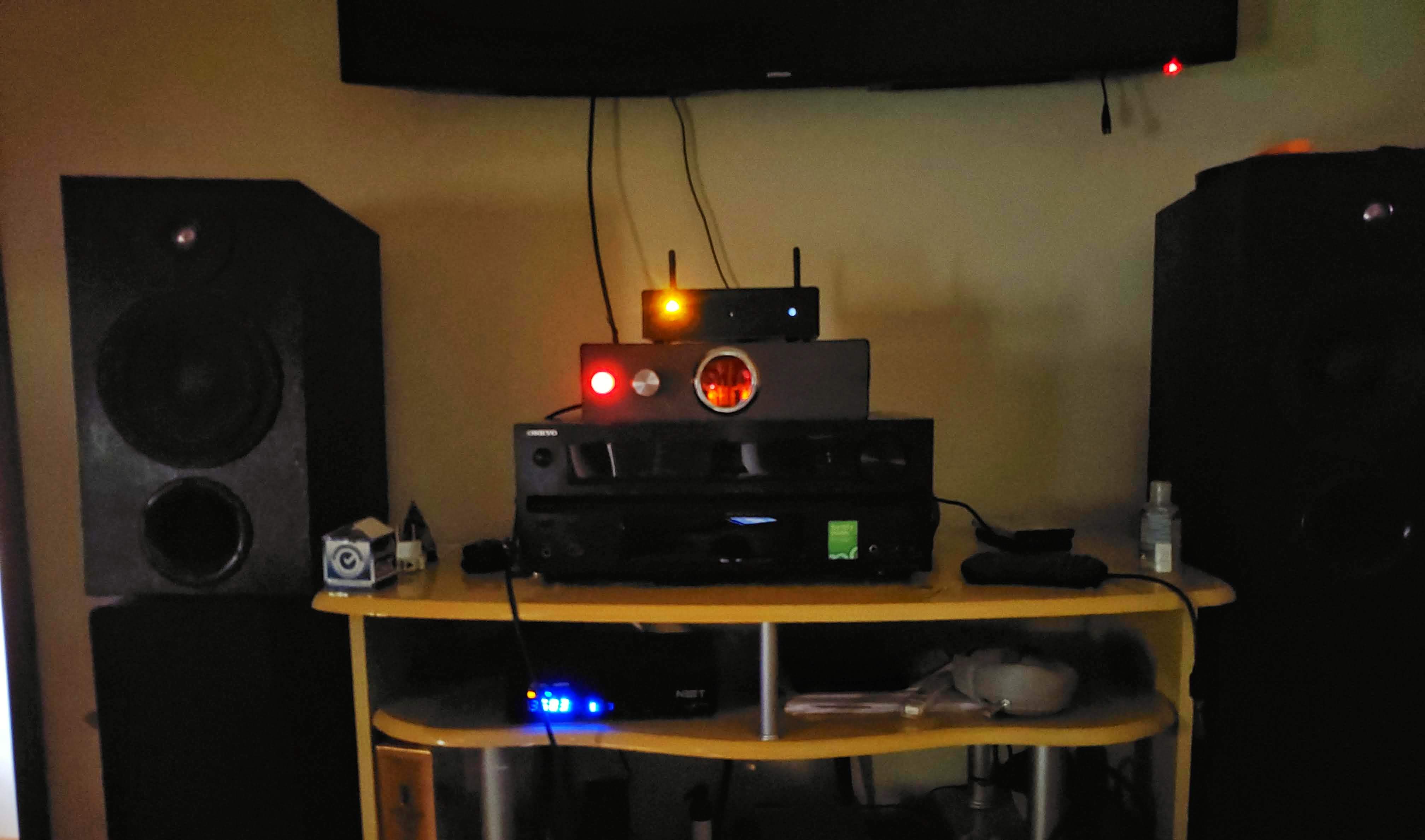

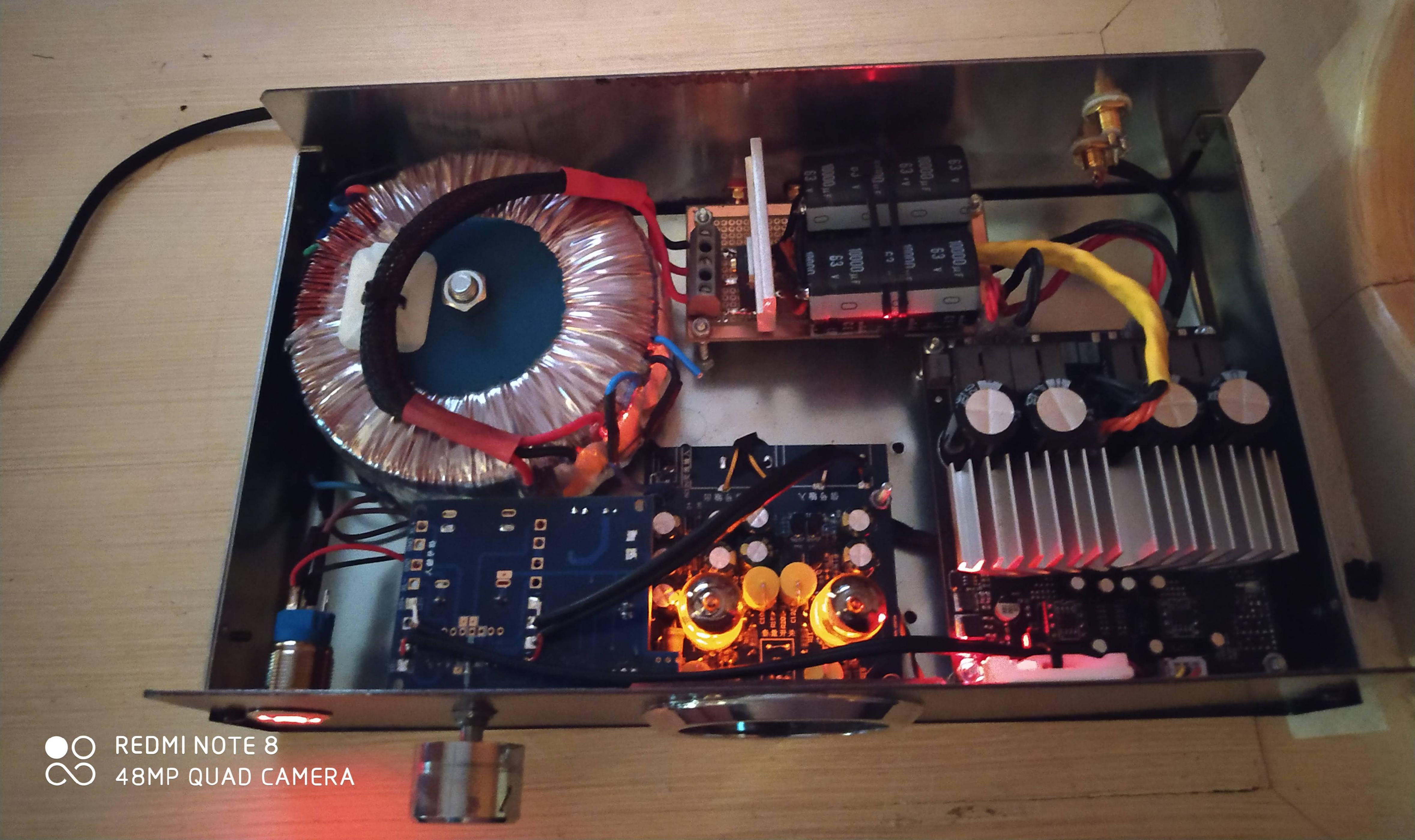

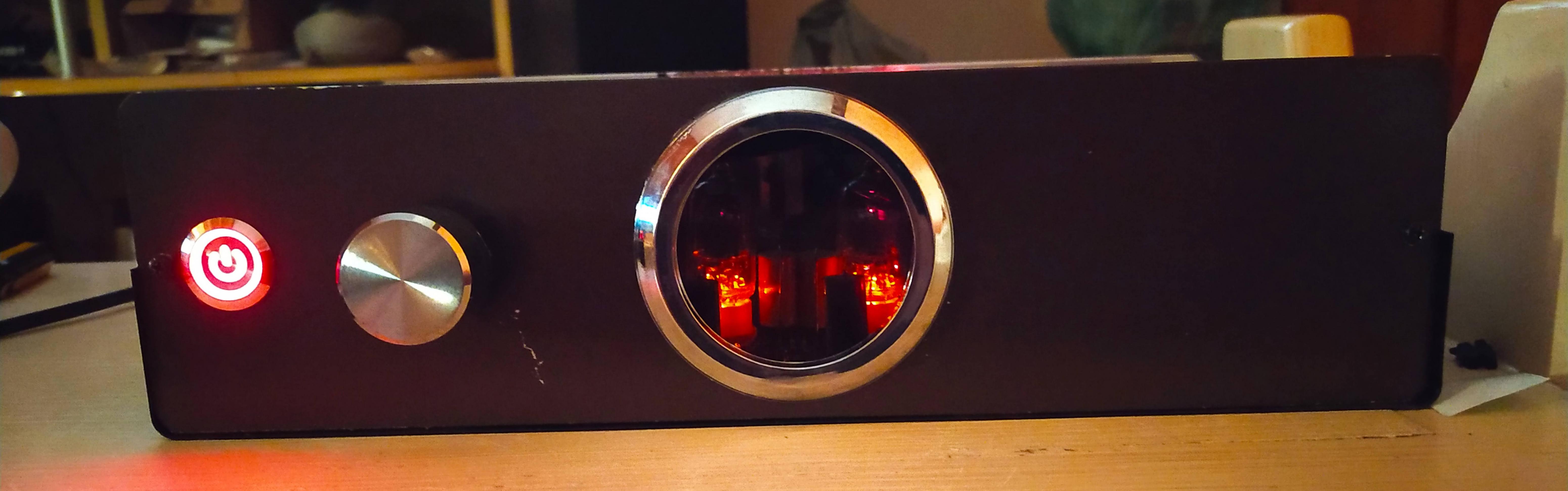

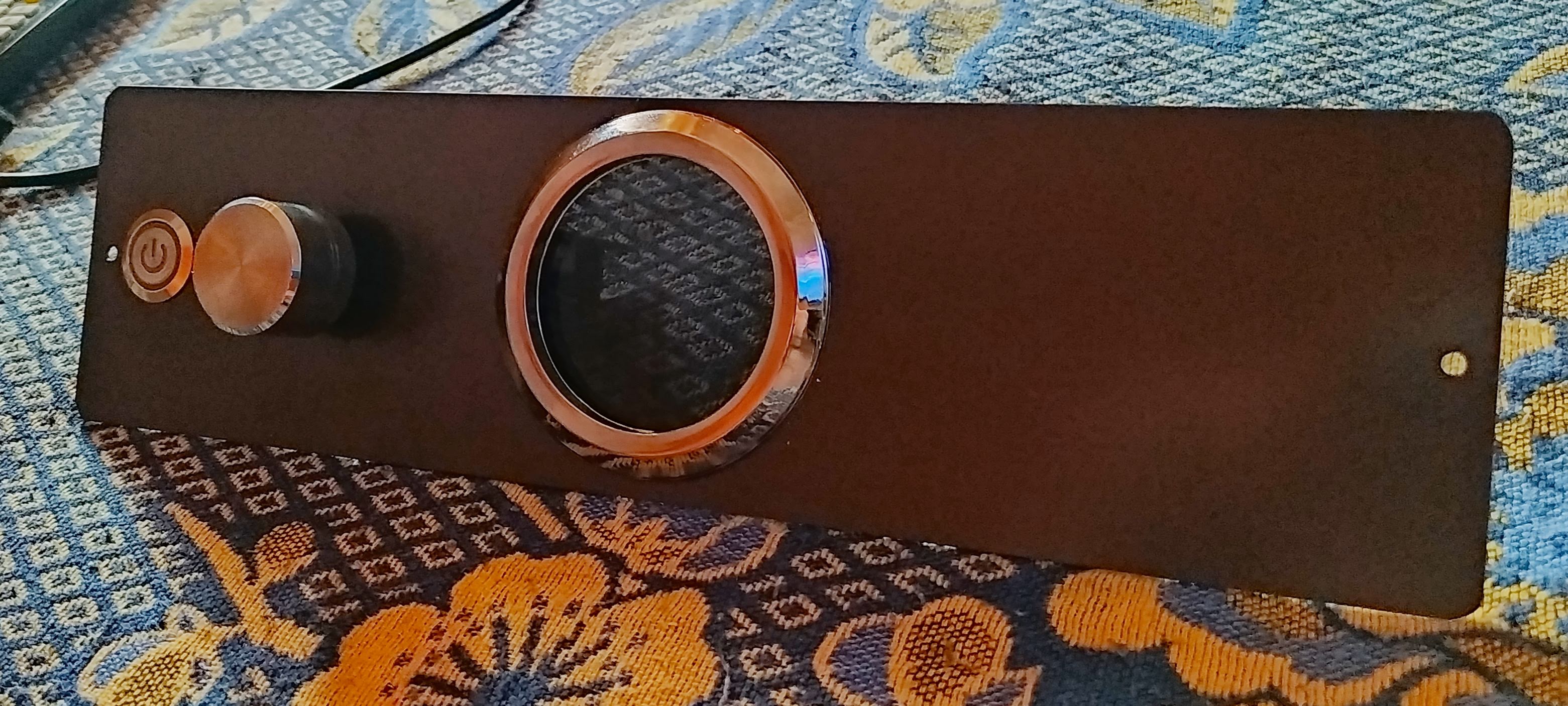

Hello guys!
I come to show the conclusion of my vision of a TPA3255 3e Audio.
This is Rev. B from 3e Audio, a Chinese tube preamp, 44VDC linear power supply with 20,000uF.
The amplifier is handling 5ohms speakers with great competence, with very powerful bass without sacrificing the mids and treble.
Despite what is said about this preamp, I was lucky, because my unit has not heard any noise in any volume range, even with the volume at minimum and putting my ears on the tweeters I do not hear any noise.
From now on I will do auditions with this setup but right now I can say that I did not hear so much difference for my reference AB Mosfet amplifier, could the tube preamplifier have softened the sound of the TPA3255?
I am enjoying it, I will listen more and come back to give more opinions in a few days.
