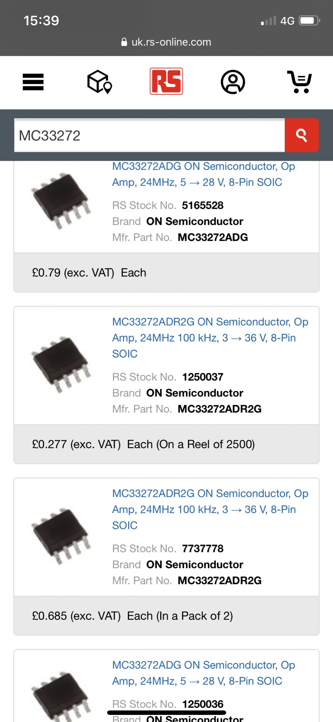

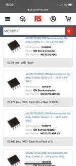

Thanks linuxfan and drMordor. I am going to go for the MC33272, my soldering has improved a lot so I will hopefully have no problems. Not sure which version of the MC33272 I need, there are 2 on RS Components. drMordor which ones should I get?

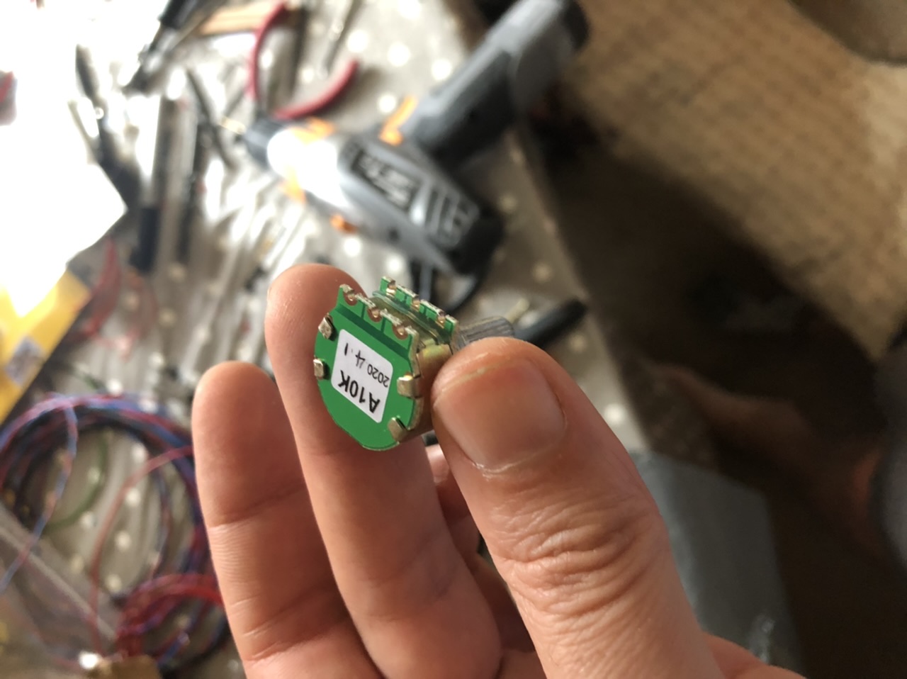

I used an 10k SMD DACT type 21 step attenuator on my amp. They were £10 on eBay. I chose these after seeing one in an expensive passive preamp that had a lot of very good reviews. Not sure if it is the one from that preamp but it was green and the same type. I tried a brown one but when turned right down I could still here the music. Sorry I don’t have more info...get a green attenuator!!! It has perfect balance to my ears and the signal only ever goes through one resister.

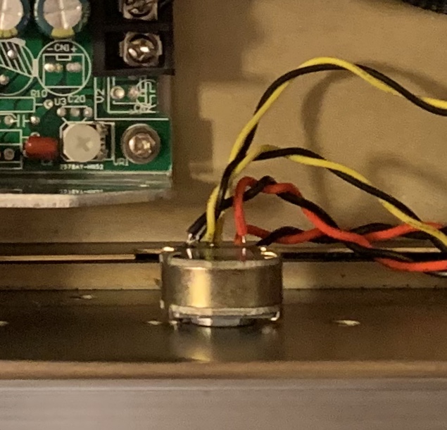

This is how I connected my pot. If it is wrong please can someone post that I am an idiot.
The right hand red wire is from the DAC, the middle yellow wire is to the amp and both black ground wires are together on the left. This is the same for both channels.

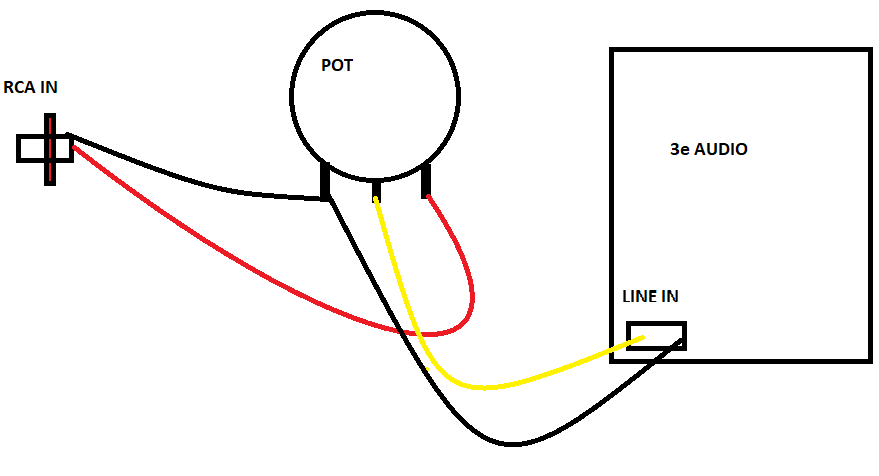

I think our ways of connecting the pot are similar.
I did as in the diagram below. The same for the other channel, with the potentiometer being stereo.

Thank you for the reply and diagram, that helps. I think these following products should do exactly that, except that the POT can handle both channels at once instead of having two individual pots. what do you think?

Yes, whichever of the two you posted the link to will do what you want.
