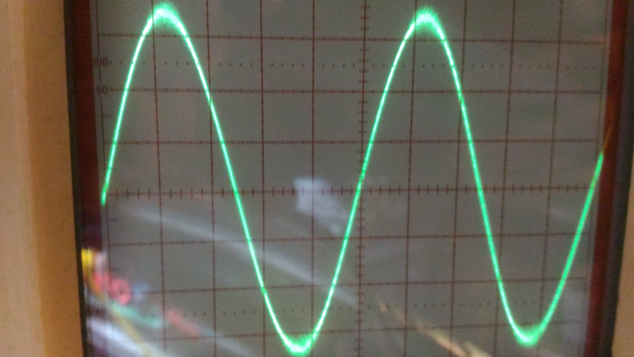

I have a TPA3251D2EVM board that I'm sorting for a friend. I upgraded the op-amps to lme49720's and started testing with resistive loads for max power before clip LED illumination. The results somewhat lower than I anticipated for 1kHz @ 36V:
51W into 8 Ohm
95W into 4 ohm
123.5W into 2 ohm
I get 72W and 138W into 8 ohm and 4 ohm respectively before flat top clipping which is in line with the 1% THD+N figures in the datasheet. The waveforms however look far worse than 1% THD+N with a lot of switching noise, see attached.
There is also 1.2V pk-pk at ~570kHz imposed on the output signal at all times, irrespective of power output.
Does any of this seem familiar to anyone?

You CANNOT judge THD by the scope plot of class-d outputs.The waveforms however look far worse than 1% THD+N with a lot of switching noise, see attached.
The visible "smearing" may vanish into zero after an appropriate low-pass filter.
Furthermore THD of a BTL-configuration should be measured across bridge outputs -
measuring between on half-bridge out and GND will show wrong results.
And finally: Yes, this is a switched amp and therefore you will find some RF residudual at the output on any class-d amp.
