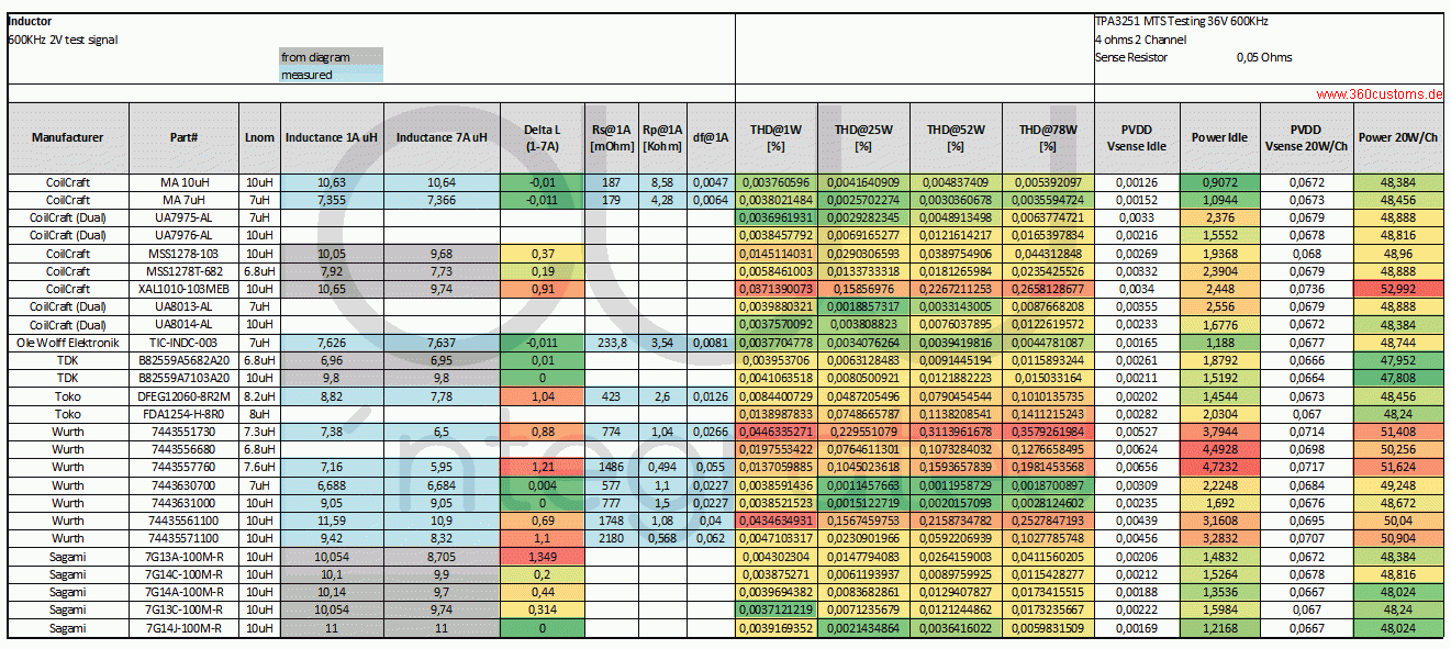

That's easy, look into this..
attachment.php
The table is based on data from Texas Instruments Application Note and inductor comparison. I added some additional data from vendors datasheets and calculated some values from it - finally did heatmap rating to choose an inductor for my needs.
Several Coilcraft dual inductors shown in the table are still not available to buy. Those have also mentioned on the TPA3244/45EVM manuals.
Testing conditions are stated in the tables head. Would guess they've had used an AP to do the measurements.
With reference to doctormord post 1208.
Great data by the way.
Thank you.

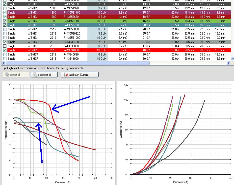

I took a look at the Wurth inductors listed and looked up their data:
The two inductors with green in the "THDvsPWR" columns showed flat L vs I curves.
Makes sense.
Wouldn't an air core also have a flat L vs I curve? Why does no-one test air cores? I dont understand why ppl say cored inductors are bad in speakers but ppl are using them for class-d saying how great they are. And the cored test results for the same inductor clearly differ - yet people think its accurate data. Something not right in the logic here?
