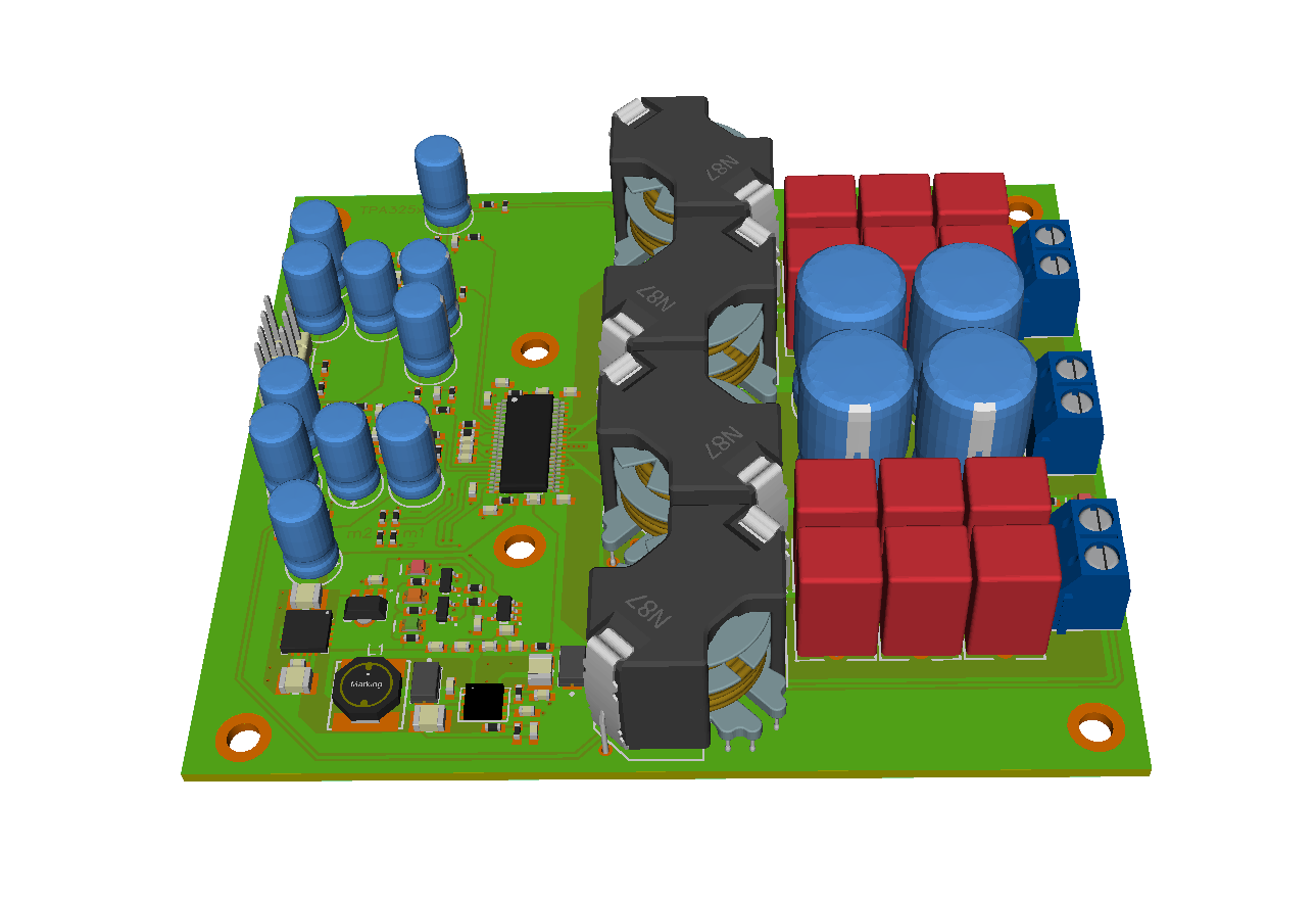

My project
Very nice, which software you used to make the drawing?
