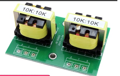

PM sent ! 🙂 I saw these - seems to be what I need except for the impedance, so not really: https://world.taobao.com/item/36037344558.htm?spm=a312a.7700714.0.0.biJvkC#detail
Thanks! There are times when I think Taobao is doing a Jedi mind trick on me.
Those Taobao trafos look fine, assuming that the stated 35H primary inductance corresponds to reality 🙂 They probably won't have the best CMRR though as they look to have the primary wound over the secondary. On second thoughts it looks like they've addressed this with an interwinding screen connected to the laminations. Nice job - be sure to ground that pin to chassis and not to the local 0V

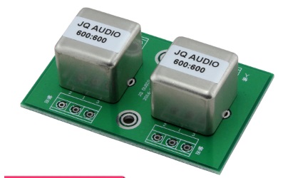

Wouldn't these transformers pickup noise easily as they aren't shielded?
I think you can order with the casing for magnetic shielding.
Nice, you have a direct link?
https://world.taobao.com/item/541836460157.htm?spm=a312a.7728556.2014080708.6.3IDltC
https://world.taobao.com/item/54186...spm=a312a.7700824.w4002-10656758547.51.e13TwA
The correct link for the 10K:10K input transformer.
