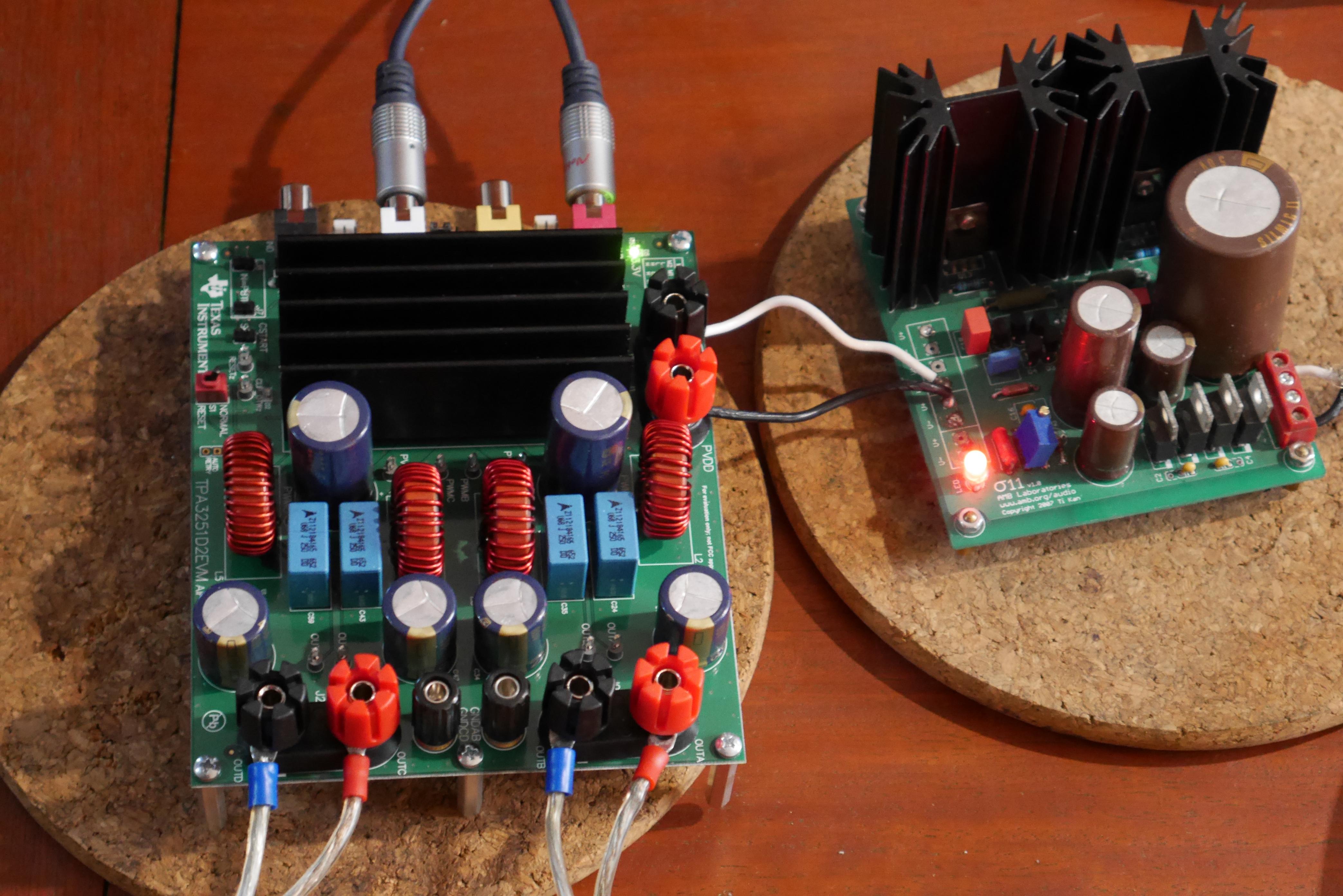

I got my evm - sounds good but I'm having this problem with a linear 19V 4A linear supply and 4 ohm speakers. The regulator is AMB sigma11 from an 80VA talema toroid, and doesn't drop out of regulation, so I guess the amp is current starved ? If so, a bigger transformer ? It's surprising that this amp is so hungry. My experience is that class-D sound great until they suddenly start distorting but this amp shuts down? Weird.
Forgive me joining in, but I received my 3250 EVM board on Friday, connected it to my Pi and a 36v 10A supply, without issue. I don't think 4A is sufficient.
Or combination of psu-voltage used and bulk capacitance as mentioned in evm userguide ? The AMB supply is small though and wasn't there an overlooked cap multiplier problem with them ?
NOTE: The performance of the TPA3251D2EVM/TPA3251D2DDV is dependent on the powersupply. Design the power supply with margins that can deliver the needed power. In lowfrequency applications additional bulk capacitance may be needed. Replacing the bulk capacitors on the TPA3251D2EVM with 3300 µF or more capacitance may be necessary, depending on the power supply used.
Have you tried power in in shutdown-mode or did you wired a short somewhere?
(I once accidentally powered a 3255 with the power plug connected into OUTA/OUTB, fault-led went on, nothing failed)
Uhm, "TPA3255 Device Setup Guide & Configuration Tool" will give the answer..
3151 can deliver 1 second 150watt into impedance minimum of a 4 ohm speaker. Powersupply s11 is standard 1A continuous (20 watt), maybe 2A continuous (35 watt) here (heatsinking), with lot of headroom for peaks.
TI config tool estimates 6.3A and 7A needed for 3 ohm/19V, maybe the 20 or 35 watt powersupply can deliver that for 1 second ?

I switched transformer today to a 150VA 30VAC. The amp no longer shuts down. Running music full volume from my phone, the clipping light stops flashing at a regulated 24V.
When I switched to a 2v rms DAC as the source, I can get to -2dB from full volume without the clipping light coming on by turning up the regulated voltage to 32V. Above -2dB the light occasionally flashes regardless of voltage (tested up to 37V, board max is 38V) but the sound is just too loud for me to care whether it's clipping peaks or not. My normal listening volume is around -24 to -20.
The S11 with 2.5"on board heatsinks doesn't get hot with 32V output and full volume - just warm, and it has 39V minimum after the bridge rectifier so it won't drop out of regulation.
So I guess 5A, 24V is about the minimum for this amp and ideally it wants around 36V 7.5A for my speakers and ear-bleeding "fun". I guess a 32VAC 250VA transformer would be enough to make sure it never goes into clipping at full volume. However, I'll never listen at that volume so it's just a case of whether a lower power source impedance would matter. Given the S11 has a very low output impedance, I'm not sure it does and I will probably stick with the 150VA 30VAC and spend the money elsewhere.
Quick pic attached. I'm waiting on my Taobao transformers now... and thinking about changing the onboard regs - LM338 for 15V (2x LM329 at the base - click this link for an explainer) and TPS7A4700EVM for 12V. Has anyone tried changing regs?
