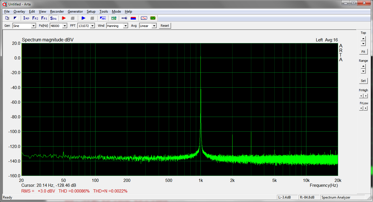

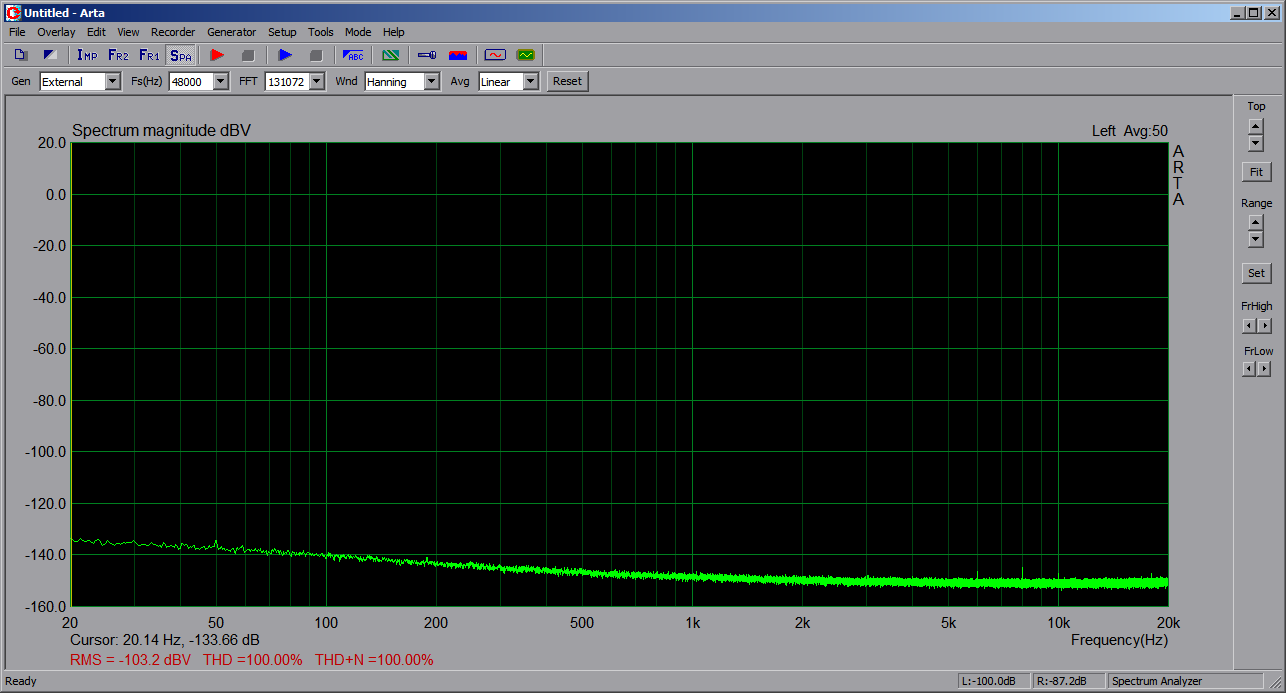

Not being MrMax, but the NJM4580 are pretty good devices. They also do in my test equipment in the pre-stage.
I wouldn't call this to bad:
shorted inputs + ADC noise:
1kHz +3dBV:
