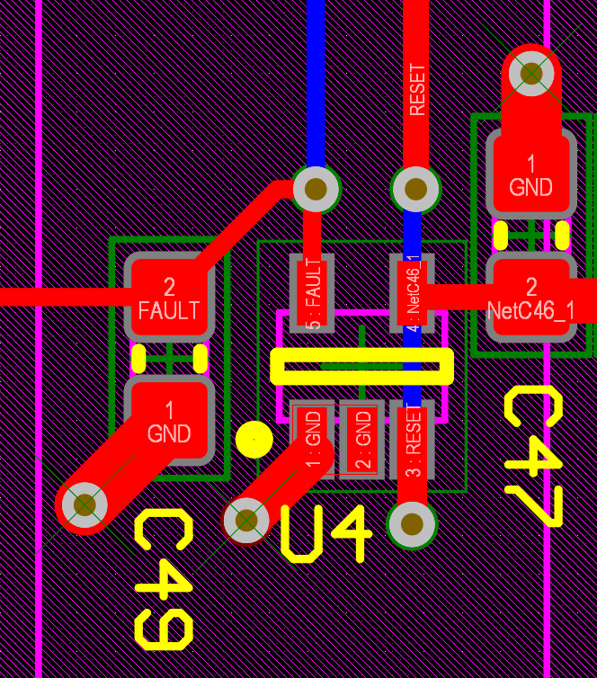

Thanks for helping out doctormord. Yes, it's very strange... I'll investigate further tomorrow, thinking about swapping out the TPS-chip with a new one if nothing else works. The footprint appears correct to me, see picture (removed the polygon pours for clarity).

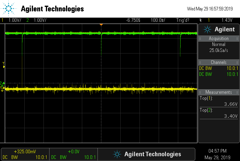

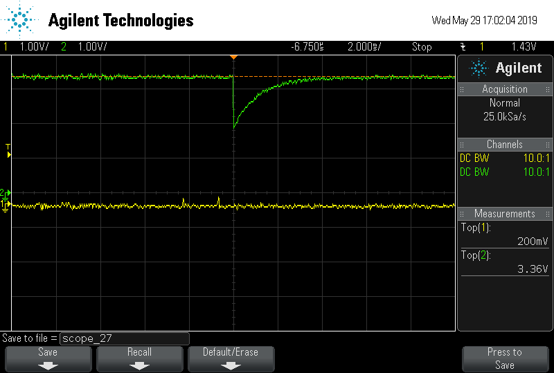

Thanks, PM sent. Just an update on my measurements. The screenshot I attached above gives the impression that /MR goes down slowly. In fact it dives instantly every ~400ms when /RESET tries to go high, and then goes up to VDD with a trace that looks like a capacitor charging.

If you're in a noisy environment, i'd recommend an RC-filter (timecontant) on the /MR pin, like 1kOhm + 1uF, as the TPA3802 is kinda sensitive to EMI pickup. (It also does not feature an internal glitch filter and will do a reset from pulses as short as 100ns)
I actually had trouble with an TPA3255 + TPS3802 in bikes soundsystem, where the TPS resets at high output levels due to EMI or ground induced noise. 1k + 1u fixed that nicely.
Ok, thanks for the tip. I only have a series resistor to limit the current when /RESET is pulled low manually. But my build is for home use and safely stuck in a box so fingers crossed... Btw what exactly is the purpose of having both VDD and 15V connected to the TPS? The 15V is pretty straight foward with the voltage divider but I don't quite understand the 100k resistor and 1uf caps at the PVVD connection.
