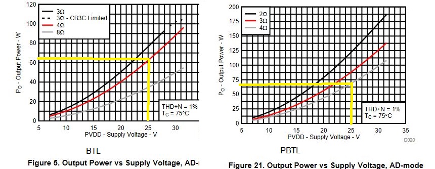

Yes but the amps in PBTL mode are only more powerfull with low impedanz.... the same for TPA3116 for example... the 100W are only with 2ohm speaker...

So I guess the big question is how does the TPA3221 chip compare to the TPA3251 and TPA3255 chips. The TI spec seems to be lower with higher distortion figures but the design is such that it is easier to build a small amplifier with less components.
The amplifier above seems to be taking this chip the the extreme with two mono channels. You might ask why they didn’t use the TPA3251 chip but I guess this would need more components. The power supply limitations seem strange as clearly the chip will operate up the 30 volts. The volume control even stranger !!
Subjectively speaking the TPA3221 can sound better because it gives the option to optimize the power supply for the signal stages of the chip. That's very hard to achieve on the TPA325X which isn't designed to have its on-chip regulators bypassed. In terms of measurements, I think TPA325X win on most counts.
I agree its strange they didn't design to the max 30V the chip permits.
