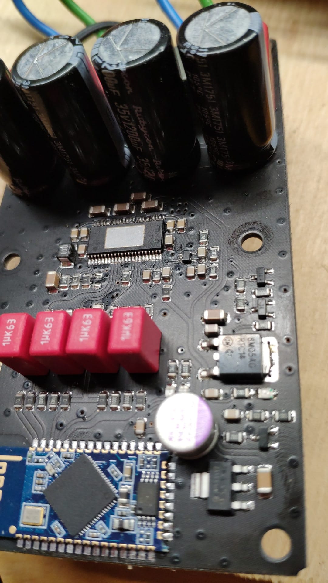

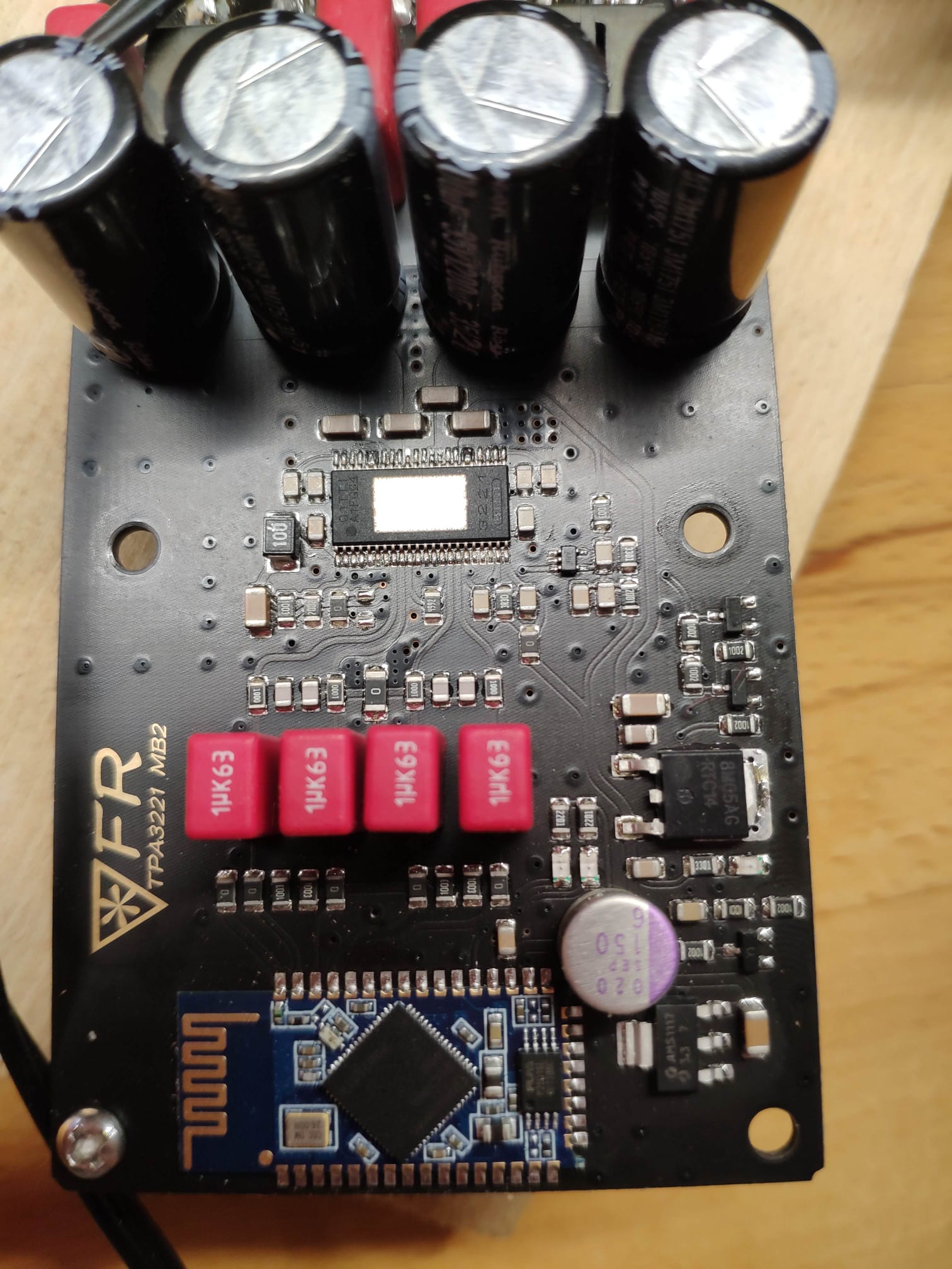

Have you mesures the output inductors?
I was first between yours amp and the FR one I bought. More than twice as expensive but really good quality. No click or clock ant start-up or shutdown.
Bluetooth connection is also good.
Capacitor looks to be original and no fake.
Ruby on caps seem to the also no fake
No opamp... But symmetrical audio feed by qc3008.

The output inductors (chokes) seem similar to those used on the "old" blue TPA3255 board. No measurements. Decent quality, not top quality. I do not say that this TPA3221 board is perfect. My initial impression is that it is a correct implementation for an 18$ TPA3221 board.

On the boards you bought, I can see a very basic regulator (LM7805?). This type of regulator cannot suppress the noise coming for the supply, nor effectively regulate HF switching noise generated by TPA3221 itself (class d).
I wonder why these Chinese board add this component. This amp has an integrated regulator for AVDD which may be much more efficient for PSRR and load regulation!

There is indeed a 7805 on the board. I have not had the opportunity to study how the VDD, AVDD and GVDD are connected on this board. A priori, AVDD seems to be the important (low-noise) voltage while GVDD (gate-drives) is pretty unimportant (noise-wise). VDD is just input to the build-in LDO. There are no LDO performance data. To have the best control I would make my own low-noise AVDD regulator and a bulk 5V for the GVDD.

Yopi you're right. The 7805 goes to pin 21 true a 3.3Ohm resistor and direct to pin 22.
The trace is connecte trought a 0Ohm resistr. So it could be powerd by external regulator...
But the am has really no noise.

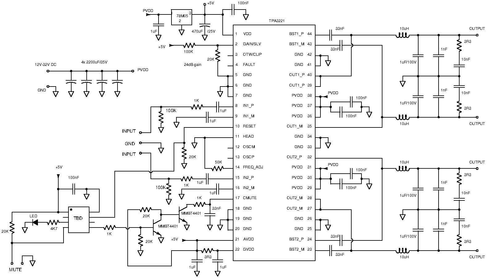

I am currently analyzing the board I mentioned in posting #16. The general amplifier circuit is close to identical to the schematic (Figure 50) recommended by TI in the datasheet. Only some decoupling capacitors are 100nF where TI suggests 1uF. The layout seems sensible. Gain 24dB.
BUT, I am still trying to find my way around in a start-up circuit controlling the /RESET and /CMUTE control pins. The components used for this are several and very small, and the connections difficult to follow. On top, the marking of a SOIC-8 IC has been removed. My first quick test of the board indicated that this circuit did not leave very good results ("loud click").
I will continue my struggle and present a schematic once the circuit is known in full.

My first draft of the TPA3221 board (posting #16) schematic.
The deviation from the TI recommended circuit is the four 100nF capacitors (decoupling) connected to PVDD pins on the TPA3221 IC. TI recommends four 1uF.
Else, the new but perhaps not very successful circuit-part is the start-up circuit with the 8-pin "TBD" (To Be Decided) IC and the two NPN transistors. The "TBD" IC I haven't figured out yet. Bucks bunny helpfully suggested if it could be an 8-pin Attiny micro-controller but that does not fit with the power terminals. My guess is that it is a voltage monitor circuit (watch-dog) used for cheap micro-controller purposes. Of those there are hundreds of versions.
Later I will test the start-up circuit again with different supply voltages and if it still does not perform well, I will try to suggest an improvement.

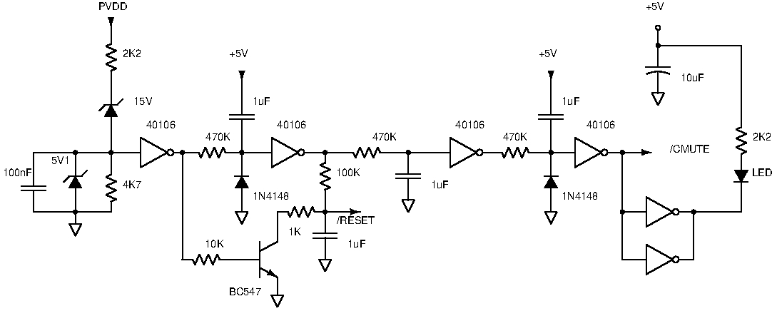

I studied the TPA3221 datasheet and concluded that the following sequence should be followed during start-up:
* Detect the supply voltage (PVDD).
* Turn /RESET high after the supply voltage has reached a safe operating level.
* Use a delay from when /RESET is let high until /CMUTE is also turned high.
I drafted a sequential start-up circuit using a CD40106 inverting Schmitt trigger. The first stage acts as a voltage detector changing state around a supply voltage of around 18V. Following a delay /RESET is pulled high. After a further delay /CMUTE is allowed high.
I like to try this circuit out but for the time being I haven't got time.
Your idea to use an 8-pin ATTINY microcontroller is very good. I would just like to check if the sequence I assume valid is in reality successful.

Today I made a brief test of start-up of the board. Inputs shorted to signal ground through 220 Ohm. 12V/15V/16V/19V/24V and 30V supply voltages. 3-5 start-up sequences for each supply voltage. With 12V supply, no start-up noise. With 15V supply, very little start-up noise. With 16V supply, start-up noise easily detectable. With 19V supply, clear start-up noise. With 24V supply, firm start-up noise. With 30V supply, firm start-up noise.
It is not that the noise will put the speakers at risk or will cause a nervous breakdown for the family dog. My criticism is that the designer(s) has added considerable amounts of components to avoid such noise but has failed. That there is substantially no noise below 15V supply is no solution - who buys a TPA3221 board to run it below 15V supply?
