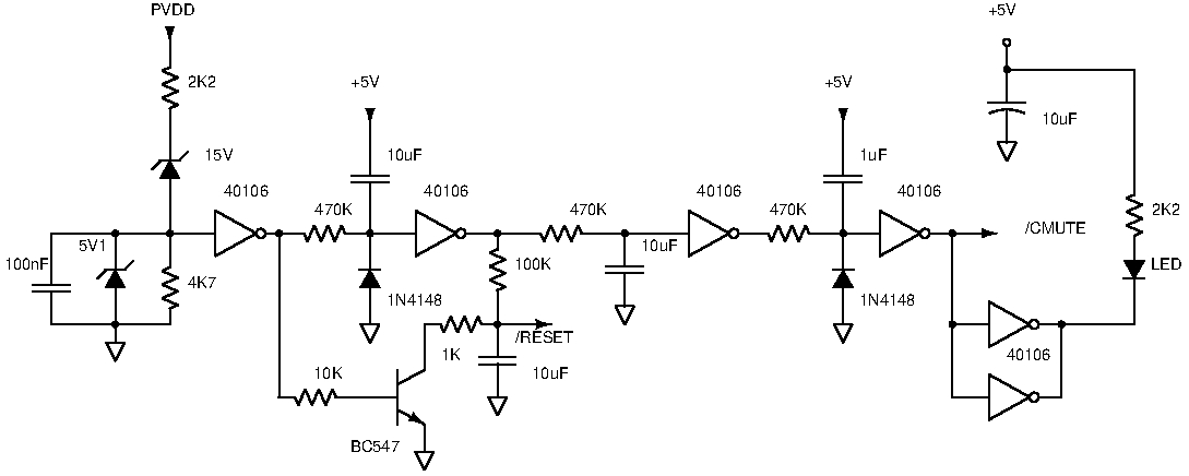

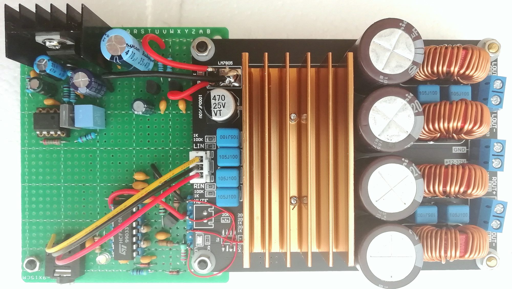

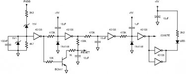

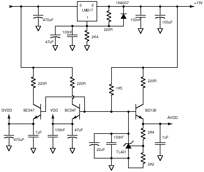

To start with the conclusion – this board is not particularly suited for DIY.
For long I was fighting with a considerable “click” when turning power ON. Only after hours of experiments, I realized that it was one of the SMD micro-transistors that was not well aligned on the PCB and at least one of the pins did not have connection with the corresponding PCB track. With strong reading glasses and the finest soldering tip, I managed to re-solder all transistor pins. Before that, the /RESET and /CMUTE pins were pulled up simultaneously and that caused the “click”. After repair, the /CMUTE pin was pulled high sometime after the /RESET pin. After repair, there was almost no start-up noise.
As I belived the “click” to be caused by poor initial design of the start-up circuit, I implemented my own circuit that starts up above 18.5V supply voltage for the board. Mine worked but the initial circuit may have worked as well, had I found the transistor problem that early.
The board uses SMD components to a large extent. The SMD components used are generally very small and the PBC tracks very fine with only a narrow trench separating a track from the ground plane. Being an economical solution, both analog and digital circuit parts are supplied from the same ordinary 78M05 voltage regulator. Splitting the analog supply pin from digital supply pins was very difficult and required very fine wire.
The board has many good intentions at a reasonable price. The TPA3221 IC, the Nichicon power rail decoupling capacitors, the output filter components, the film capacitors at the input, the heatsink etc. are of good quality. I managed with patience and very fine “wire-wrap”-wire to separate AVDD, GVDD and VDD into three different 5V supplies with better performance than the initial 78M05.
Test was with my homemade ES9023 DAC implemented with double regulated +/-3.5V supply. To my standards, the TPA3221 board sounded really good. The TPA3221 chip is of high quality but the board needs a more DIY friendly layout (size of components and PCB tracks) to be a success for DIY activities.
I have appended schematics for my version of a start-up circuit and my voltage regulator circuits, and a photo of the modified board. I used a 15V LM317 pre-regulator such that I had 15V available should I wish to add input buffer circuits. For that I had foreseen to use OPA1612. In the end I skipped such input buffers.
