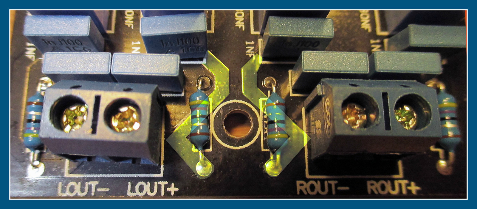

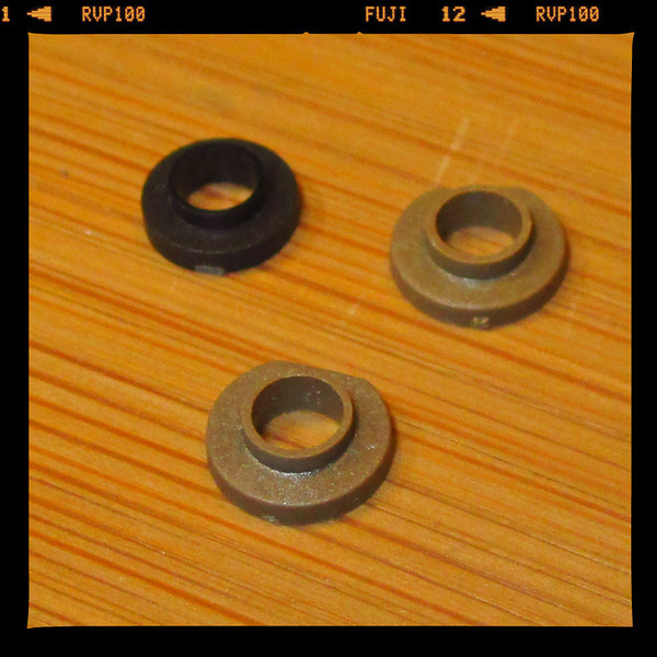

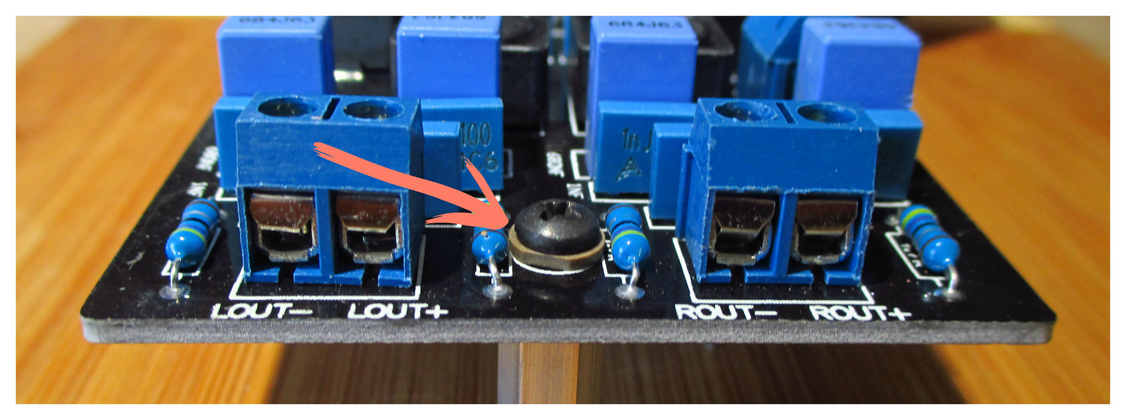

Too bad they have made the third mounting hole very close to the resistors and at the bottom of the PCB a metal standoff can cause the metal chassis to make contact with the GND plane. Since I always use floating audio GND and only the case connected to PE I will have to use plastic standoffs.
I agree. Also, the hole on the board top is very close to the two traces leading to LOUT+ and ROUT-…. so that if the solder mask is compromised, an over-tightened screw with a head big enough could potentially bridge them together or with the ground plane or with the chassis or all of the above.

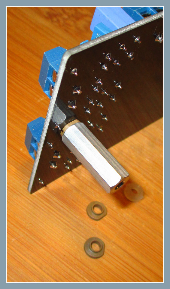

I almost always use little shoulder washers (top and bottom) which isolates the board completely from the aluminum standoffs I use and from anything they are attached to.

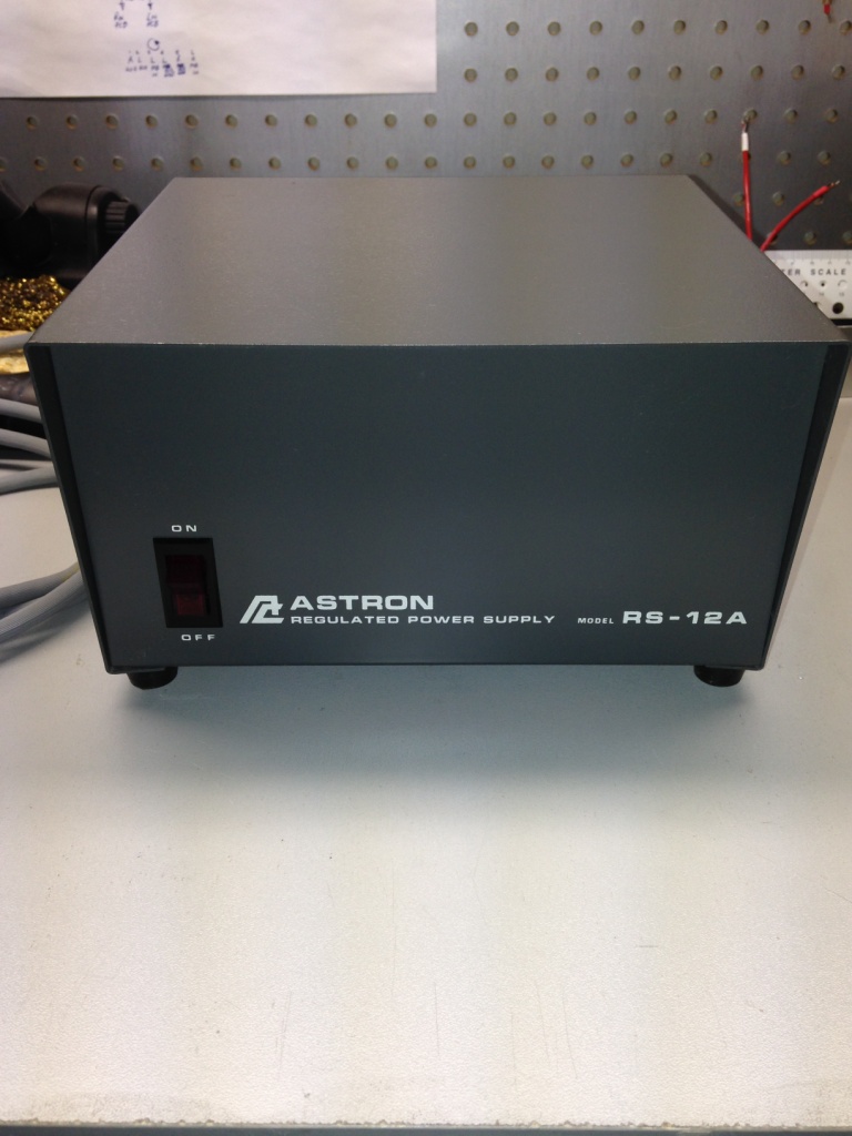

I think these TPA31xx amps like current. I purchased an Astron RS-12A regulated linear power supply for $20 through Craigslist. The unit is in mint condition and I couldn't believe the guy only wanted $20 for it. I got it home and hooked it up to my Yuan Jing 2.0 TPA3116D2 "blue" board and the sound I get from this amp is fantastic.
I'm listening to an RCA Living Stereo SACD of Rimsky-Korsakov's "Scheherazade" and Stravinsky's "Song of the Nightingale" and I very impressed with the large soundstage, solid imaging and improve tonality. I still have yet to explore battery power supplies for this amp, but this Astron power supply has left my SMPS in the dust.

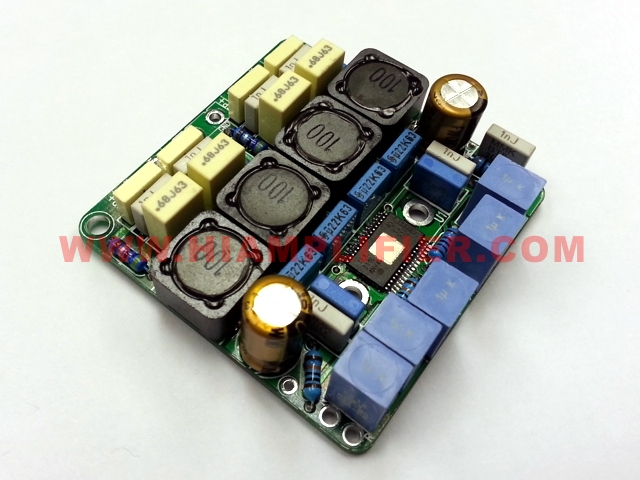

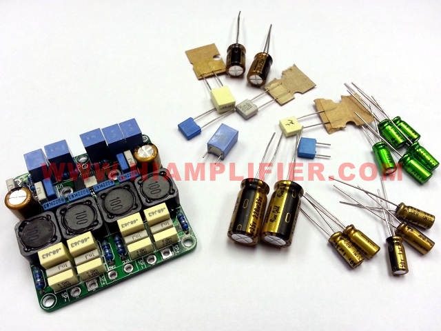

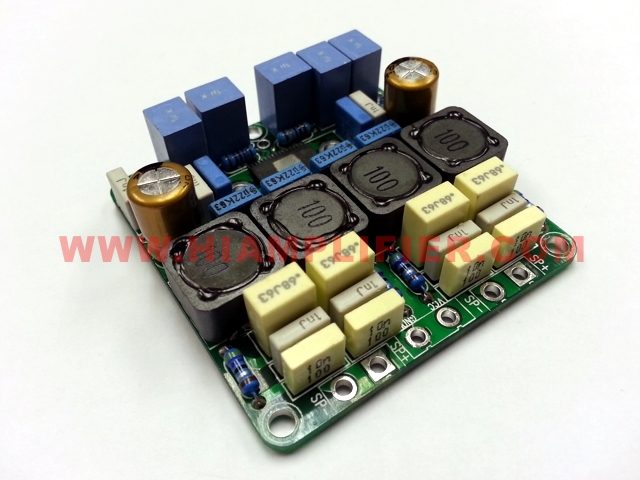

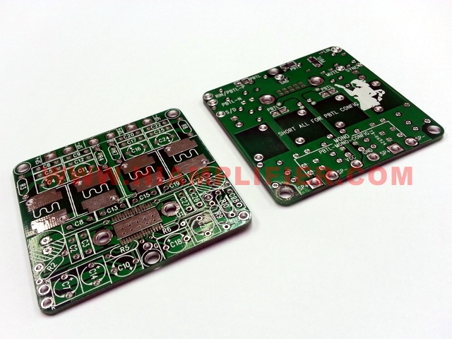

TPA3116 [2.0 / 1.0] Mini Board 50x50mm
Just made the standard version Board with using the AV, EVOX, MKT, Siemens and Nichicon (FW) Capacitors.
Later try to mod with use the Nichicon MUSE ES(BP) 1uF and Fine Gold Cap. (FG) 1uF
TH Parts + S/D PIN + MUTE and Smaller Board Design [ 50 x 50mm ]
Keeping in-used the Shielded Inductors.
Hiamplifier,
Nice looking board there! You managed to squeeze thru hole components into a 50x50 mm PCB. Heat from the inductors and heatsink for the amp may make things a bit warm but probably not a big deal. Are these for sale yet?
Wow, that is a tightly packed board! Nice! How does it sound?
Could you provide more details about the caps you used?
The board looks nice! Looking forward to your prototyping results.
Hiamplifier,
Still waiting for custom heat-sink back.
The temperature condition is acceptable.
Refer Picture 🙂
ES need two per leg, back to back with opposing orientation. And 2.2uf values will be seen as 1.1uf in that config. That's 4 per channel for input.
In single config bass or treble becomes too dominate depending on polarity. That's what I found produced every bit as good as about anything else sound.

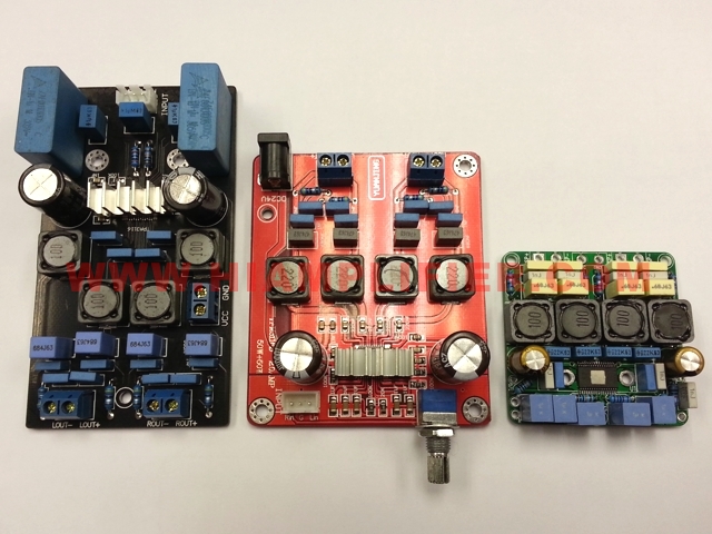

I just realized that the blue YJ board Im thinking of purchasing doesn't have a subwoofer output. Is there a way I can connect a sub to the TPA3116?
I just got 2 boards today and must say that I'm loving the sound of the 3116 better than the the Sure 3120 that I modified or any of the Tripath amps I've used. It sounds really great with a pair of Cornu Spirals.
Most impressive 😀 This is great fun.
Planning to modify the second board in the next few days but I don't know how much better this little guy could get.
Which boards did you get?
Today I put the new YJ blue board into a test / break-in chassis to hear how it does in its stock form. I'm using a Meanwell 6A power supply trimmed to 22V and running a burn-in disc into a 4 Ohm load for a couple of days before I do any real listening or comparisons with the others.
Boards are the red ones from Juan Jjing.
