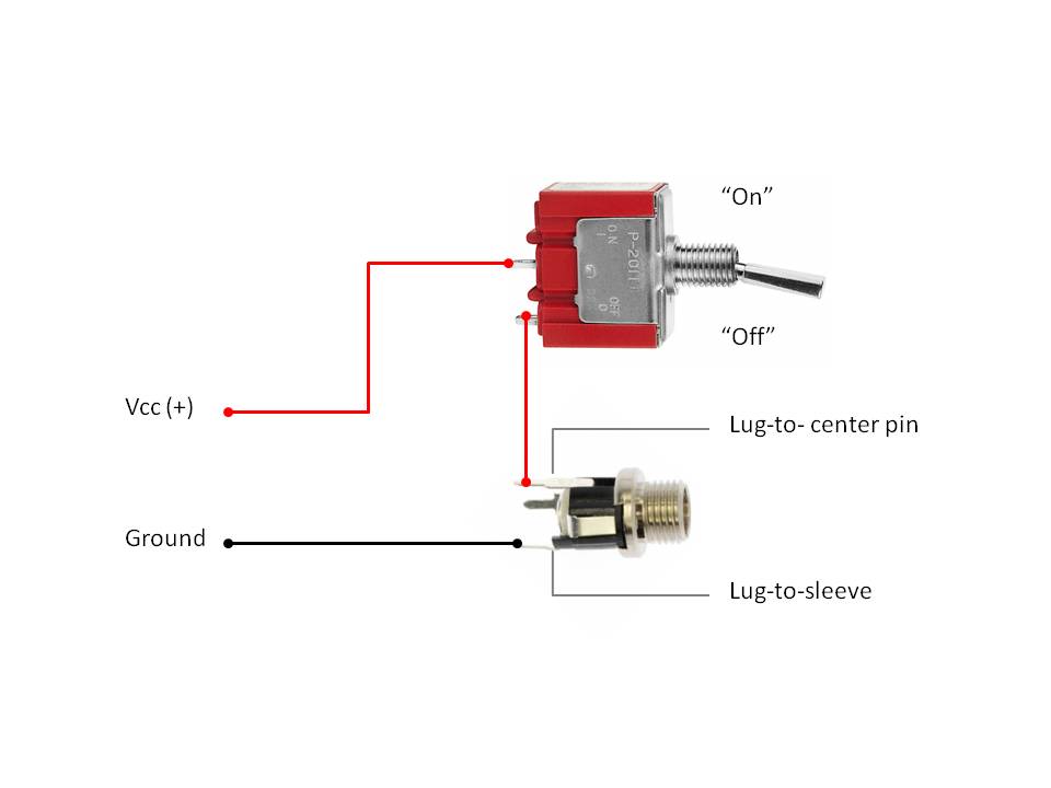

Could someone kindly explain the best way to connect an off board ac connector and switch. I'm afraid I just can't figure it out. 😕
Better switch AC (at the mains side of the power supply) as switching DC will have the switch living shorter. Also one does not want higher DC resistance after a while.
As DC tends to want to keep current flowing opening contacts results in arcing (the current wants to continue and tries to do so via air). Arcing makes pits in the surface of the contacts. Pits in the surface make higher contact resistance and a higher chance for reliability problems.

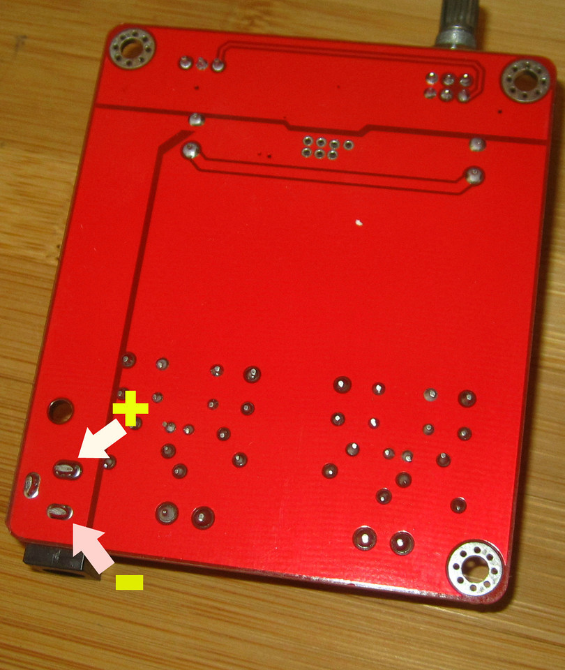

Thanks rhing- The problem I was having was how to connect it to the amp. I tried connecting wires on the bottom side of the on board connector but couldn't figure out which of the 3 contacts to use.
