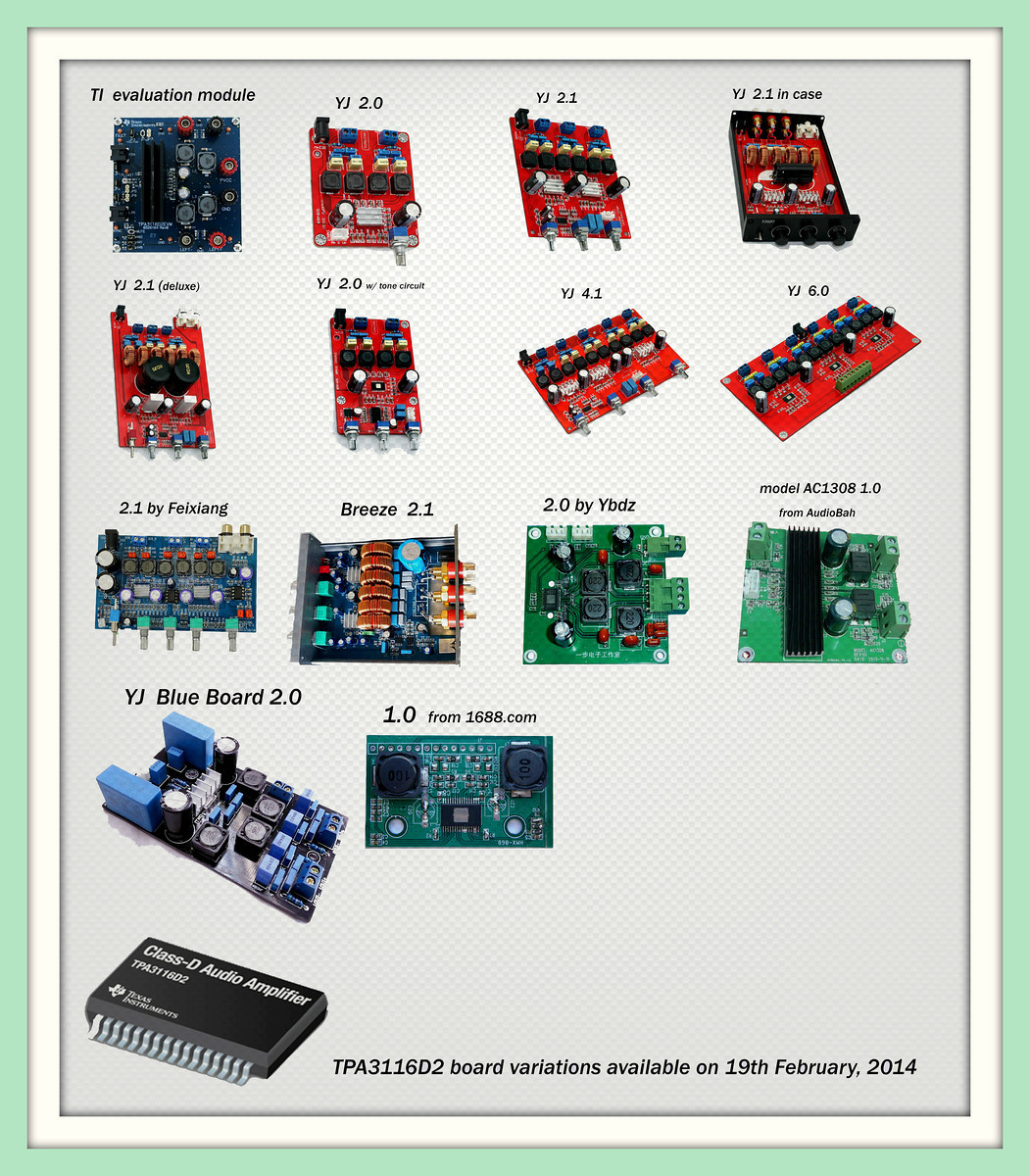

In the meantime, I've been listening to my Yuan Jing 2.0 TPA3116D2 blue board amp. I noticed the two larger blue box input caps were oriented differently. I had mentioned that the right channel input (on the side labeled on the board as left channel) seemed to have a faint buzz/hum. So. I decided to orient that cap in the same direction as the left channel input cap. I noted when I desoldered the right channel input cap, one of the solder joints was a cold joint and the solder had not flowed onto the thru-hole eyelet. After desoldering he cap in the reoriented direction, I connected the amp to my main system. The amp is so quiet now, I wasn't even sure it was on until I played music. The sound is now better balanced between left and right channels and the amp sounds better with no noise.
Maybe first check the circuit and draw it on paper ? It could be an error with the extra circuit or for instance caps that are underrated...
Same thing over here with the YJ blue board. Caps are aligned so that the text is readable. YJ took effort to make the blue version a better version. Most parts are better quality compared to the red board. I guess aligning all caps so the user can read the text is part of that 😉 I was planning to change the cap orientation too. I think I will use MKP/MKC caps instead. Case is ready, PSU is ready but no time this week to finish it.

I do not have problems with turn on thumps. When I powe the amp off, I hear a faint tick through the left channel speaker, but it's nothing to be concerned about.
I have an YJ board that does the same for the left channel and the excursion goes 10mm+ . I have not tried to find the cause as I don't use the YJ boards but if you have a high displacement then you should worry about your tweeters and maybe your woofers.
10mm! Wow. My YJ red boards also thump in the left channel, but nothing like that. I make a practice of turning the volume down before power up and power down.
The new blue board has a very small thump. I'd thought it silent earlier, but I had it running through my Adcom preamp, and it was dead silent. On its own, with a dedicated pot, the new board does seem to have much less of a thump than the old.

As I said in some other post, compared to the 2.1 from YJ, but used as a 2.0 with a 4ohms resistor in the sub out, I like a lot more the little blue one, tested with the same psu and same speakers.I have some of the ChengZhi boards on the way. I hope it's not as bad as they say.
Wich by the way, I believe that this little board its made by feixang as well, as it uses the same components.

A little while ago, I put a post up after receiving my Breeze amp. The soldering was extremely shoddy, power switch wasn't working, the amp was running very hot, even with volume turned right down etc. etc. .
By way of update:
I contacted the vendor who finally responded after considerable delay and then tried to convince me that this was perfectly "normal".
Opened up a dispute with AliExpress and the vendor did not respond within the required 4 day period so AliExpress emailed me and said that I'd be getting a refund.
Just thought I'd let people know if anybody was considering buying this amp. Like with a lot of this stuff from China its 'buyer beware'.
