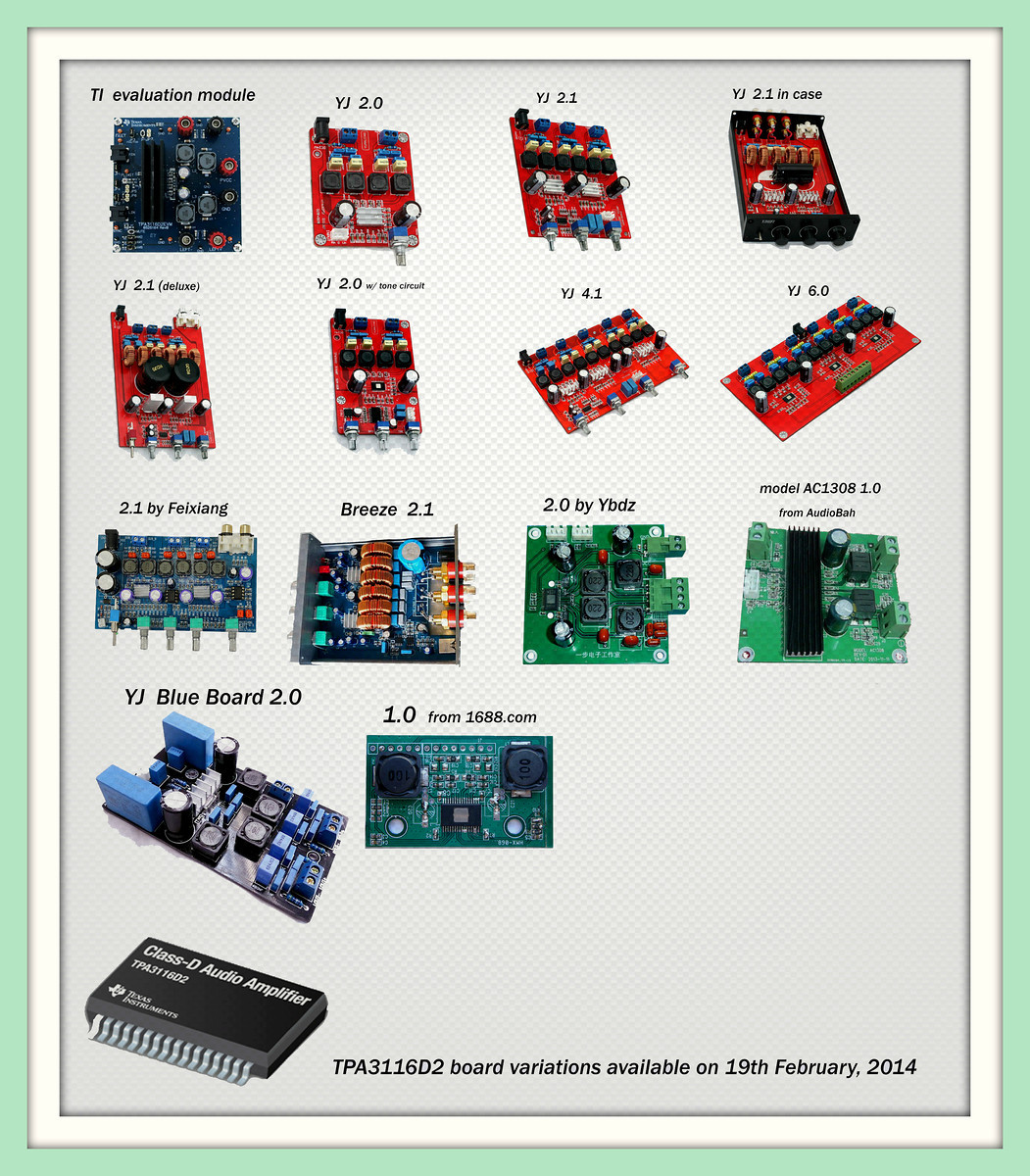

Guys, the 2.0 board from ChengZhi is not available anymore. I got an email that they have withdrawn this board due to quality issues. Frank and honest, that is good. I did not get a reply what the problem exactly is. I was curious what the function of the extra transistors was on this board.
Me too...was shipped to me already or so they said some time ago, now saying post returned the boards to them and offering the Danzz blue YJ board instead...

This is the reply to my question what is wrong with the boards:
Because our board design errors, the boot is likely to cause a short circuit.
So we have stopped selling this product.
Too bad, it looked like a nice version...
Also a nice board but no anti-thump. I still wonder what the function of the extra transistors on the other board was 😉

Regarding the ChengZhi 2.0 board, I got the same message from my Aliexpress seller, "Beauty really.
What sellers did others use?
ChengZhi board removed & 1688.com board added.
Could it be that 1 Aliexpress-seller could not get Chengzhi boards anymore for whatever reason so could not deliver orders he already had, and made a story about it??? The boards are still offered on Ali and on Taobao and probably many other places too....

A person who had been posting on another forum thread regarding the TPA3110/TPA3116 amps sent one to me for free to try out. Frankly, I couldn't figure out what all that extra circuitry up front was all about, so it' stayed in its ESD packaging in my garage workshop. Should I try to power it up and see if it works, or leave it alone?
In the meantime, I've been listening to my Yuan Jing 2.0 TPA3116D2 blue board amp. I noticed the two larger blue box input caps were oriented differently. I had mentioned that the right channel input (on the side labeled on the board as left channel) seemed to have a faint buzz/hum. So. I decided to orient that cap in the same direction as the left channel input cap. I noted when I desoldered the right channel input cap, one of the solder joints was a cold joint and the solder had not flowed onto the thru-hole eyelet. After desoldering he cap in the reoriented direction, I connected the amp to my main system. The amp is so quiet now, I wasn't even sure it was on until I played music. The sound is now better balanced between left and right channels and the amp sounds better with no noise.
