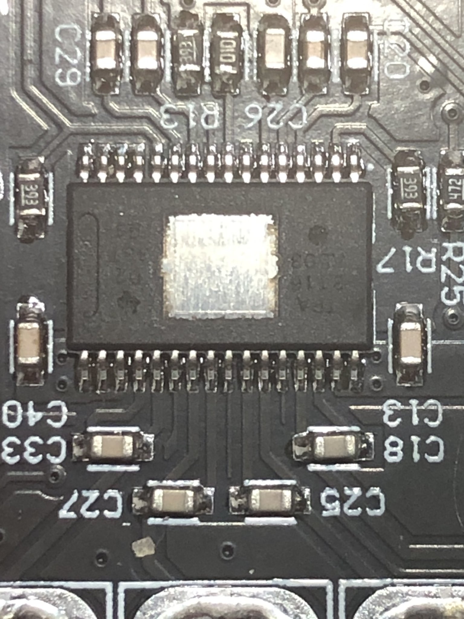

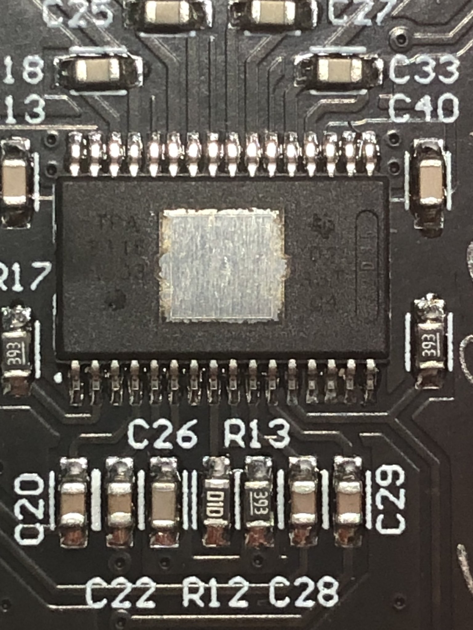

I ended up getting the ZK-502H everything works fine except it has some hiss noise at about +50% volume, per my understanding to fix this I can lower the gain by removing/replacing r1 and/or r2, looks to me they are 39k and 100k but I don’t know which is which and which one should I remove/replace to make it 20db gain thanx
