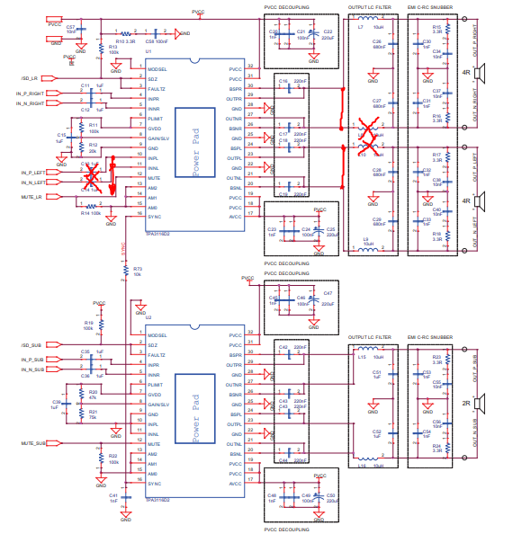

It is as such possible without working on the chip pins. The difference between BTL (stereo) and PBTL (mono) configuration is described in the datasheet, section 7.4.1.
For the jumpers at the output side, you can make these connections at the PCB pads for the filter chokes.
For the input side, you have to work on the small PCB pads for the input coupling capacitors (SMD I believe). The capacitors should be removed and the PCB pads toward the TPA3116 chip connected to GND. This is a bit more delicate but possible.
Thank you so much for the help, cant believe i didnt see that before. I did the mod today and it worked perfectly.
You dont happen to havet any suggestions on my low pass problem?

Also it seems like i spoke too soon about the changes i made to run both in pbtl, i hadnt tried the subwoofer channel since the change until today and noticed that it didnt work at all anymore, just a ticking sound from the speaker. I resoldered the switch and led-indicator to faultfind and it seems like i have some kind of ground problem. When the switch is off the led still shines very slightly and when the switch is on and i unplug the power it still shines for some time.
I dont know if this is related to the changes i made or if i messed up something else in the process but what i did was:
On input i disconnected the 2 1uF capacitors and placed jumpers to ground from the side closest to the chip.
on output i removed the two inductors from outnl and outpl and placed jumpers according to the schematic. I didnt remove any other components or grounded anything else.
