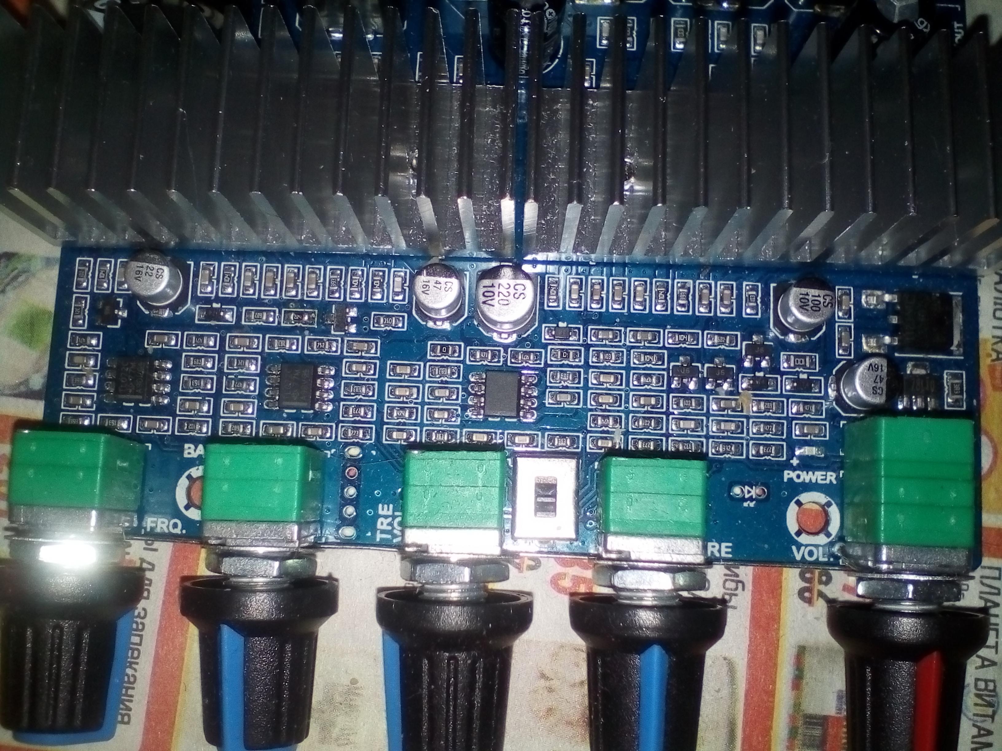

But this cuts satellites from 100 hertz, how to draw from 150-200 hertz. Someone had experience with this? Show me the picture that I need to change to make 150 Hertz?
I have 2 of these boards and they are great. I noticed that the board in your link is missing the full range/ 100hz (?) HP filter switch for the tops.
Where did you find / how do you know that is cuts at 100hz and why would you like to change it? If your tops are not producing much down 150/200hz (like mine) a bit more overlap in the 100-200hz is not a real problem. The 100hz cut keeps the top drivers from reaching xmas for the low frequencies wel enough for most speakers. It would have been nicer if it would have been variable as well; but for the money........... I paid a little less on ebay.
