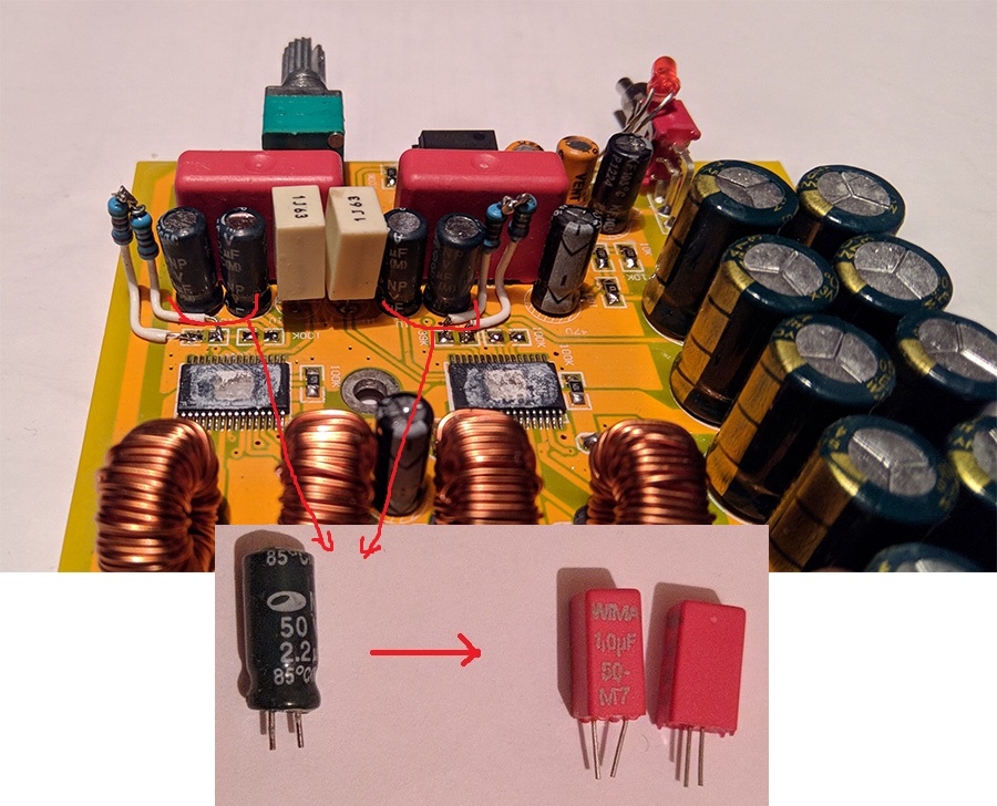

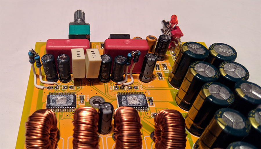

If someone knows how to set gain lower on this board please write.
See http://www.ti.com/product/TPA3116D2/datasheet/detailed-description#SLOS7085962, section 7.3.1.
If I am interpreting your board photo in post #10245 correctly, the gain setting resistors are 100k and 47k, a combination which does not exist in the datasheet. If there were actually 39k resistors in the positions so marked on the board, it would be configured for 32db gain, but the assembler put "473" resistors there. You might try removing the 473s and putting 20k resistors in their place, to give you 26 dB gain. Most of the guys I have seen complaining about hiss etc. with these TPA3116D2 boards seem happier with lower gain settings.
I would highly recommend waiting for someone to confirm the above before you make any actual changes.
Thank you for your advise, I've made mod to set gain to 20dB:
Remove 100k resistors, and 39k replace with 5.6k.
Now hiss noise very low! Looks like manufacturer should made it by default.

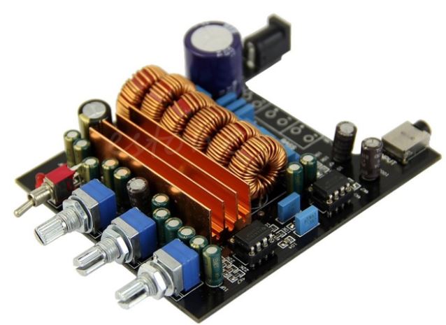

Which is the best 2.1 pcb board, whit separate connection for subwoofer and the satellites? If only a few modifications are needed, it is still acceptable.
I would like to use my crossover and equalizer.
That is not going to work as 2.1 boards have only left and right inputs and a crossover onboard.
You can use 2 separate amps; 1 for left&right and 1 for your sub(s).

Which one of the those amp boards you have you think is better?
TPA3116 2.1 board
In found this 2.1 board that looks nice to me: good inductors and capacitors I think. I consider to use two of these board for a 3 way active system (one board per side). With this appliance there is a big difference between left and right channel (tweeter and woofer). Is this a problem for this kind of amplifier? Besides I am uncertain about the input. This is a jack for three channels?
2.1 amplifiers usually have 2 full range channels (left and right) and one low pass channel, so it probably won't work well in your project. The LPF might be adjustable but I'm guessing you don't need it if you have separate cross-overs. And the input is basic 2 channel stereo input, no magic there.
I'm not sure about this. New TPA3116 2.1 Digital Amplifier Board Class D 3 Channel DC18V 24V 2*50W+100W Free Shipping 12003203 in New TPA3116 2.1 Digital Amplifier Board Class D 3 Channel DC18V-24V 2*50W+100W Free Shipping 12003203 van Versterker op AliExpress.com | Alibaba Groep
Potentiometer Functions:
Bass Volume
Left&Right Channel Volume
Main Volume
I don't read anything about a bass filter in the specifications. But I asked the supplier.
