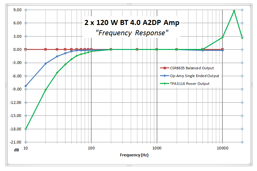

Re-messure and let ut know, I´m interested to know myself.
Well, you were right. The CSR8635's equalizer is not being used.
In the attached FR graph, the CSR's output is a dead straight line from 10 Hz to 20K Hz. The balanced to single ended conversion creates a 1st order HP with an Fc = 20 Hz at the inputs to the op-amp. That makes sense as the inputs use 20K resistors assuming 0.39 uF caps. Then there is another 6 dB loss at the TPA3116's power output - likely due to another HP created by DC decoupling caps and the TPA's input impedance.

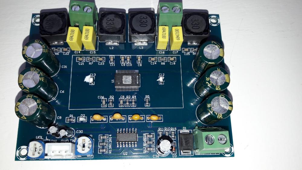

As annotated on a stock pic, one of the caps on the balance/single ended conversion is not the same size as the other three (CN Quality). I measured on the side with same size caps. Up past 10K Hz, there is a jump in dB only at the power output. Not sure what causes it. I saw it on a DVM and the O-scope.
All in all, easier for most to increase the cap sizes to reduce the HP issues than reprogram the CSR's equalizer.
