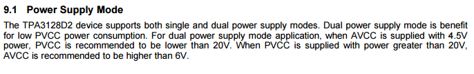

I can't find this statement in the datasheet compared to the TPA3118. Can you point me in the right direction? Are you refering to "9.1 Power Supply Mode"? This is also valid for the 3118, as the internal LDO structure isn't changed.
If its also valid for the 3118 why isn't it explicitly stated? When I introduced my AVCC RC decoupling mod the pushback (including I think from TI themselves) was that AVCC and PVCC could not be substantially different voltages. But now for the first time we have it in writing that they can be hugely different.

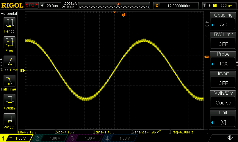

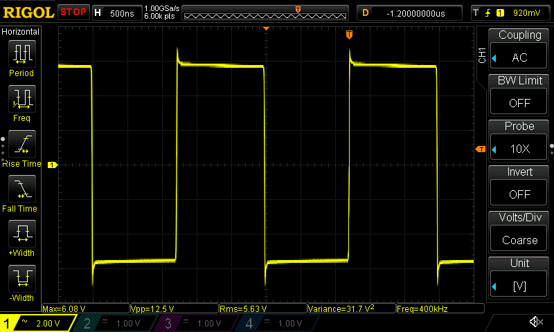

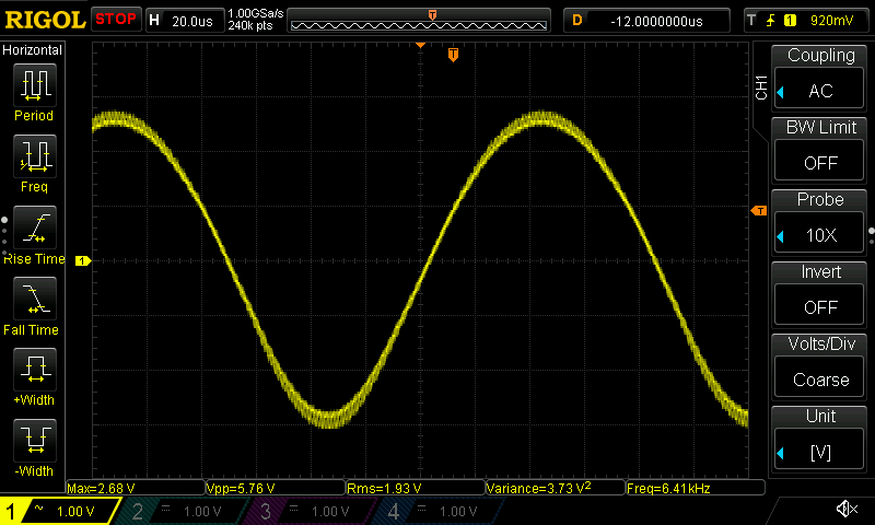

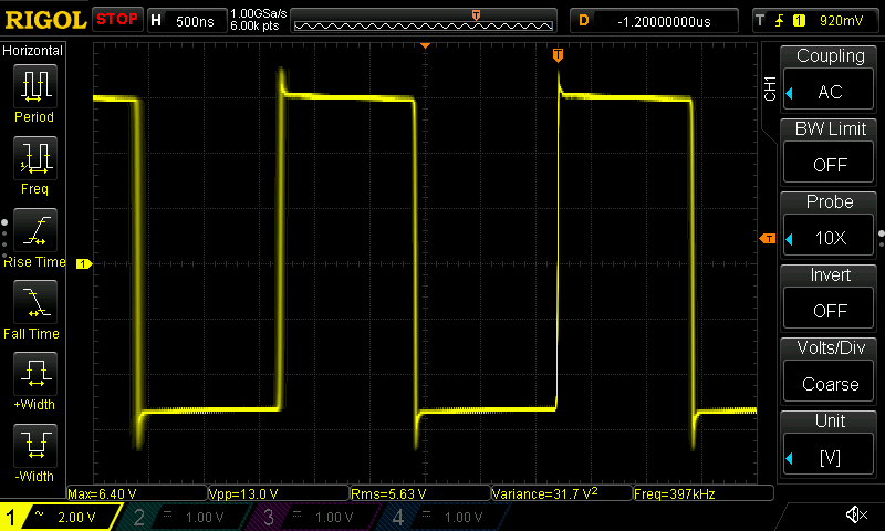

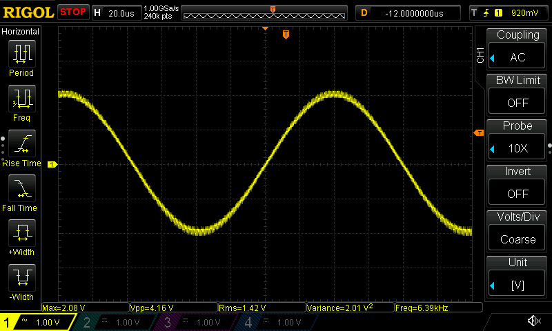

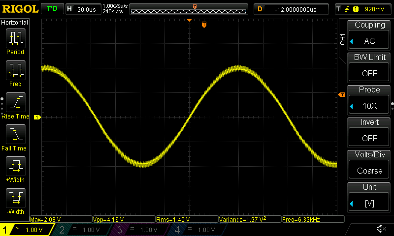

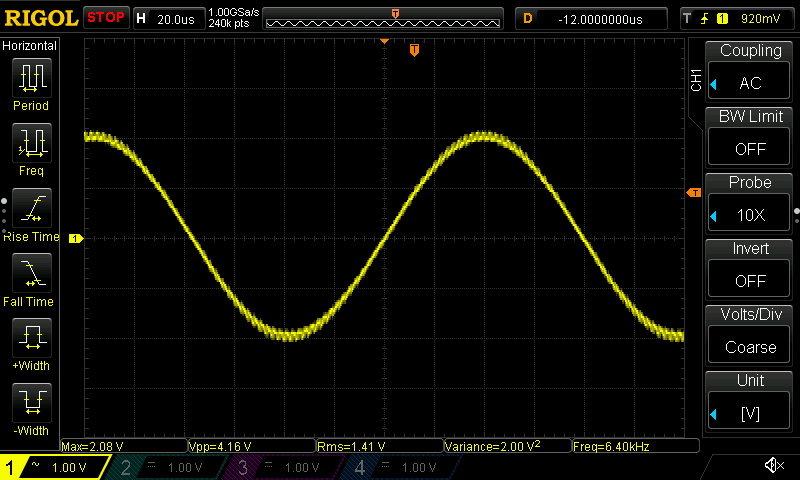

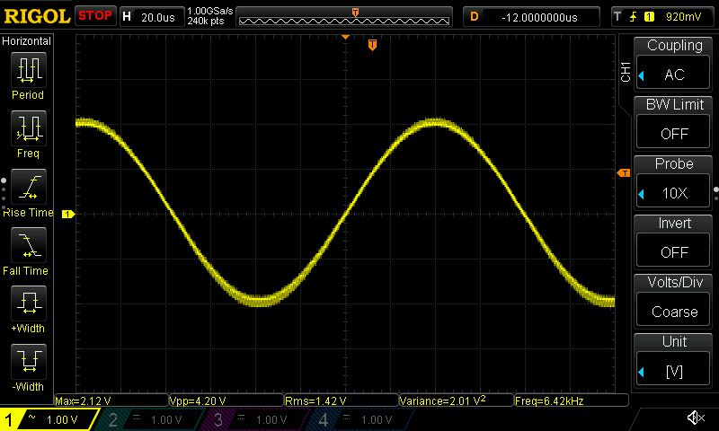

I tooked one of these Sanwu TPA3118 PBTL boards to test. (Thanks to irribeo)
PVCC: 11.7V from 3s Li-Ion
AVCC: Linear power supply Korad KA3050D (locally decoupled with 100n X7R at the AVCC pin)
Output power: 0.5W into 4R (1.41Vrms)
Unmodified PVCC+AVCC locally tied together:
Modified as noted:
AVCC 11.7V:
AVCC 10.0V:
AVCC 7.3V:
AVCC 6.0V:
AVCC: 4.3V:
Below 7.3V the gain starts to rise so does the output amplitude. From ~5.5V and below the IC sometimes needs some time to "resyncronise" the switching. Once stable, it runs stable. Below 4.3V the 3118 stops switching.
The midrail supply voltage (audio input) varies with AVCC voltage:
11.7V -> 3.1V
7.3V -> 4.6V
4.3V -> 3.0V
Below 7.3V the static noise increases, so does the gain. I would say, this is directly related to each other.
One thing i find strange is, the voltage at pin GVDD doesn't change over the full range of AVCC variation. Between 11.7V - 4.3V AVCC voltage, GVDD stays at 7.14V.
Beside the increase of idle-noise (static) due to gain variation i can't see nor hear a problem with excessive noise or distortion. So to me, 3118 and 3128 are acting the same at this.
