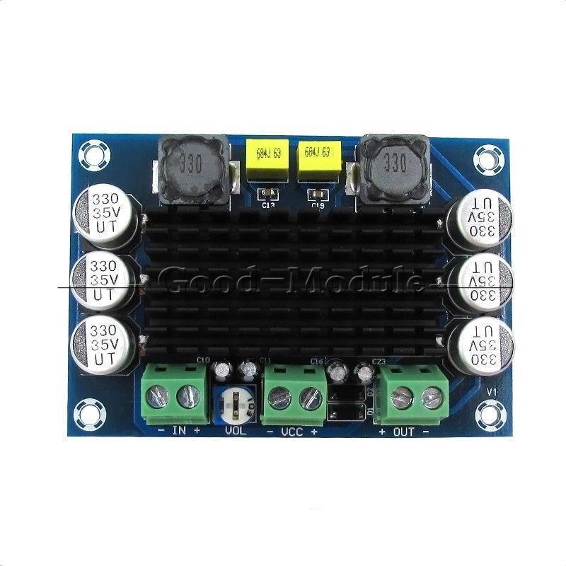

After a while, I took a search on ebay and found some new tpa3116 mono boards I have never seen before. Any info about this board? which is $5 dollar, has nice heatsink and a huge capacitor
I got four of these to run a set of actively crossed line arrays with 2x12" subwoofers for the bottom end. The subs were 2 ohms when paralleled, so these boards were among the only ones that would have worked at all.
They sound okay. These replaced a LM4766 with a linear supply and have at least as much output. Sound quality is not a priority or an expectation (for me personally) when using Class D, but they're cheap, rugged and run very cool. The single supply voltage also makes powering them quite easy.
That 'huge' capacitor is mounted on a little plastic separator, which is not properly attached and rattles like mad. I had to desolder the caps, remove the offending appendage and decided to put in some better units anyway.
Also, it needs a balanced signal to reach full output but even with the negative input grounded, there's plenty of gain from a little Chinese BT/MP3 player and an active crossover. The array sensitivity being above 95dB/w also helps. I bought them when they were about $6.50 each, and was satisfied given my low expectations and non-critical application.

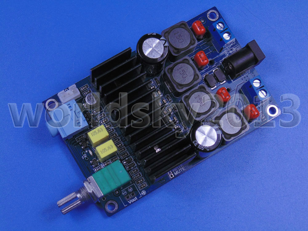

Hi guys, I just recently bought this board: New TPA3116 DC12-24V 50W+50W Dual-Channel Audio Speaker Digital Amplifier Board | eBay and if understood right it should be one of the better ones. I am going to change that pot to 10k stereo logarithmic as suggested here.

There seems to be a price error in that eBay link. Price should be somewhere in $7.5 to $12 range for a board like that.
That board appears to have 15uH output inductors and 0.68uF output capacitors, so it should work quite well with the 4-ohm Epos ESL-3 speakers.
Not sure about the PSU you linked to. Amazon page does not even specify the output voltage. You should get a 24V 5A power adapter for that board.

Thanks for your input, i checked that ebay link and smiled a little, i can assure you i didnt pay 200$ for this board. I paid aroud 18$ which was still a bit overpriced but as it was last one and a friend of mine recommended it I just went and paid few $ extra.There seems to be a price error in that eBay link. Price should be somewhere in $7.5 to $12 range for a board like that.

This psu I have is a "smart charger" as it changes the output voltage depending on which type of charging tip is attached. I went and checked it with multimeter and with this tip attached it gives little over 19V and 3,3A. However i have small apartment and i dont need those speakers to get super loud at the moment so this psu will do its job. I assume only downside of lower power psu is that it limits amps power output as well?
