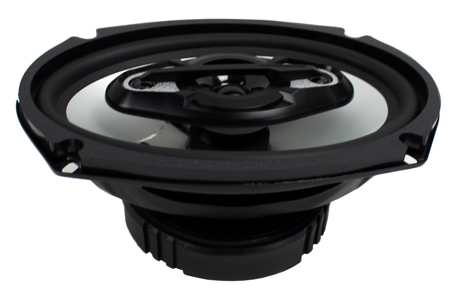

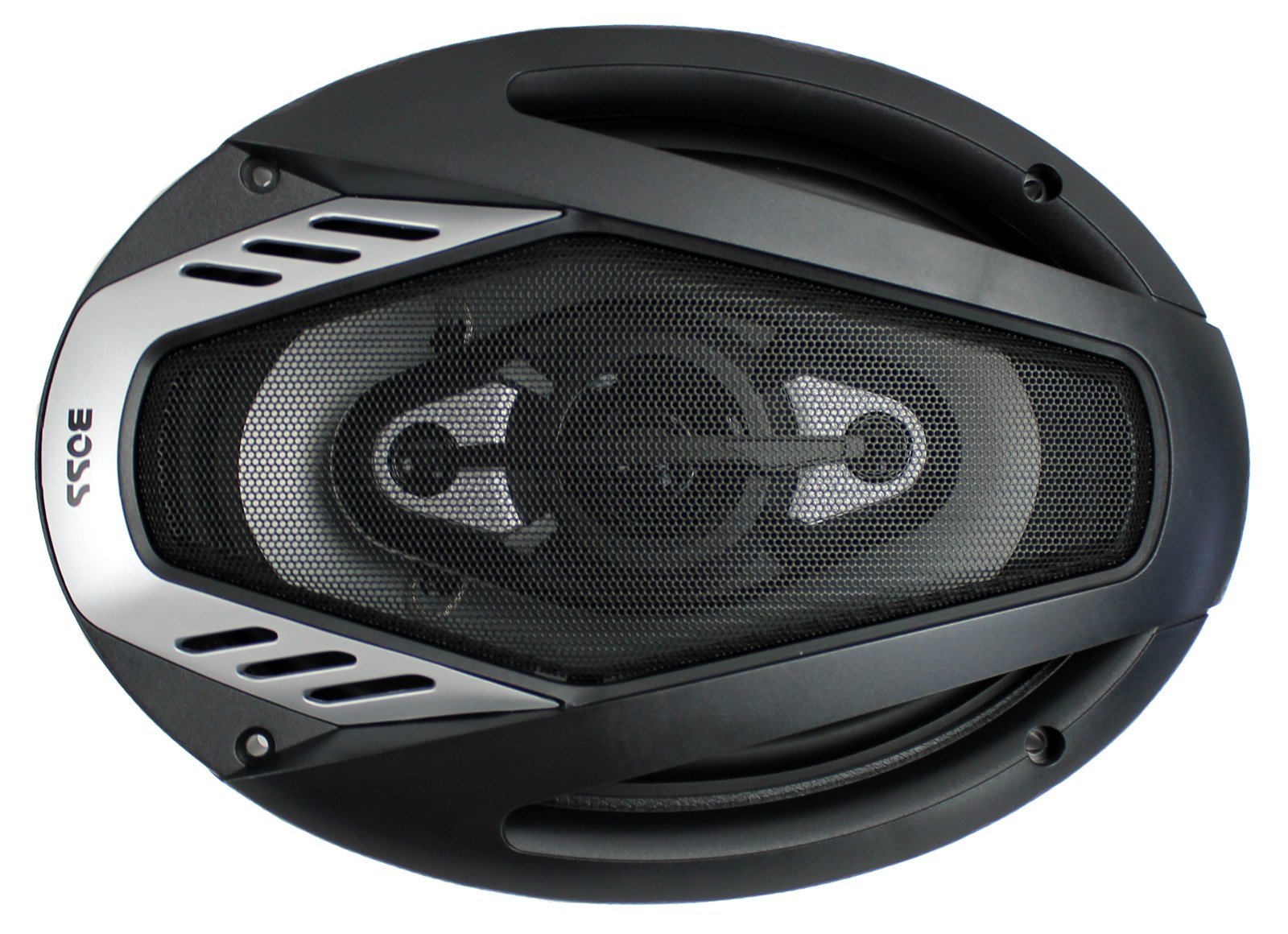

Hi guys, I need to calculate a power supply for a tpa3116
I will feed the circuit with 24V, and the speaker is going to be a 4ohm 6x9 speaker. According to the datasheet figures, I can drain around 70-85 watts with 24V and 4ohm load. Is it correct to say that if the amp will consume around 80 watts, then I should go fine with a 100W power supply? How many amps would be suitable for my app? I am thinking about 4A, 0.2A for the player and some leds. Will that be more than enough? The 6x9 speaker seems to be quite powerful, big magnet and 1.5" voice coil, so I am expecting it to throw some good bass once mounted in the proper enclosure. I am starting to like the 6x9 speakers for boom boxes, you have everything in one of them, good bass 45hz, good mids, and they come with nice tweeters, which I think is more than enough for a discrete medium size boom box.

I simply will mount the 6x9 on a big enough enclosure (1 cubic foot) and then will try different 2.5" diameter pvc tube lengths and evaluate what length is the best for it, I need to do this because these speakers never come with TS parameters.
Take a look at this speaker ($35 pair):

I first wanted to buy a pair from pyle ($30), but then realized pyles voice coil were smaller than that boss speaker, that boss is 1.5" voice coil, so it will perform better and handle more power. They come in pairs, and I first will use only one for a compact mono box (1 cubic foot), I have this little worm in my head telling me to give it a try.
