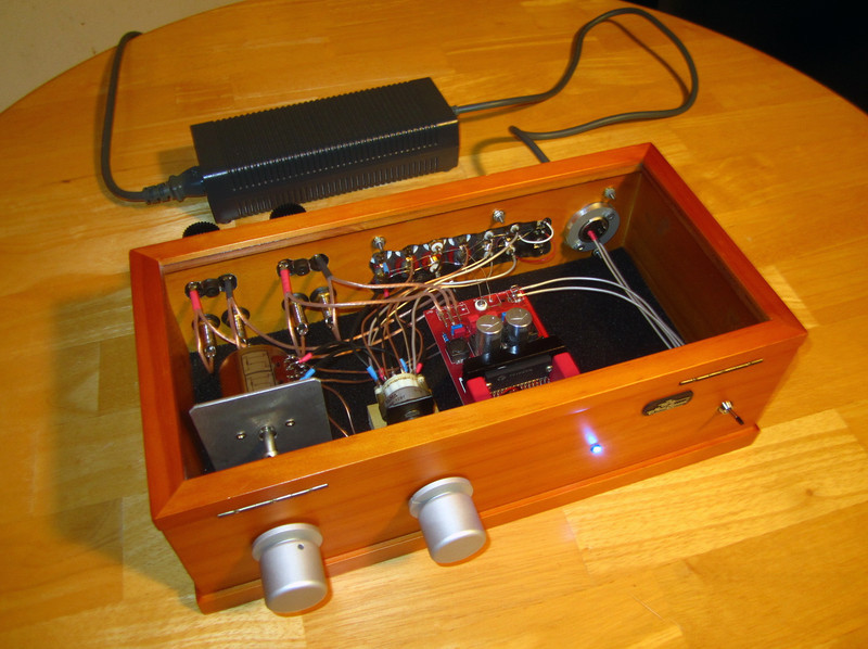

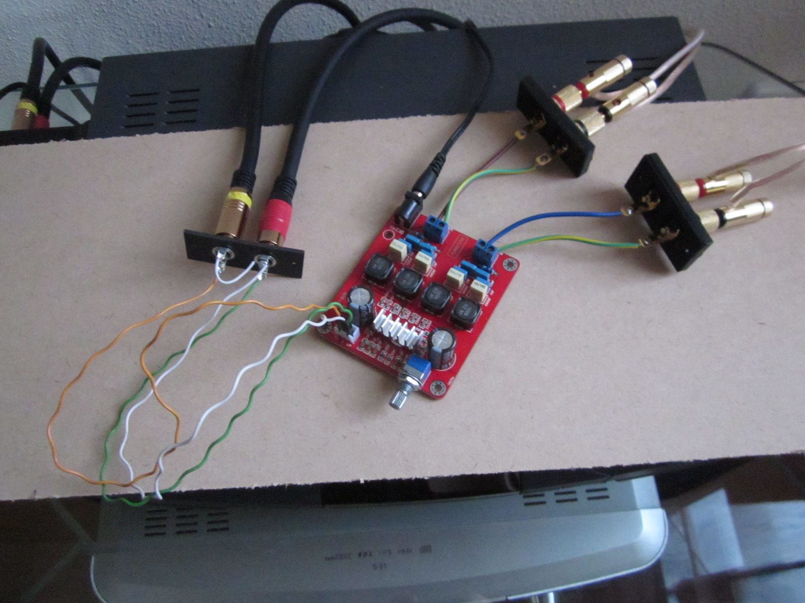

I did replace the input header with one that I had both parts of .
pics....
http://photos.smugmug.com/photos/i-SWqCSgs/1/X2/i-SWqCSgs-XL.jpg
http://photos.smugmug.com/photos/i-nFLvcN2/1/X2/i-nFLvcN2-X2.jpg
http://photos.smugmug.com/photos/i-HgZZ4LN/0/XL/i-HgZZ4LN-XL.jpg
http://photos.smugmug.com/photos/i-N86mNdT/1/X2/i-N86mNdT-XL.jpg
Mine arrived too.
Couldn't wait too hook it up.
I kept the input header "as-is" because I couldn't find the matching plug or anything to replace it with. I did cut some connectors from an old PC that's ready for the trash and used those.

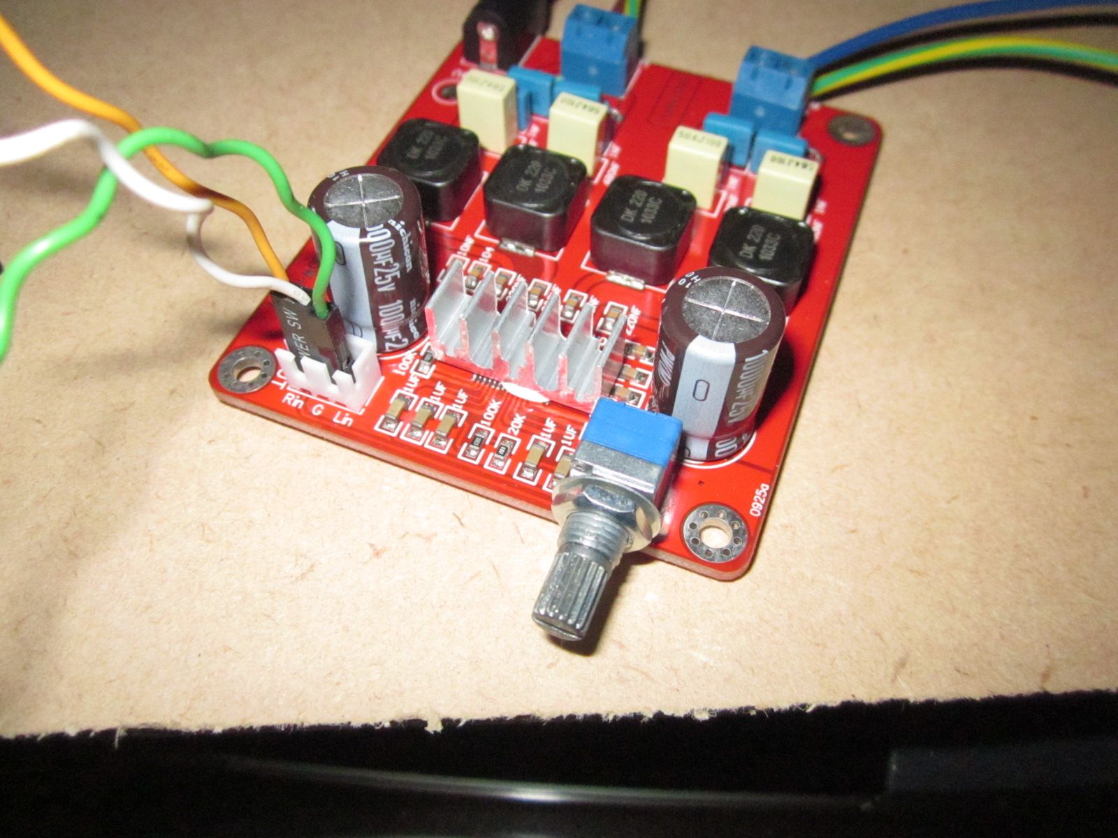

The board looks well made and the input caps are Nichicon.

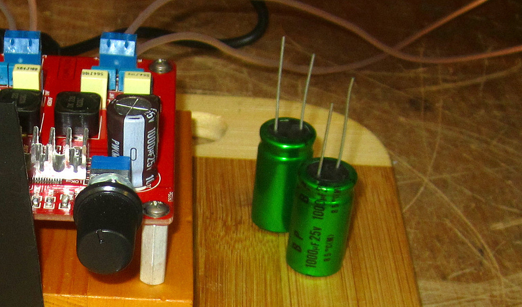

What value are those caps?

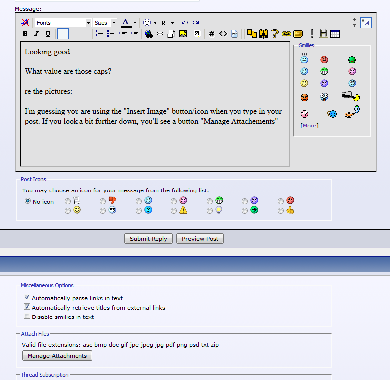

re the pictures:
I'm guessing you are using the "Insert Image" button/icon when you type in your post. If you look a bit further down, you'll see a button "Manage Attachements".
If you use that to upload your pictures, you'll get the expanadable thumbnails.

Cool, thanks for the photo posting tips.... The caps are 1000/25V Muse bipolars.

I think that improving the array of film caps that are on this board might prove a worthy endeavor and a small bypass across the DC input always seems to change the sound, we'll see. I also need to try a different power supply. At the moment I'm using a 20V 4.5A but I'd like to try a 24 volter too. Sure is fun messing with these.

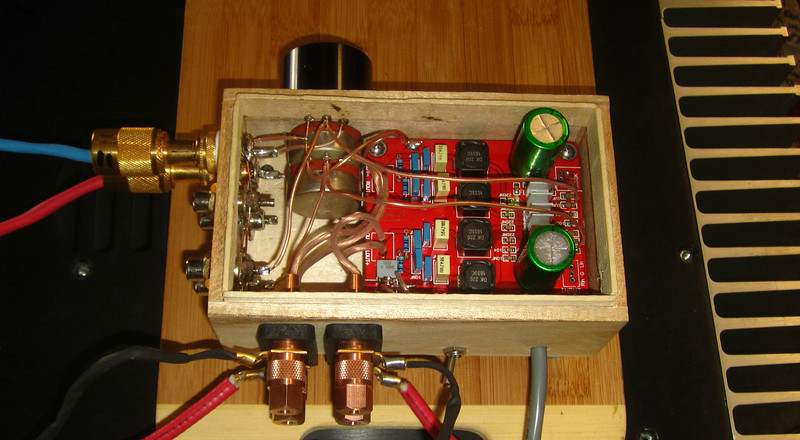

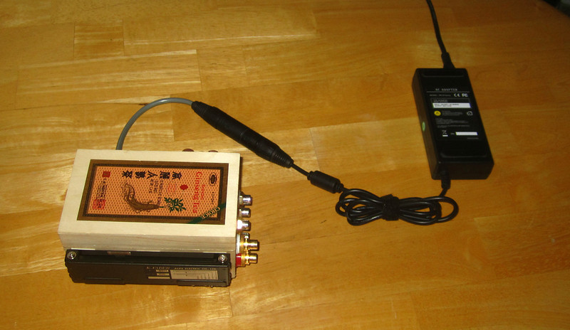

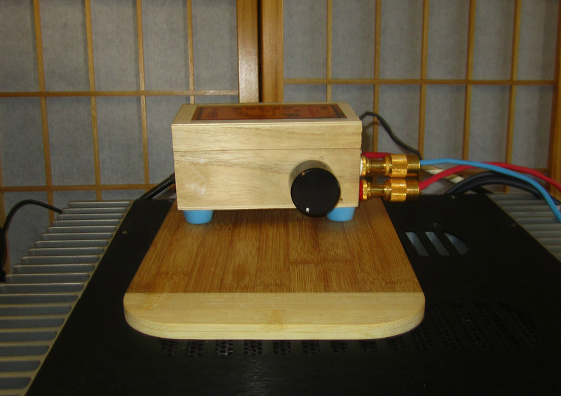

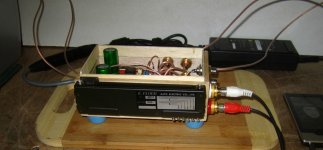

This afternoon I took some time and mounted it in a little wood tea box (anything becomes a project box these days) with some good wire and hardware and an Alps K-slider and it's really doing a terrific job. It has a coherent sound with very nice bass response and imaging. It's driving the 802s a lot better today too but it really shines with the smaller Signets.
Click Here for a few more pics from today...

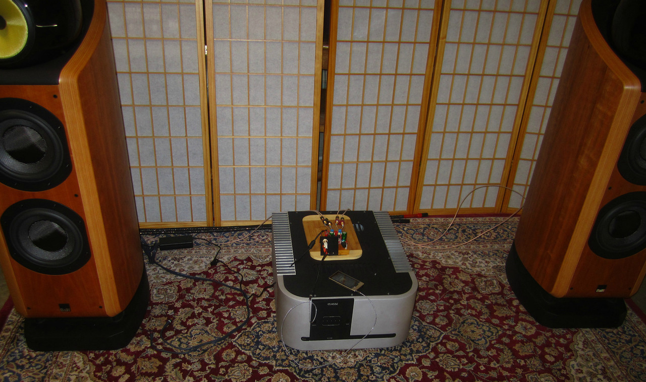

Once I get around putting it into a "proper" case, I might use one of these 24V 5A SMPS:

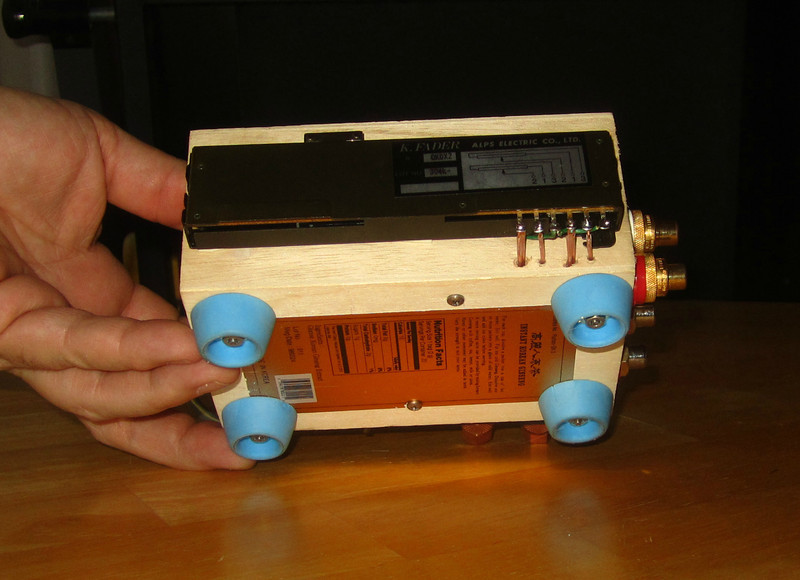

I found it in my kitchen pantry. It’s a lightweight wooden box that some Ginseng tea was packaged in.
When I saw that the inner dimensions fit the pcb quite well and my Alps K-Fader fit perfectly across the long side, I just had to use it. 🙂

Thanks! It's a simple tea box.
The extra input pair of RCAs (the middle pair) will be added as a second set of inputs after I'm done with listening tests and part swapping.
The third pair is an output for an active subwoofer.
I've used three volume controls, a 10K, 25K and a 50K... all worked and sounded excellent.
The only thing about the pot wiring to note is that the output of the pot goes directly to the input C for each channel. That surface mount part will eventually be changed to something better sounding.

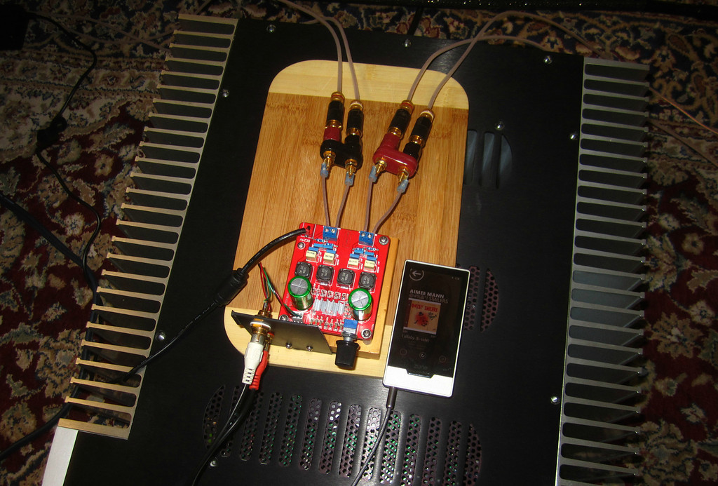

The heatsinks on the amp it's sitting atop are dissipating the heat generated from up to 500W per side. It's already hot in my workshop and doesn't get turned on much. The little TPA3116 is on anytime I'm working.
