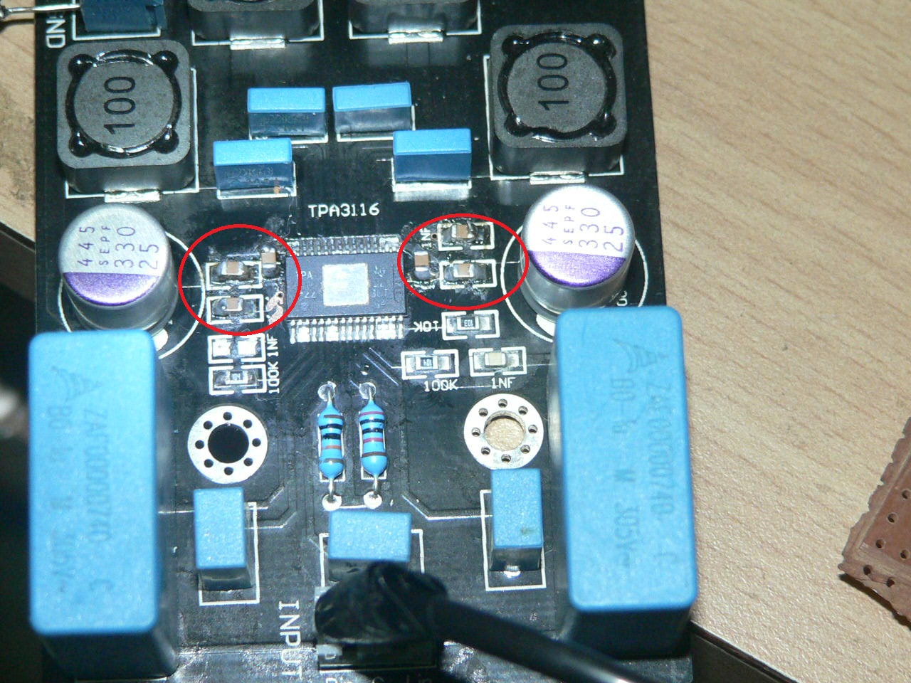

For example I did like this:
DSCF3028_zpsma7tkabl.jpg Photo by snake69fast | Photobucket
I didn't remove the 1nF's or 10nF either
white smd=cog=100nF
yellow smd=classII XR=10uF(~5 or 6uF with voltage applied) but maybe 6uF will do fine too, TI used 0.1&1&22uF with some TAS chip, Wiener GB has another set of values

Can't be sure because of picture scale, but the boards I got have the smd a bit more symmetrically in-line with chip, and "look" slightly closer. In any case I don't think I could do that in that spot.
If the mod you show is done, is it vital to leave the original 10nf still in place?
I see that a small trace comes out under IC to it, presumably IC GND. But it also does at the 100nf at opposite end.

Anyhow. As I have switched 1nf, gonna have a go at switching the 10nf and 1nf around on the power input side to match other, and the order on datasheets i.e 1nf closest to pvcc pins.
As I'll be moving 10nf down the order I'll have a think about a second 10nf across pvcc/GND elsewhere before.
It does look like there's 2 small traces coming out from under IC from it GND pad to both the 10nf and 1nf on that side.

Just read an old Creek audio piece on bypassing with Crescendo caps.... What struck me was the word "cascading" the bypass caps. It pointed out that my boards 1nf and 100nf smd pvcc bypass caps are not optimum.
I redrew the circuit, the nearest cap is paralleled with main power electrolytic, the second in the chain is in series with the first, which sort of parallels the power cap, but creates a small loop in circuit. And what's the point of two caps in series to bypass, especially with larger cap after smaller cap?
To put in another way.... If I redraw the existing circuit with the bypass traces overplayed with electrolytic circuit traces, the 2 smd bypass caps form a X (cross) over each other.
Wouldn't it be better to bridge the + of middle smd next to IC across to trace between power electrolytic and first bypass cap nearest first pvcc pins? This would put all 3 in parallel, remove the loop, and create a proper "cascading" high frequency bypass!
Am I along the right lines? Advice!

just took couple of pics to illustrate my post.
the first pic shows drawing of the board circuit as is.
the second pic shows two drawings....
The top drawing is the board circuit redrawn to show how the how the 2 smd bypass caps "X" (cross) each other, i.e the closest cap attached to the "+" pvcc trace returns to ground furthest away, and the furthest cap attached to pvcc "+" trace returns to ground nearest......surely this isnt optimum?
The Bottom drawing is my solution to the circuit loop created. By placing the 1nf nearest pvcc, and 100nf nearest electrolytic on poisitve traces and vice versa on negative return trace, it corrects a "cascading" bypass.

YJblue has stargnd at (under) 3116, your version too I thought you said, or did you mention already that layout pvcc/gnd for smd caps is reversed on your pcb ?

I mentioned creek and the article to note the source of why I looked at this. I am not suggesting to copy their designs, but it did make sense looking at my board, and the 3116 schematic.
I think mine must have the star ground as no traces go from any IC gnd's, but as that isnt on data sheet schematics I don't really know much about that part of circuit, and definately not going to lift IC. But there is a trace coming out from under IC to the "bypass caps" positive trace, and returns to electrolytic negative on the 1nf/100nf side of board.
The drawings I posted are based on my board circuit and the 3116 schematic, the creek article had no drawings. The fact that the 1nf positive side is nearer to pvcc input than 100nf yet the opposite on return to electrolytic negative trace on board forms a "loop" in the circuit, and means both the 1nf and100nf does and doesn't bypass the electrolytic < that's difficult to explain, apart from the trace going from under IC to electrolytic. I also don't see any traces from the 100nf to under the IC.
