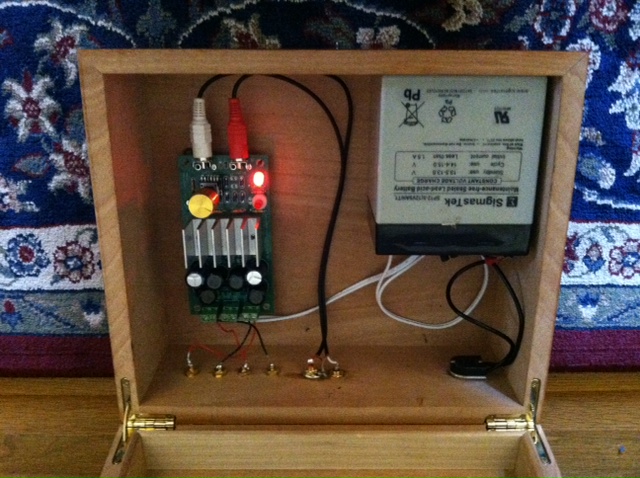

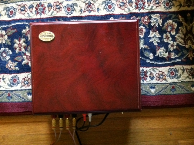

I just finished Jerry's kit for a portable/battery powered system. The shipping was lightening fast and went together in 2 hours (I have to take my time since I am color blind and had to double check everything with my wife). I was going to do the snubber mod right away since I had the parts but wanted to evaluate it in stock form first. I chose 32db for the gain since I will be often using an iPod/iPad as a source. The battery is a 12v 5a SLA.
This is a very nice sounding amp. It has the nice detail, great bass, and that slightly forward mid range sound of the TPA3116D2 that we have come to love. I don't detect any graininess in the female voice that I've heard in the stock YJ Black/Blue and Red boards (I am listening to an SACD of Diana Krall right now). It is pretty smooth in the upper registers. It is a bit more holographic too, maybe even more so than my modded Danzz board with Oscon caps, snubber mod, Bourns inductors, and Astron PS. But the latter amp is more transparent and has punchier bass. I also have the SMSL SA-36A Pro, which, even with Oscon caps, sounds much too bright for my tastes. An added bonus is that there is no turn on pop; it's dead quiet. At power down, there is a faint thud. Also, with a source connected and the volume at full, I hear no hiss! Sweet! So right now I would rank this amp just behind my modded Danzz board. For $50 (with parts and humidor included) this amp has exceeded my expectations.

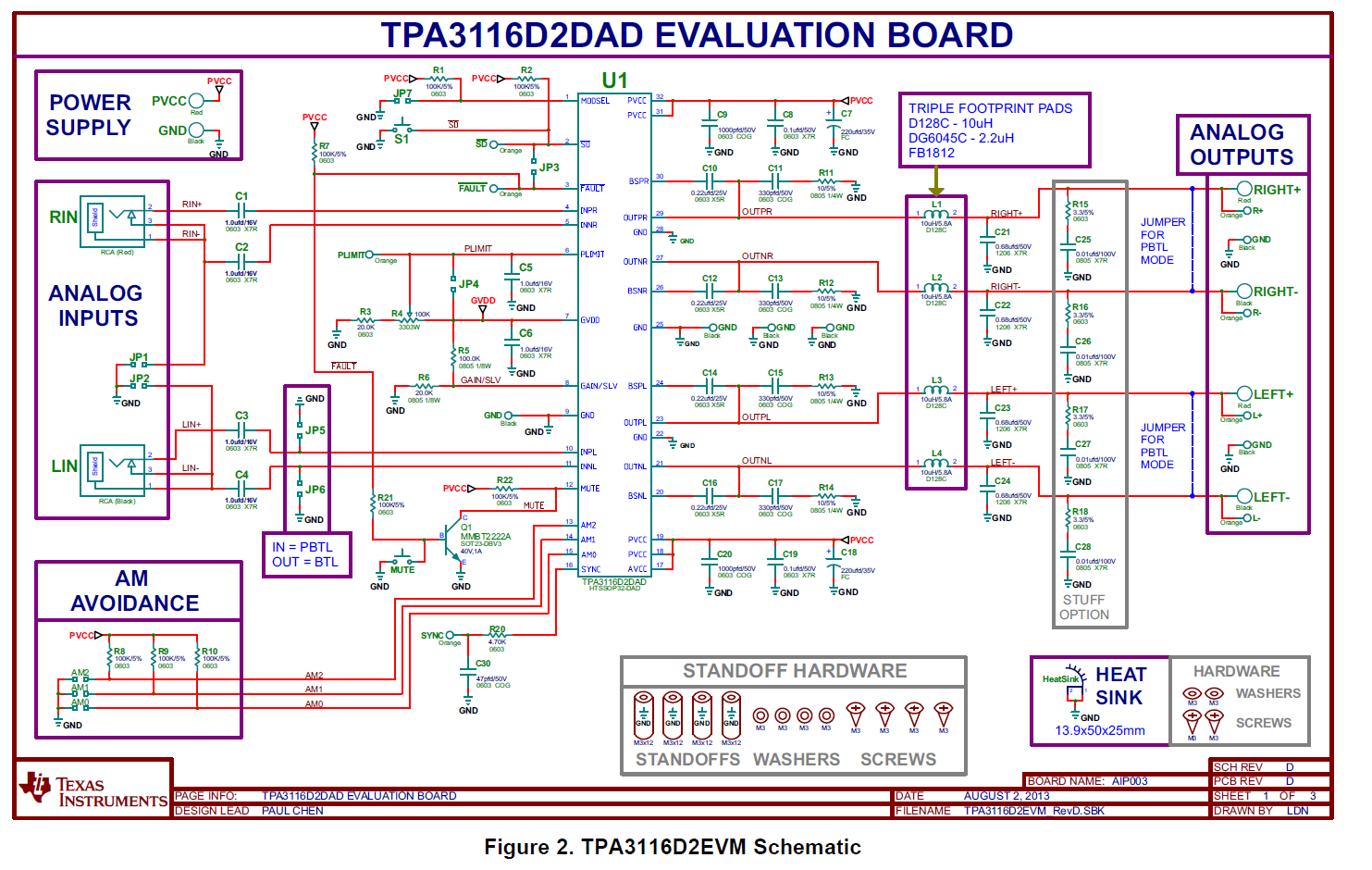

The snubbers TI 3116evm has mounted pre-inductor, like STM's differential snubber pre-inductor.
Both have no direct influence on audioband frequencies, both are very similar, even if you change values with creative calculations 🙂 (and try to simulate)

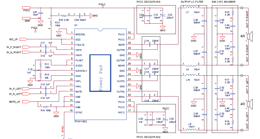

TI's EVM circuit has pre-LC snubbers (aka the "bootstrap snubber" because it is connected to the bootstrap cap), and post LC snubbers. It is very well filtered and perhaps is why it sounds is very clean. Unfortunately, 98% of the Chinese TPA3116 amps went for the recommend circuit in the non-EVM board (which, btw, has an error for the master/slave RC value that renders the slave amp un-sync'd and free-running).
Here is the non-EVM circuit that most amp manufacturer's use:
Here is the EVM circuit for those who may have forgotten. The question to ask is, if we add a 0.1uF and 10R Zobel across the inputs to the two legs of the L's on each side, will that help or hurt this circuit. Seems awfully complex now.
Some manufacturer's (like SMAKN) leave off the output snubber resistor and cap altogether to save on cost and PCB real estate.

TI 3116 EVM board has 10 ohm & 330pF snubber on each output befor inductors. It is only a mod if your ampboard isn't a TI3116 EVM. Datasheet mentions pre-inductor snubbers could be 18 ohm & 330pF.
After inductors the TI 3116 EVM and the datasheet have a 10nF & 3.3 ohm snubber on each output, haven't seen any other value in TI 3116 documents. And they do not call it a Zobel, do they?
It is "creative" to use 10 ohm as resistance for the 10uH inductor in your calculations.

Every Zobel or Boucherotte cell is a snubber, not every snubber is a Zobel or Boucherotte cell. TI and STM use the name snubber, STM enigeers clarify use of the snubber in class D !!! outputfilter
"Snubbers
When the output of a Class-D amplifier switches there normally is a "dead" time between the time when one transistor is turned off and the other transistor is turned on. The dead time is necessary to insure that both transistors are never conducting at the same time, which would cause large currents to flow from the power supply to ground through the transistors. However, the dead time causes a problem because it interrupts the current flowing through the inductors. Snubbers are normally used on the amplifier outputs to provide another path for the inductor current during the dead time.
There are two types of snubbers. Amplifiers with BTL outputs can use a differential snubber, with a single resistor and capacitor in series in between the two outputs. Common-mode snubbers have a resistor and capacitor in series from the output to ground and can be used with either single-ended or BTL outputs.
Common-mode snubbers for amplifiers with BTL outputs use twice as many parts as a differential snubber but they may reduce harmonic distortion. The type of snubber to use will depend on the application. The amplifier manufacturer will normally recommend values for the snubber components." EEtimes "Understanding output filters for Class-D amplifiers"
So both the TI and STM enigineers select snubber as a name, probably because they don't want to confuse us.

And still unaware why bootstrap snubber in 3116 EVM is those values, as data sheet doesn't note why, and everyone seems to follow them.
These are the problems with most product data sheet values. They do not include how they have been determined, so "cross modding", or even optimising is useless unless we gather other sources on the subject for calculations.
