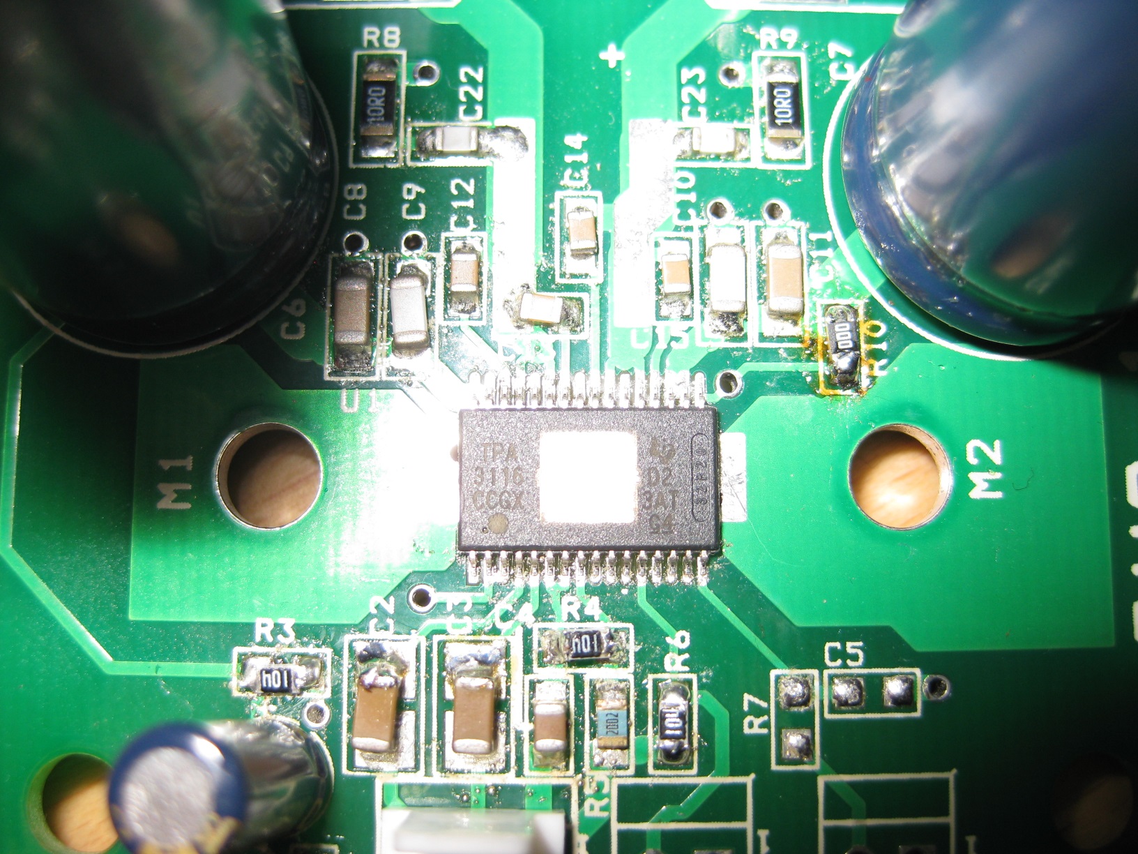

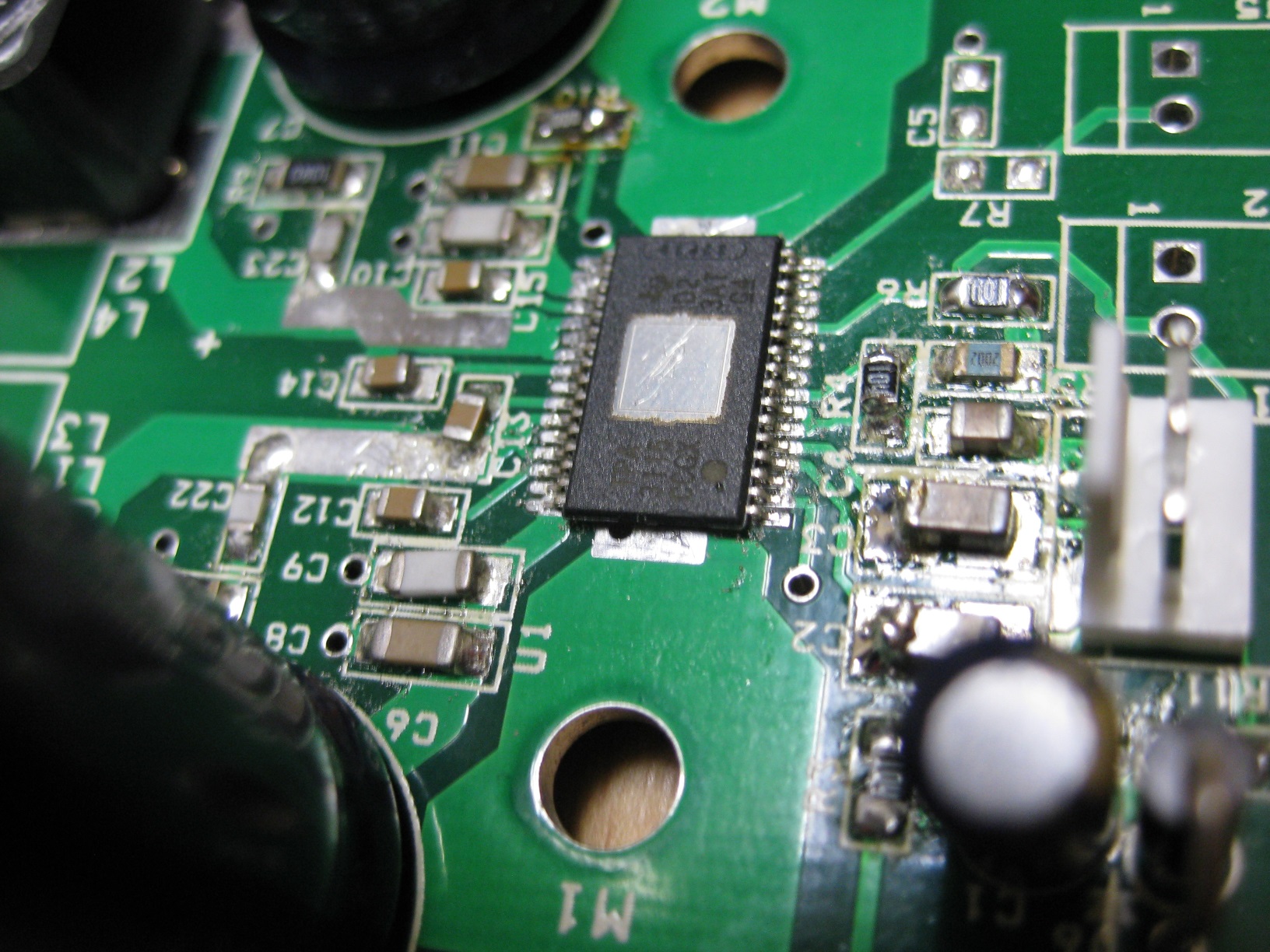

some time ago I bought the DUG board. I now could find the time to order all the parts and assemble the board.
Unfortunately I cannot get sound ouf that amp 🙁.
When I power the board with 12V nothing happens and nearly no current is flowing. The Power pins all get 12V, AVCC is tied to PVCC with a 0R resistor and SDZ is at 10.9V. Sync pin is not toggling and there is 0V at GVDD. Nothing at the output.
What am I doing wrong 😕 How do I get this thing working?

What about the voltage at MUTE?

MUTE is zero volts. All frequency select pins are tied to ground.What about the voltage at MUTE?
I (mis)used a reflow oven the first time. I put the board in before the oven was warmed up. So it was in there for 3 Minutes longer at roughly 160deg C during the warmup process.
Could this have destroyed the chip?

Depends on the oven, but I guess not. 160deg C by oven thermostate or measured on board?
May you measure any voltage at the bootstrap pins?

Check the soldering of C14...I can't really tell if it is OK in the second pix.
Check the soldering of the two large input caps...I can't see solder on the input side...Check R5 as well.

I can measure a few hundret milivolts at the bootstrap pins. Voltage is falling when I leave the multimeter connected.
Checked solder once more and rediti C14. Looks dodgy but seems to be fine. The input voltage appears at the input pins of the tpa.Check the soldering of C14...I can't really tell if it is OK in the second pix.
Huge thanks to you both for you efforts. Is there any more information I can provide?
The 0V at GVDD should be like 7V, so I would check components there and AVCC that feeds regulator for GVDD
Voltage on each side of R4 relative to GND.
Well, if AVCC is up and GVCC is 0V while SDZ is high and no serious current is flowing, the IC is dead for sure if the soldering is right.
If GVCC/GVDD isn't coming up, ohm it out to ground... could be a short hidden under one the pins on the TPA or something.
Got any liquid flux or a flux pen? I'd flux the pins on the TPA and reflow them with a soldering iron.
