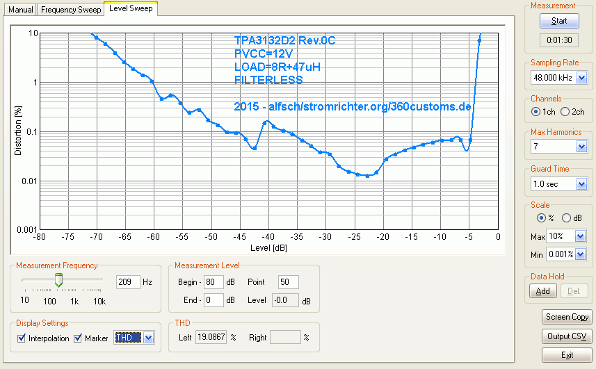

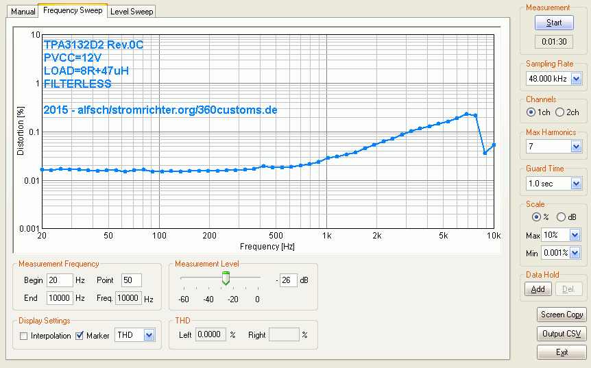

Well, there are measurements for the MAX9709 compared to a TA2020 and EMI/EMV measurements for the MAX9709/TPA3132D2.
MAX9708/MAX9709 25W/50W Class-D ? Messungen - #360customs
TPA3132D2 vs. MAX9709 measurements EMI / EMC - # 360customs
Performance measurements for the actual (my own) TPA3132D2 board are in the pipeline.
Sneak attached. (Thanks to alfsch/stromrichter.org)
