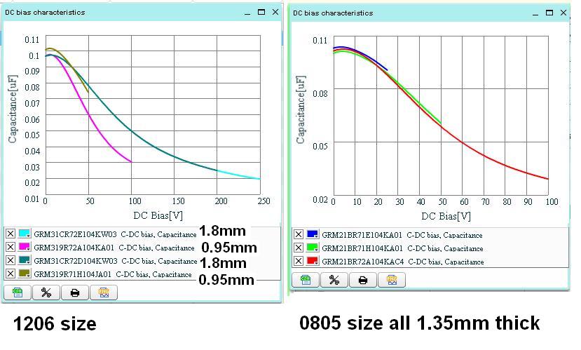

Well, I looked at the site and was totally confused by comparison of apples and oranges and bananas and pears.
So I went to the Murata site and found the graph function.
And compared some things.
Comparing apples to apples was not easy as it offered limited choices.
As it turns out I was not totally correct. (can't possibly say wrong 🙂 )
The graph on the right shows 0805 GRM series of 0.1uF of all 1.35mm thickness with 25V, 50V, and 100V parts.
Very interesting...This graph makes us both wrong. 🙂 (IMHO)
The graph on the left shows that (if you shift for equal start point) the thickness is of more importance for capacitance change than the voltage rating...all other things being equal.
I am glad to have had to look this up.
Thank you.
