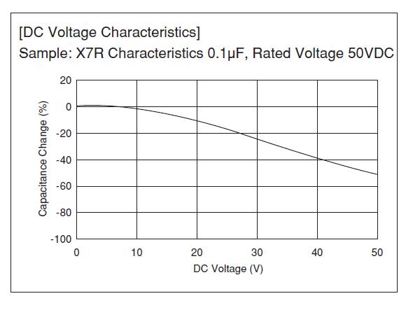

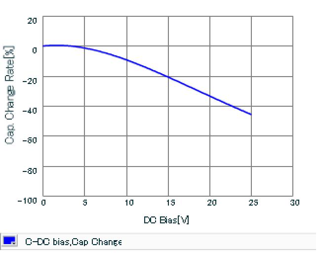

Here are my thoughts on the bootstrap discussion.
As everyone should know X5R (and X7R and other) dielectric types have a capacitance drop when a DC is applied. (see .jpgs)
This is very critical when caps are used for timing (and filtering) circuits.
The TI ap note has 0.22uF / 25V X5R 0603 package.
Let us say for the sake of discussion that the bootstrap caps are charged to 10V.
A 25V rated X5R cap at 10V will drop to 90% of value.
I would think that the guys at TI would know this.
Maybe the circuit only needs 0.2uF at 10V and they specified a 0.22uF to compensate.
So going to a 250V part will get you closer to the 0.22uF but I don't think a supply switching at 400KHz+ will notice the change.
Probably only needs 0.1uF anyway 🙂
BUT if you think it sounds better then I cannot dispute that.
Happy moding.

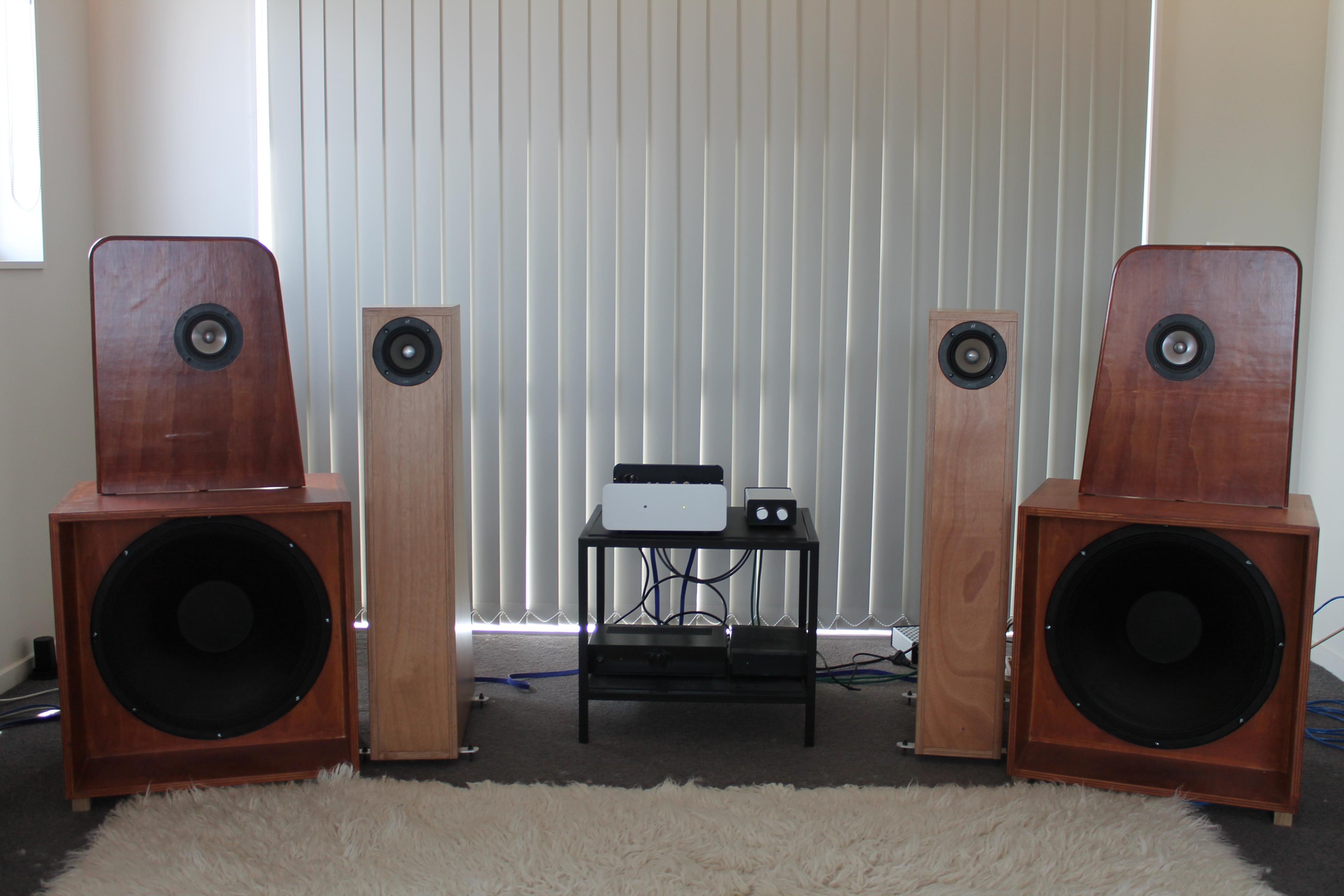

DUG amp listening compare
As promised, spent about an hour listening and comparing the DUG amp to my much modded blue/black amp.
A clear winner? Very difficult, so very little in it. I would think - "aha, there is a difference", swap back and... nope! In the end I think the DUG amp is just that little less grainy, cleaner, evident mostly on vocal pieces. But really, if it was double blind, I doubt I would pick it every time.
To put into context of equipment etc. - speakers are my FH3 cabinets with 4" Tangband drivers (bit less revealing than my MA drivers), autoformer volume control and ES9023 based USB DAC. And, of course, my less than perfect ears.
Main similarities/differences between the 2 amplifiers:
Same transformer
Same PSU tho the blue/black has lower quality caps but more capacitance
Blue/black has WIMA input caps, DUG Sprague PIO
Blue/black has Bourns inductors, DUG has Coilcraft
Other minor differences.
Last of all I put in a YBDZ board, fully modded with Meanwell SMPS PSU - yes, I can tell the difference now. This amp is brighter and harsher tho still not too bad an amp.
Quick pic of set up during comparison, mainly so I can show off some of my kit!
Thanks Chris for the transparent and honest review. Was the build price between the amps about the same?
Mmm, not so easy to say as the mods on the Blue/black were a gradual process.
The DUG amp boards would be more expensive as they are dual mono. Also buying individual components is more costly but you are sure of the quality.
I already had or re-used the cases and transformers.
