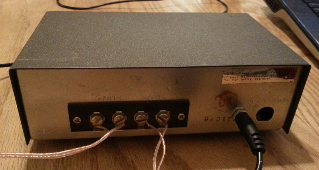

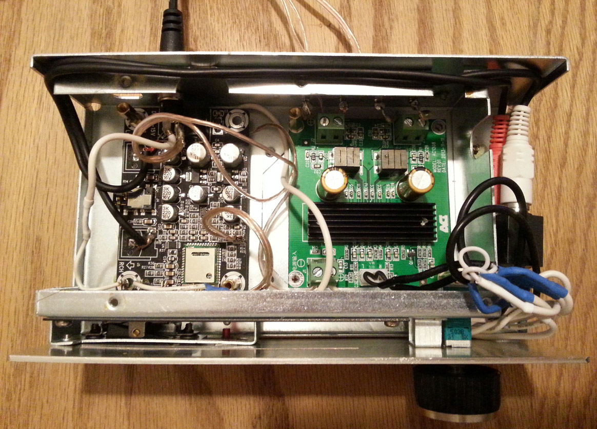

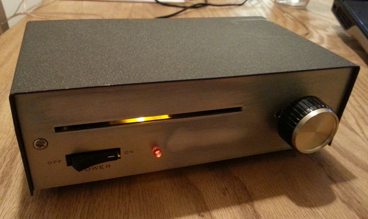

I finally finished my 2.0 3116 enclosure. On my first attempt with a red YJ board I tried some capacitor hack to try and solve the speaker pop but I'm pretty convinced that it damaged the chip.
This time around I bought an audiobah. I did have success with giancarlo's pop elimination circuit though it seems audiobah gets better reviews than Red YJ. I've paired it with an aptX enabled bluetooth receiver. In my mind this is some kinda Air DAC...maybe?? It's from SURE electronics and of course it's got an issue where they didn't use the right capacitors in the factory so there's a 30 second full volume delay upon power on which could lead to an unknowing listener(wife) cranking the volume so that's on the list of things to fix.(SURE told me this problem has been fixed with all current boards being sold) That being said it uses 9v-15v so it's nice for pairing with the 3116 without having to reduce the DC voltage from the input. The light on the front of the case also blinks until the module has been paired which I like for usability(wife).
The best part about it is the case I found at goodwill. All I had to do was re-drill some stuff, dremel a bigger opening for the potentiometer and drill a hole for the power jack.
I think I remember someone saying the corner holes on the audiobah board are connected to ground so I guess my board would be grounded via the power jack as I think the sheath is ground? I'm still trying to fully comprehend grounding and ground loops, etc. I haven't had a chance to really listen to the amp but was able to turn it on for a minute and it didn't sound like there was a ground loop issue even though I was expecting one.
The case is small so it was a PITA working on. This is definitely a warm up for DUG's pcb, which I am looking forward to not burning. I would really appreciate any feedback in terms of things that don't look right. I know the wire kinda runs all over the place and I'm sure some cross which shouldn't so please let me know of anything undesirable for my next project.
The potentiometer is a AlpsRK097 that has a push button on/off feature which I obviously didn't need for this project but I could see it as a great solution to a 3116 board that doesn't come with an on/off switch.

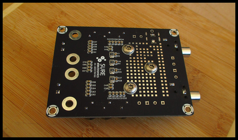

I hope to finally get around to listening to SURE's new TPA3116 this week. I like the newest version of the little TPA3110 with filter and expect this one to be nice too. Not sure why the need for such a massive heat-sink that weighs in at 45 grams.

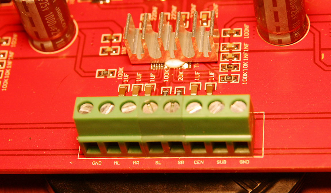

Thanks awty- Does it matter which ground or should I use both with some connections to the left gnd and some to the right side?
The one on the left is for the mains, the one on the right is for the sub. Not sure about the surrounds and center as I cant see how they connect. You can check with a multi meter for continuity, but it probably wouldn't matter. My guess is they are all connected to the same ground.
