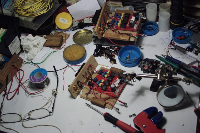

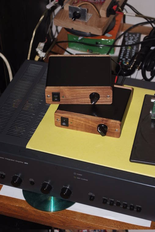

After a month of listening to my YJ 2.0 red amps, I decided it's time to find them a more permanent "home".
Attached is the result: the case is actually aluminium external HDD case, sawn in two 🙂 - got a perfect fit for two amps...
The sound is still great, and now they even look good...
BTW, on the third photo you can see the audio source: Raspberry Pi with Wolfson audio card (up to 24/192), which is definitely the "best buy" in computer audio today... about €100 for a 24/192 bitperfect audio with excellent sound, easily comparable to much, much more expensive devices...
