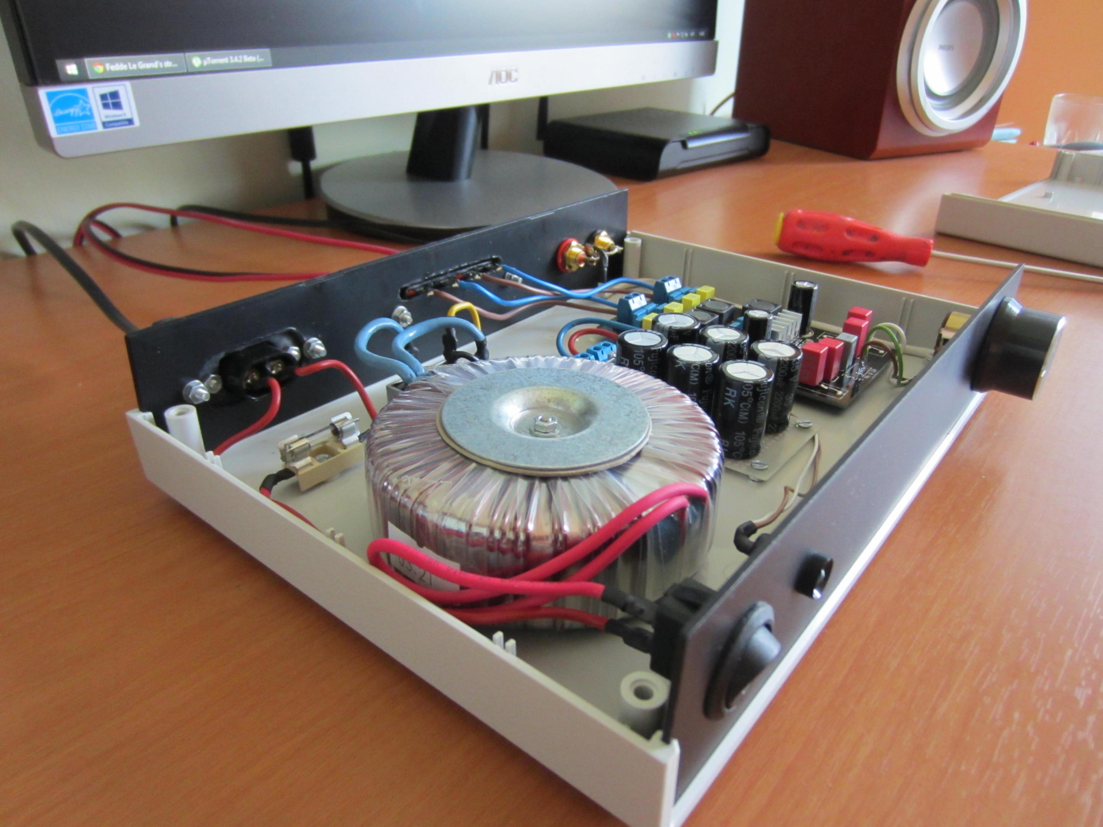

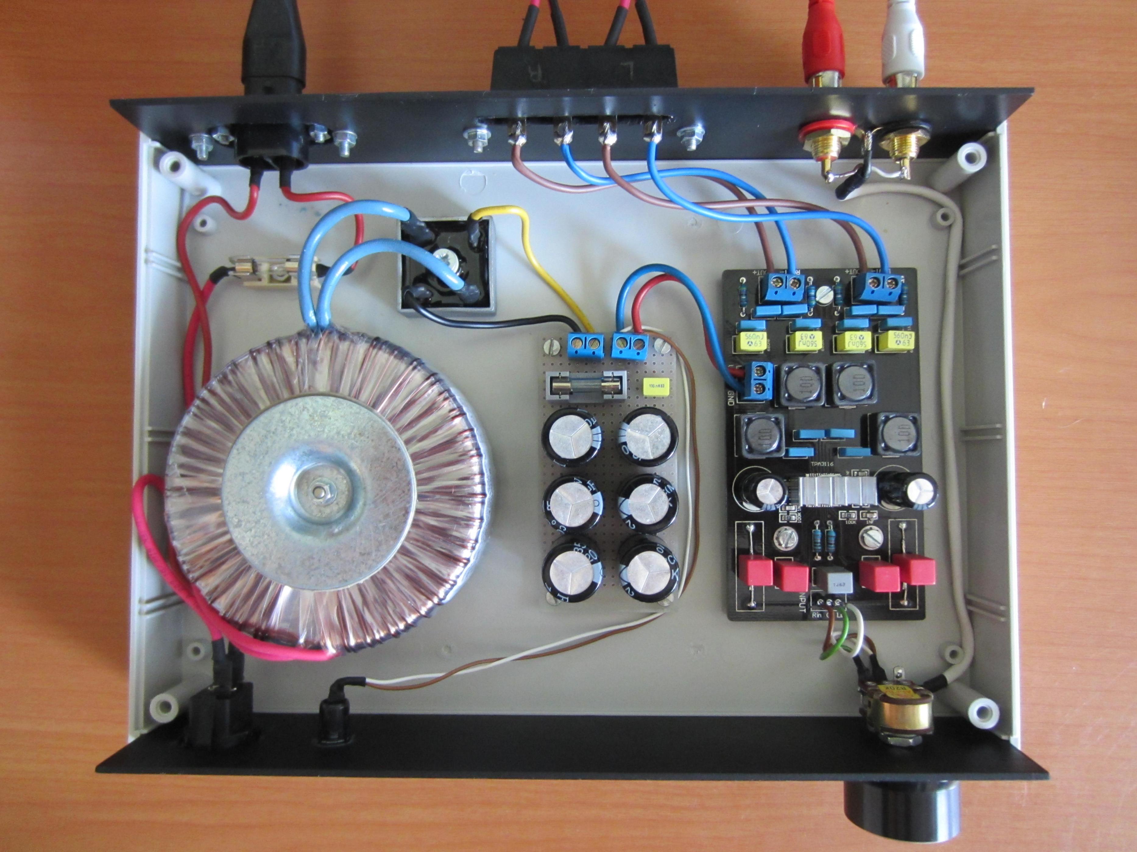

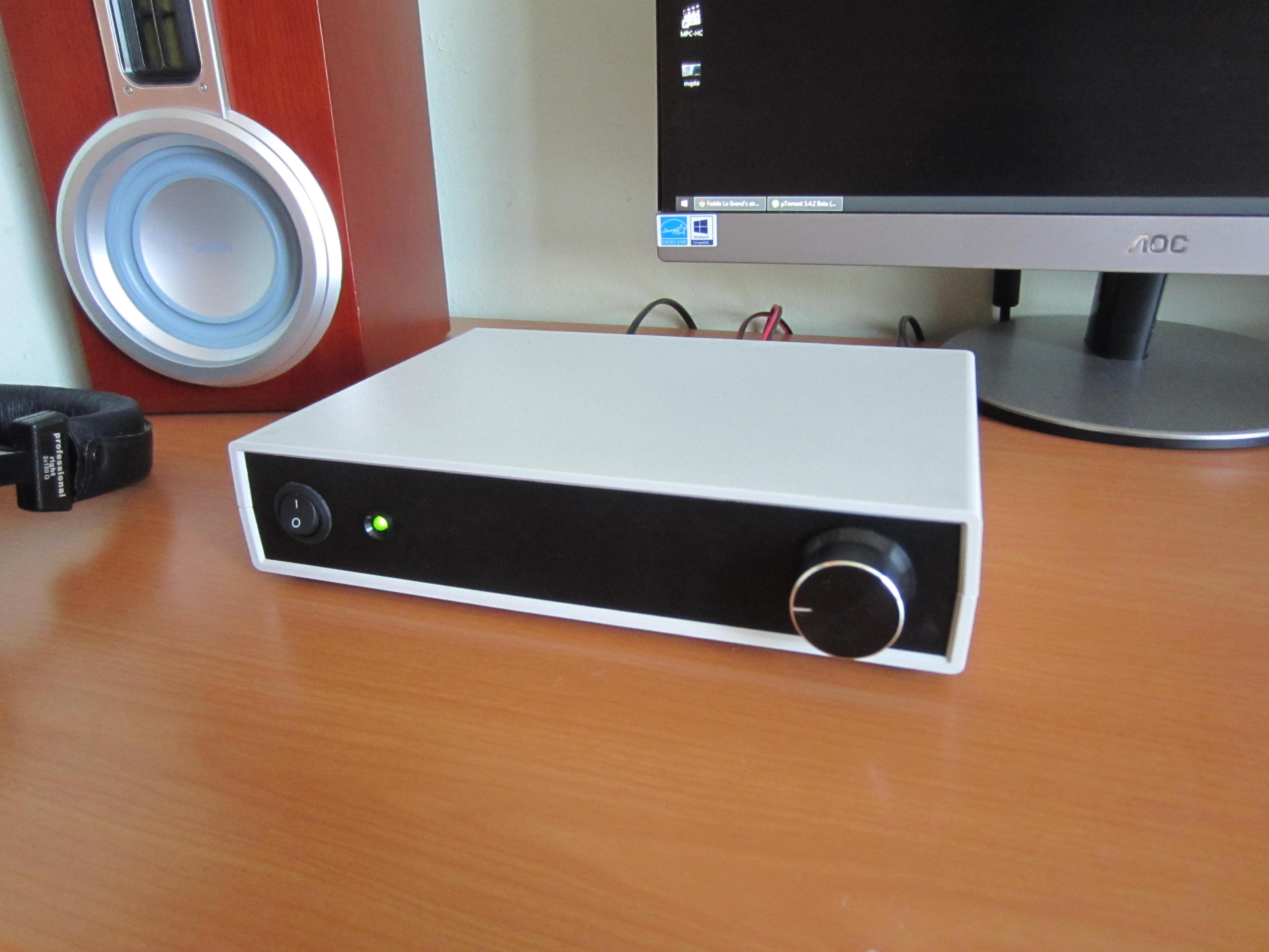

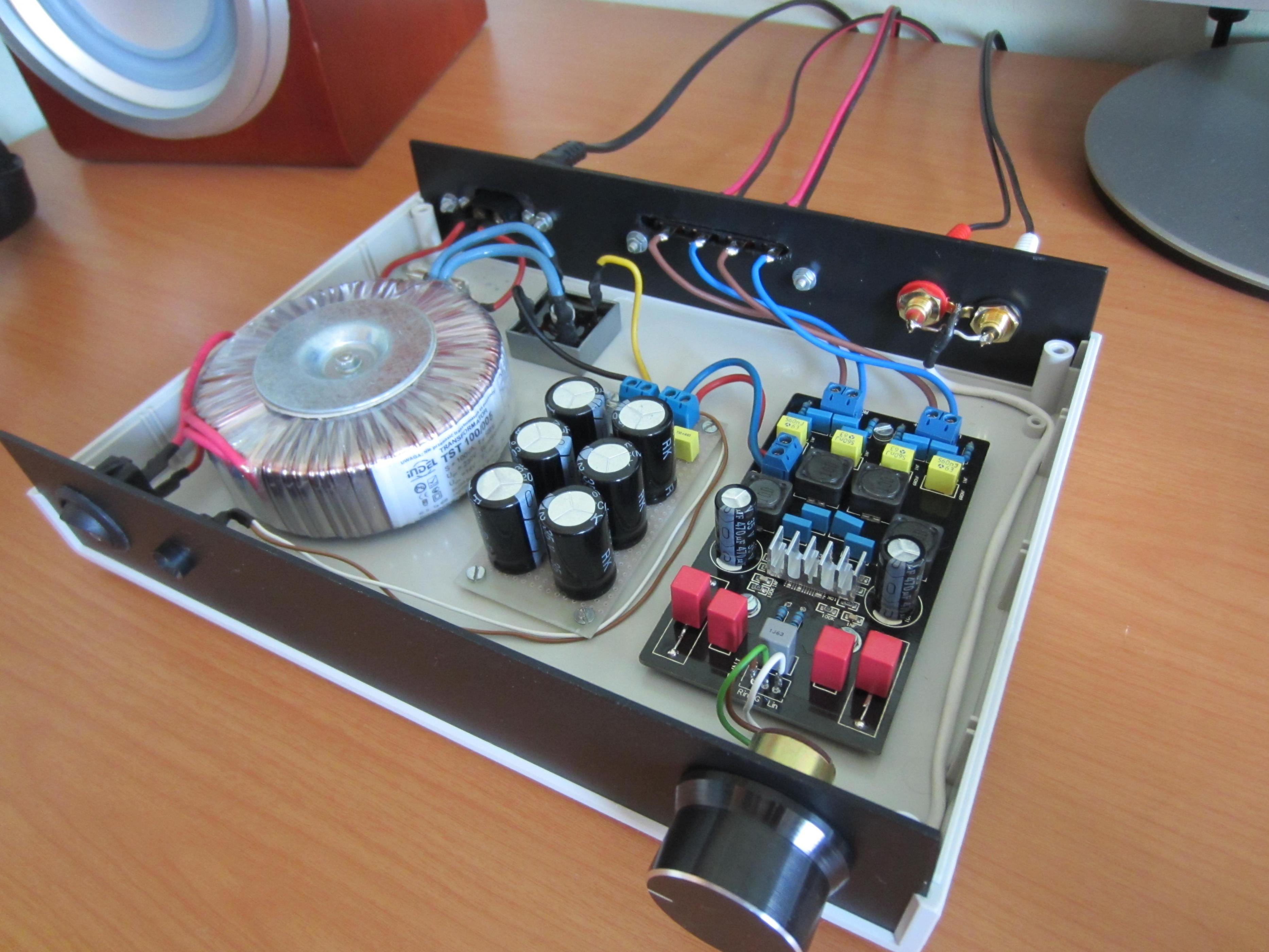

Here is what I came up with.
I'm very pleased with the result. The changes to the board are minor. I replaced the input caps to remove the pop when its turning on.

That is a sweet looking build! Very nice. What voltage is your fancy toroid transformer and cap bank putting out? Also, what value did you end up going with for the input caps? I noticed that your LC filter caps are yellow film 560nJ instead of the TI spec'd 680nJ (same as on mine). I wonder if that is a purposeful switch or did YJ just run out of 680's and thought "close enough"?!

I actually compared the yellow Thomson 560nF to Wima's on YJblue, the Thomsons sounded better can you believe it🙂 But probably stock blue 680nF run out and these were cheaper I guess🙂

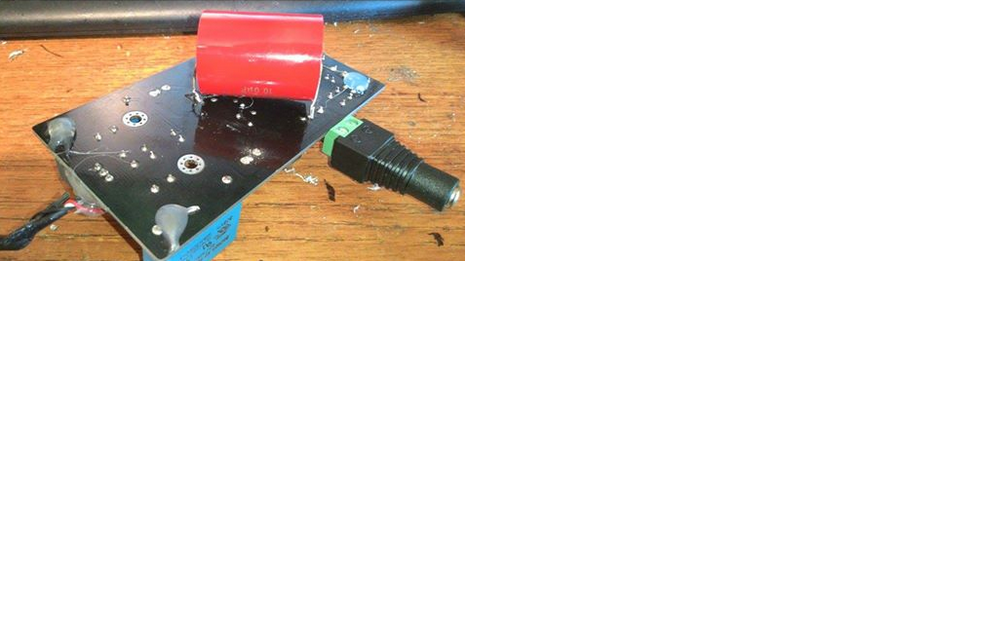

Today I did some quick experiments on th YJ black board:
1.Changed the Jamicons power caps to elma silmic 1000uF standing on the underside of the board. (Very short legs). I hoped it would reduce ringing/sibilance since they would be further from the inductors.
That changed nothing.
2. I added a cheap but large 10uF Mkp cap in parallel to the Silmics. That helped almost nothing.
3.I removed the Silimics and just left the ONE 10uF mkp capacitor. I started to suspect ringing between the 2 powercaps. (Btw, I drive the amp with a laptop powersupply).
I hooked the amp up again 90% of the ringing was gone!!! I then coiled wire from the psu 15 times around a iron bar I had lying around and all the ringing was gone! I have the same ringing on a yj red board too (with a toroid psu) only less ringing. I added a picture whith the solution that sounded great!
Could the ringing/ harsness on these amps be caused by 2 dual power caps?

You added a inductor filter to PSU in a inventive way. HF can be injected by PSU, so it is like the pin17 mod, but for both AVCC and PVCC now🙂 Some Japanese and Korean boards have ferrite beads on PSU pcbboard entrance.
My laptop 19v SMPS cable has a ferrite choke right at the input to the amp. I wonder if that type of laptop cable makes a difference. Neat idea to wrap around iron core.
Regarding the dual Silmics causing ringing: I know with dual 470uF or 560uF or 330uF Panasonics - this does not seem to be a problem. The new 330uF 25V Panansonic OSCON SEPF's with very low ESR may be the trick. I wonder if it has to do with low ESR as that absorbs the ringing?
@Irrebeo: so those yellow 560nF caps are Thomsons and they sound better than the blue 680nF's? Well that is great, I will leave them be. The Wiener bootstraps are SMT - see photo. I do not see 6.8uF SMT's on GVdd pin 7?:
The laptop powersupply already has a choke on the end but it clearly wasn't enough.. It switches in the audible tweeter frequency too🙁 But it sounded alright with the iron bar mod! Even the audible high pitch disappeared from the psu disappeared. But the harshess doesn't come from the bad psu.. I have the same harsness on the yj red board too, only less of it🙁 If done every mod available to the red board except the 0.1uF decoupling mod. I have changed those out with silmics 2 which helped alot, but still not perfect. For now the black board is clearly best with only upgraded bootstrap caps(smds) and 1 10uF Mkp power cap.
