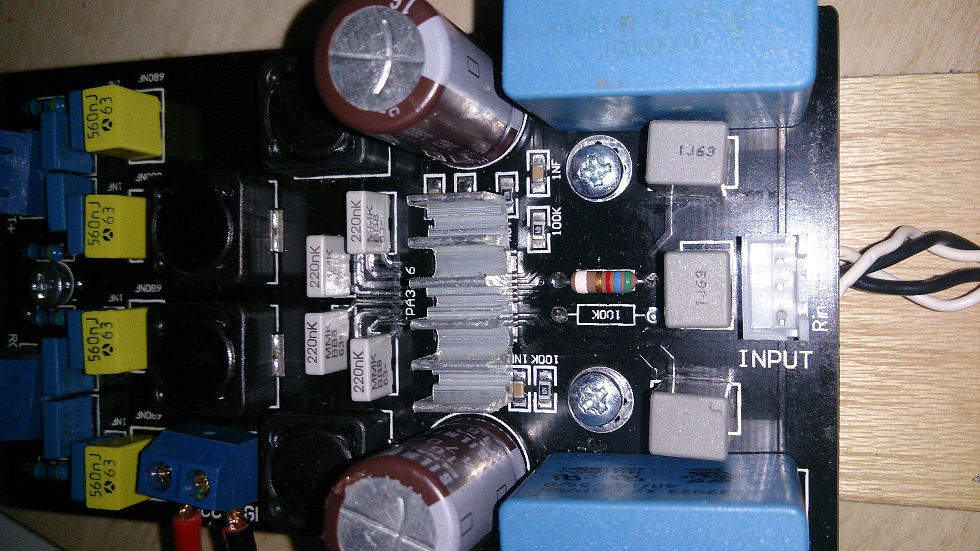

Hi, great build and tidy, where did u get the enclosure, can't find it on ebay?
Thats the case - MULTICOMP - G750
The input caps are Wima 2.2u 63V. Power supply outputs 19.5-20 volts. Filter is set by 6 x 3300uF 35V caps and one 330nF. The transformer is 100W (14V 7.14A).
The yellow caps at the output are the original.

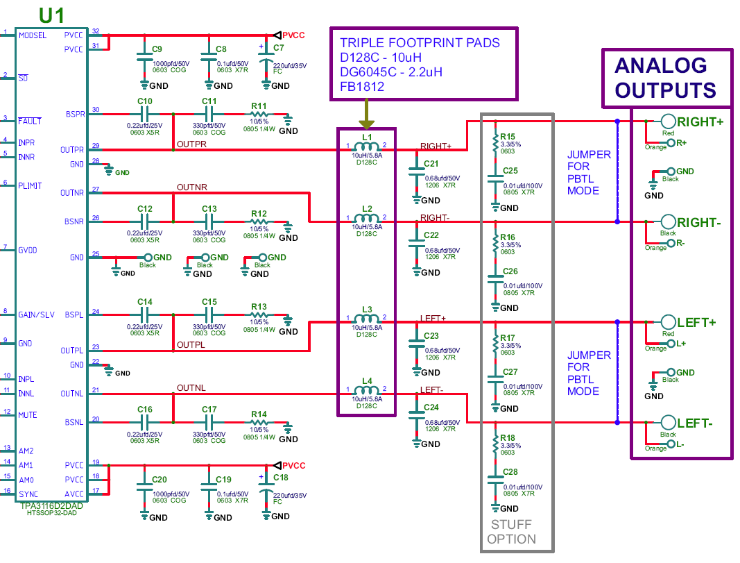

Boostrap Capacitors and Snubber Circuit?

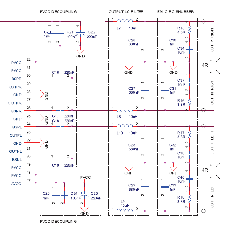

The topic of what bootstrap caps work or don't work on the TPA3116D2 seems to be the hot topic. I am not sure if this has been previously asked but I just realized that when I built my TPA3118D2 "Dead Bug Point-to-Point" amp, I followed the EVM circuit schematic. If you look at the EVM datasheet (http://www.ti.com/lit/ug/slou336b/slou336b.pdf), Fig. 2 shows a 330pF 50V COG ceramic cap connected in series with a 10ohm resistor to ground tied to the 220nF bootstrap cap:

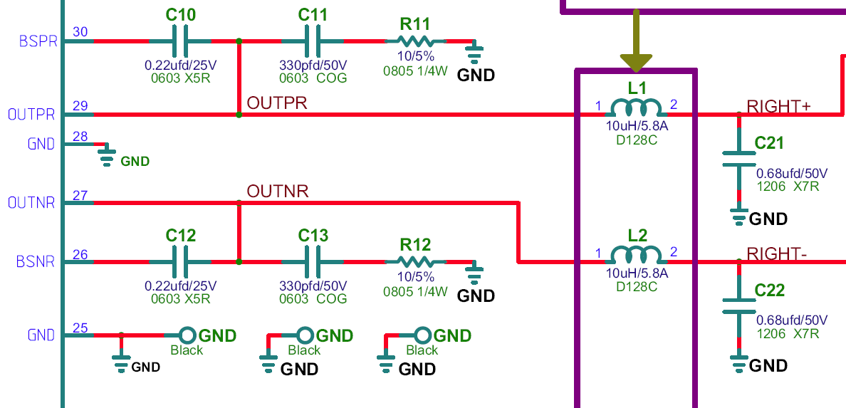

Here is a closeup of the EVM snubber shown above:
Is this to "snub" the ringing that so many folks hear and complain about? When I listen to my dead bug amp, it sounds cleaner - less sibilance and I wonder if this is the case? Should we all be seriously trying this mod next? I think it might be a simple case of butt-soldered 330pF-10ohm connected to the 220pF bootstrap cap for SMT mods on Ybdz for example, and in the case of the YJ Blue/Black a simple 330pF axial and 10ohm 1/4-watt resistor can be added easily.

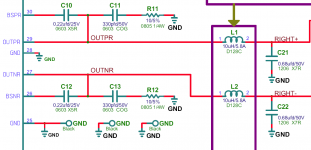

For comparison, the basic circuit that all of the Chinese boards out there use (except the one EVM copy) seems to be missing and may be a big part of the sound quality. The basic datasheet is here: http://www.ti.com/lit/ds/symlink/tpa3116d2.pdf Here is a closeup of the standard filter and bootstrap circuit:
What do you all think? Probably worth trying... certainly it is very inexpensive to add.
