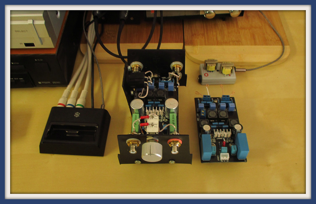

With the 26dB gain on the 3116, I can definitely drive my 91 dB efficient speakers to loud, almost un-tolerable levels of volume with a 19 volt smps. More than enough oomph IMO. I have not had an issue with low resolution volume control due to bit loss of the volume knob ADC.Be aware that max output of minidsp 2x4 unbalanced is 0.9V.

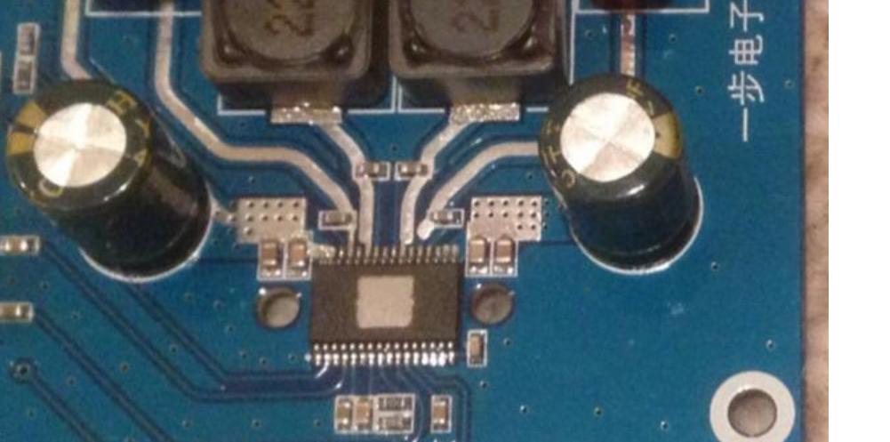

question for X, apologies if this comes across as a PITA,
but the link in post 2273 sez gain is set at 36 dB,
was this a typo on their part or did you replace a couple resistors to get 26 dB gain?
Also curious whether PLIMIT has been set on these boards,
the illustration on p16 of the TPA3116 datasheet makes it look like a fairly hard clip
when it's activated, and my presumption was that a lower gain setting
might leave enough headroom to simply avoid that possibility.
Any thoughts/experience regarding this greatly appreciated in advance,
Quard

I guess I lucked out, mine actually shipped with 26 dB gain despite what the specs say. It also has a blue PCB and not green. I looked at the two gain resistors and indeed they are 20k and 100k per Table 1 in the TI spec sheet. It also sounds the same loudness as my previous homebuilt TPA3116 which is what I was referring to when I said the miniDSP can drive my speakers to near intolerable levels.

YES! PS high freq SM caps as close to chip as possible! Even under the heatsink!
