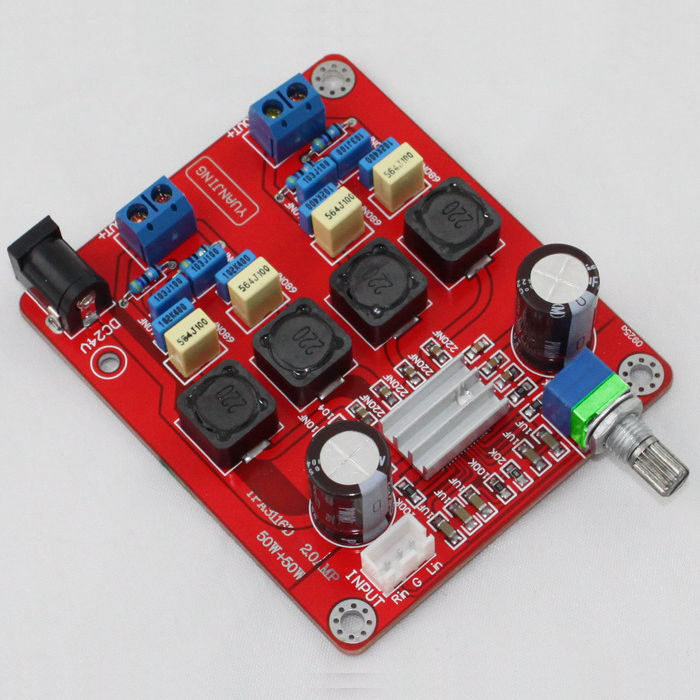

i try to implement the red yj 2.0 board better into its environment.
1.
i´m designing a preamp with an active crossover.
now i want to get the volume control away from the tpa3116 board and onto the preamp.
it should be realized with either an inverting or a non-inverting amplifier (depends on how the rest of the preamp will finally look).
what must i look for considering the given gain and impedance on the red yj board?
from the datasheet i know that the 20k and 100k input resistor make for a 26db gain and 30k input impedance.
what would a good and simple volume control based on a tl072 opamp?
please excuse my incompetence, this is the first time i'm doing something like this.
2.
i'm driving two big fr-horns with the tpa3116 board in stereo mode.
the drivers are 8 ohmers
BG 20 - 8 Ohm.
as far as i understand the board uses bd-modulation.
from another ti-doc
http://www.ti.com/lit/an/sloa119a/sloa119a.pdf
(page 11, table 2)
i understand, that the given 22uH inductor and 680nF capacitor fit 8ohm speakers.
but i do not understand the rest of the output filter.
are there serious improvements to make by changing those filters?

Well, that would be the case if the switching frequency was 250khz as used in the examples in that TI-doc. However, the TPA3116 has a 400khz switching frequency so the corner frequency has to be moved up 1.6 times to have the same peaking at switching frequency otherwise you can have significant losses in the output filter coils (they get hot). Thankfully that also makes the coils much smaller and at the same time moves the filter decay out of the audible range as a corner frequency of just 28khz is quite audible as phase and amplitude of the filter affects the audible frequency range. Moving it to a 45khz corner frequency moves most audible effects out of the audible frequency range.
Please follow the TPA3116 data sheet recommendations instead of an outdated TI-doc. Or at least apply the appropriate changes.
I've been enjoying my red YJ 2.0 amp, but I now have a problem with the board. The volume pot no longer will attenuate the output completely. The left side will not adjust to silence. Anyone have an idea what might cause that? It is very weird. Was working normally just yesterday...
I will have to investigate all the connections...
Great info, though the thread is lengthy and getting difficult to find the appropriate info I need. Anyways, if it has not been mentioned the YJ Red TPA3116 is on-sale at $13.99, if it is helpful for anyone thinking of getting one.
I've been enjoying my red YJ 2.0 amp, but I now have a problem with the board. The volume pot no longer will attenuate the output completely. The left side will not adjust to silence. Anyone have an idea what might cause that? It is very weird. Was working normally just yesterday...I will have to investigate all the connections...
May be the volume pot is not working properly? Disconnect the power to the amp. Turn the board upside down. Measure the resistance of the pot while turning the shaft slowly to see whether there is anything abnormal. Both channels should measure about the same. Hope it helps.
On my second red YJ board yesterday I was thinking to a potentiometer failure (a channel was disappearing only at precise position of the pot.) but it was only a bad/cold solder of the same pot.
Just a touch with the iron, and the problem is gone.
Thanks, Lo_Tse and fritznet. Cold solder joint(s) is most likely the problem. I wiggled the pot shaft 😱 around and was able to make the "bleed through" stop. I'll give the pot connections a shot with the iron and see if that fixes things.

could someone please list the best values for output filters.
for the red 2.0 board with 4ohm and with 8ohm speakers.
and for a pbtled red 2.0 board with an 2ohm, 4ohm and 8ohm speaker.
i know this thread is already polluted, i´m a worthlees noob and the datasheet gives plenty of info.
...but i don´t get it...
"Best filter" I couldn't tell. But values for simple filters like TI uses in datasheet gives the 2.0 redboard a cutoff freq 29.000hz when your speakers act like 8ohm load. Matching condensators with the 22uH inductors are 0.68uF.
If you would want a 40.000hz cutoff freq with 8 ohm, inductors would need to be changed into 16uH and condensators into 0.5uF.
Using 11uH inductors with a 8 ohmísh speaker makes cutoff 58.000hz and matching condensators 0.33uF
If you chose to keep 29.000hz cutoff into 4 ohm, the inductors would be 11uH, c's 1.4uF.
40.000hz into 4ohm gives 8uH inductors with 1uF c's
58.000hz cutoff here gives 5.5uH inductors with 0.68uF
PBTL is same but for 2 ohm 29.000hz is with 5.5uH and 2.7uF
40.000hz for 2 ohm 4uH and 2uF
58.000hz for 2 ohm 2.75uH and 1.4uF

Will filters with different parts but equal cutoff freq into a different speaker/load act(sound) the same?? Dont think so (Q??)... Will filters where the condensators do not give same cutoff freq as the used inductors really badly influence temperature (inductor/voicecoil) or sound??? I dont know.

how is that calculated?
the formula i know for rlc-lowpass-filters do not match those values.
I think the same formula but for BTL each inductor is half of total inductance and each condensator double the value because in series, compared to your calculations I think???thanks irribeo.
