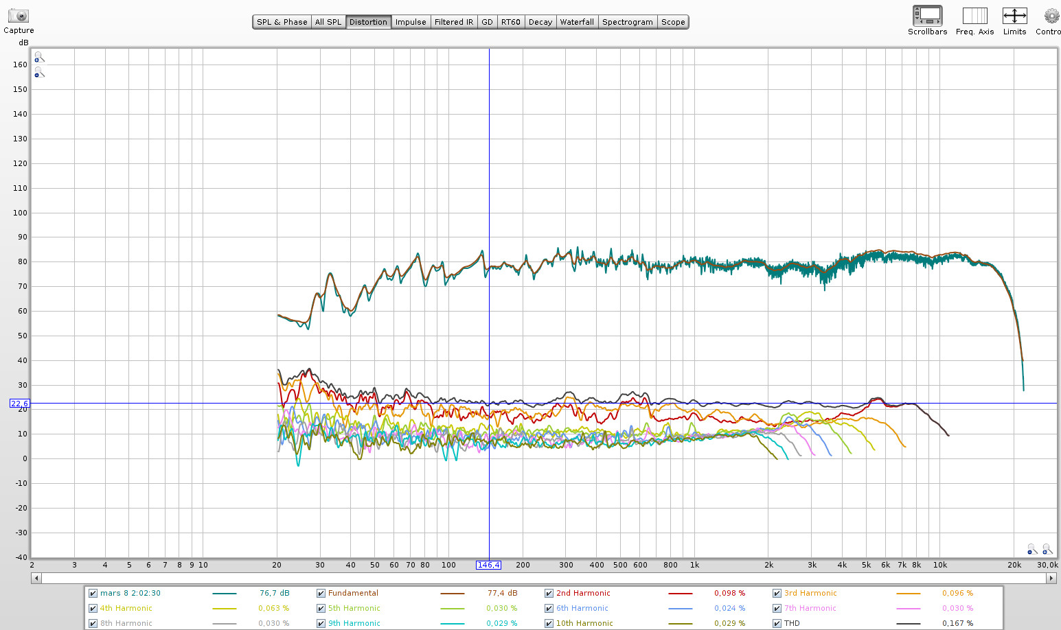

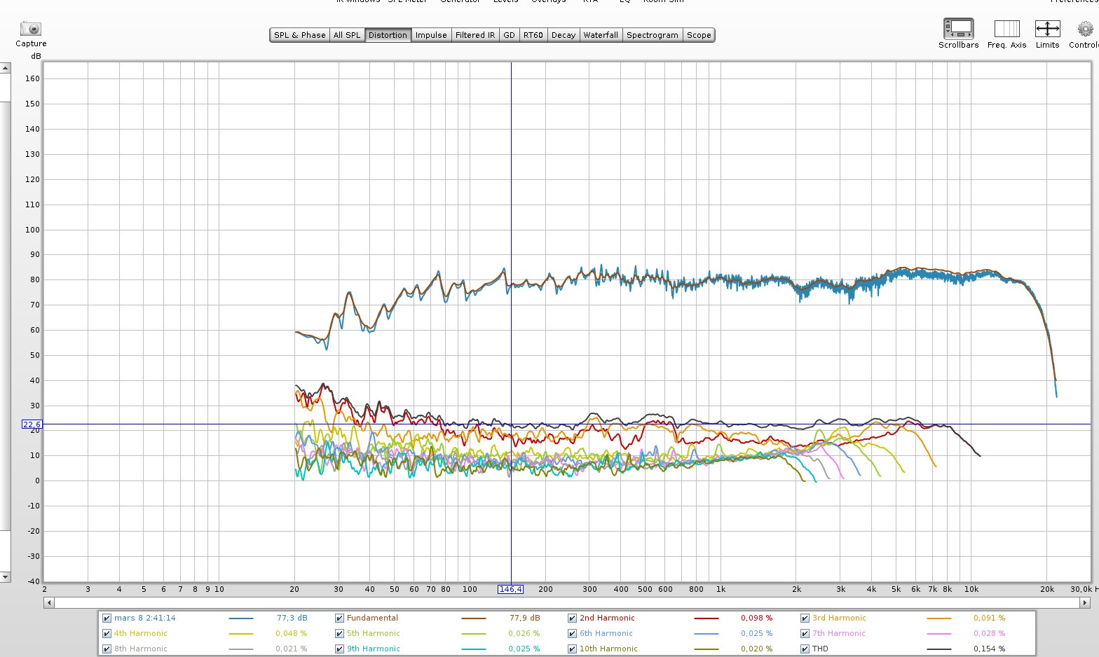

Did you see any difference in the harmonic distortion in the REW measurements? Probably not I would imagine. Also, sometimes details show up as changes to impulse response.

Hi xrk971,
here are two distorsion measurements.
Maybe I didn't produce good measurements, for me differences are not relevant.
Please try to find the YJ board 🙂
