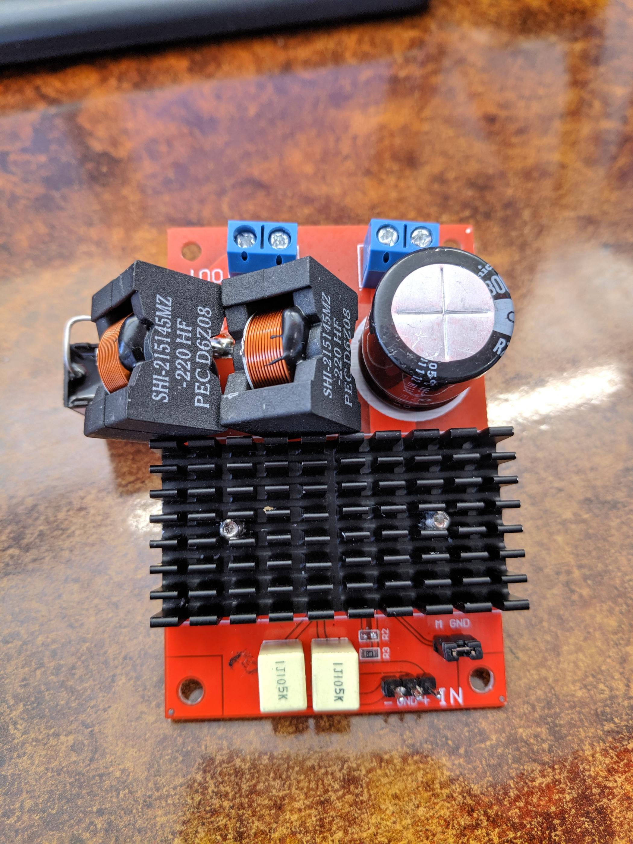

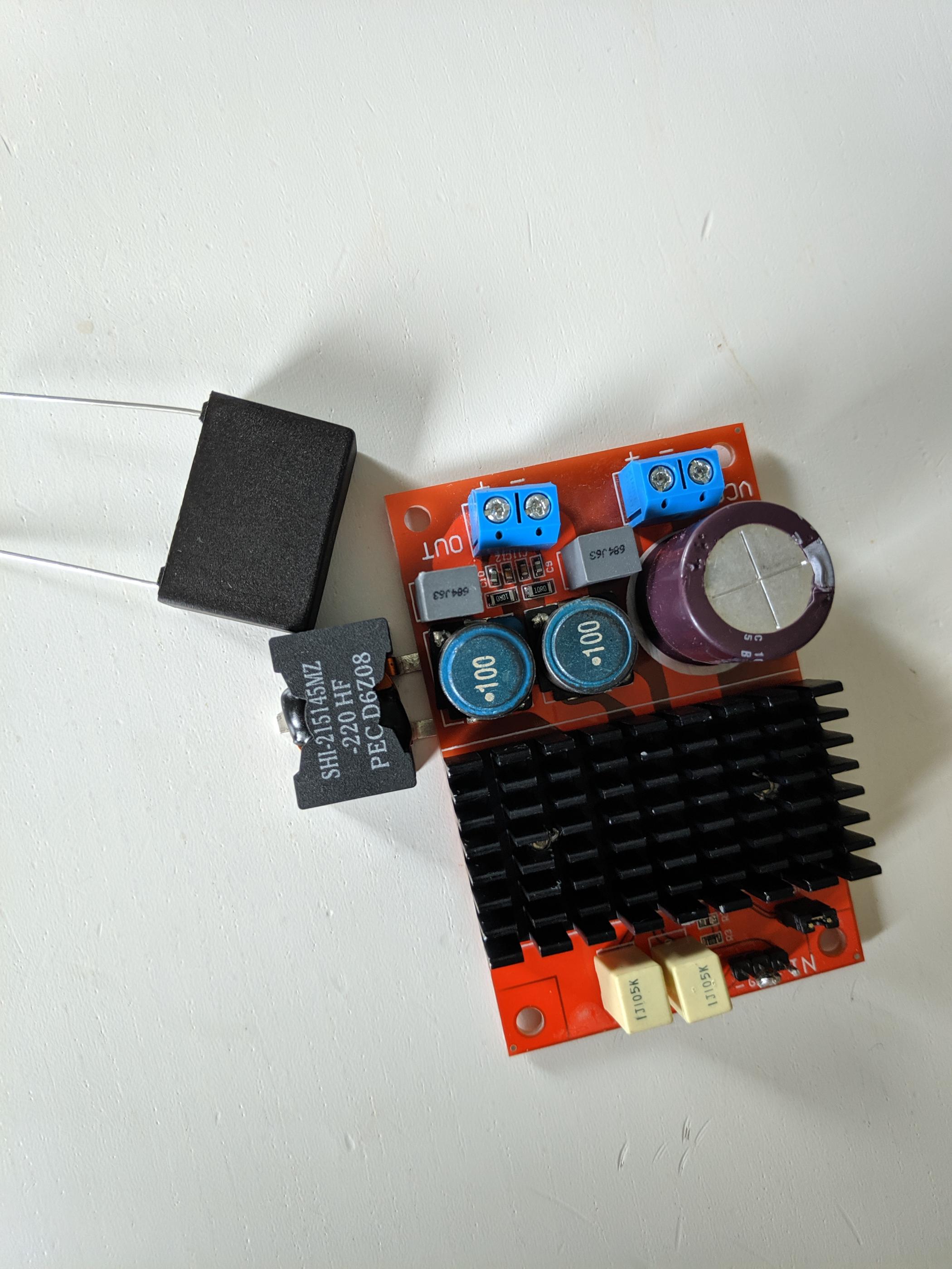

I guess it is a foil capacitor to replace one of the small ceramic SMD capacitor used at the inputs (signal coupling capacitors).There's no way these will fit😀
True, no chance to get it in place. You can find smaller but they will still be too large.
Now I'm confused... I kind of thought the grey caps by the inductors on the pcb are part of the filter. True, never checked anything...
Aren't they?
The big new ones are polypropylene caps for the LC filter - replacement for the grey ones.
I thought that in the worst case, I could mount the inductors so that they lay on their sides, and the caps on the bottom of the pcb. Or just leave the legs unsightly long and let the caps protrude from the pcb several cm.
Aren't they?
Sorry, I misunderstood. The smaller gray (foil) capacitors on the board are indeed part of the output filter. I did not know that you want to replace those. Yes, the bigger ones you bought may be a little better but the improvement will be marginal.

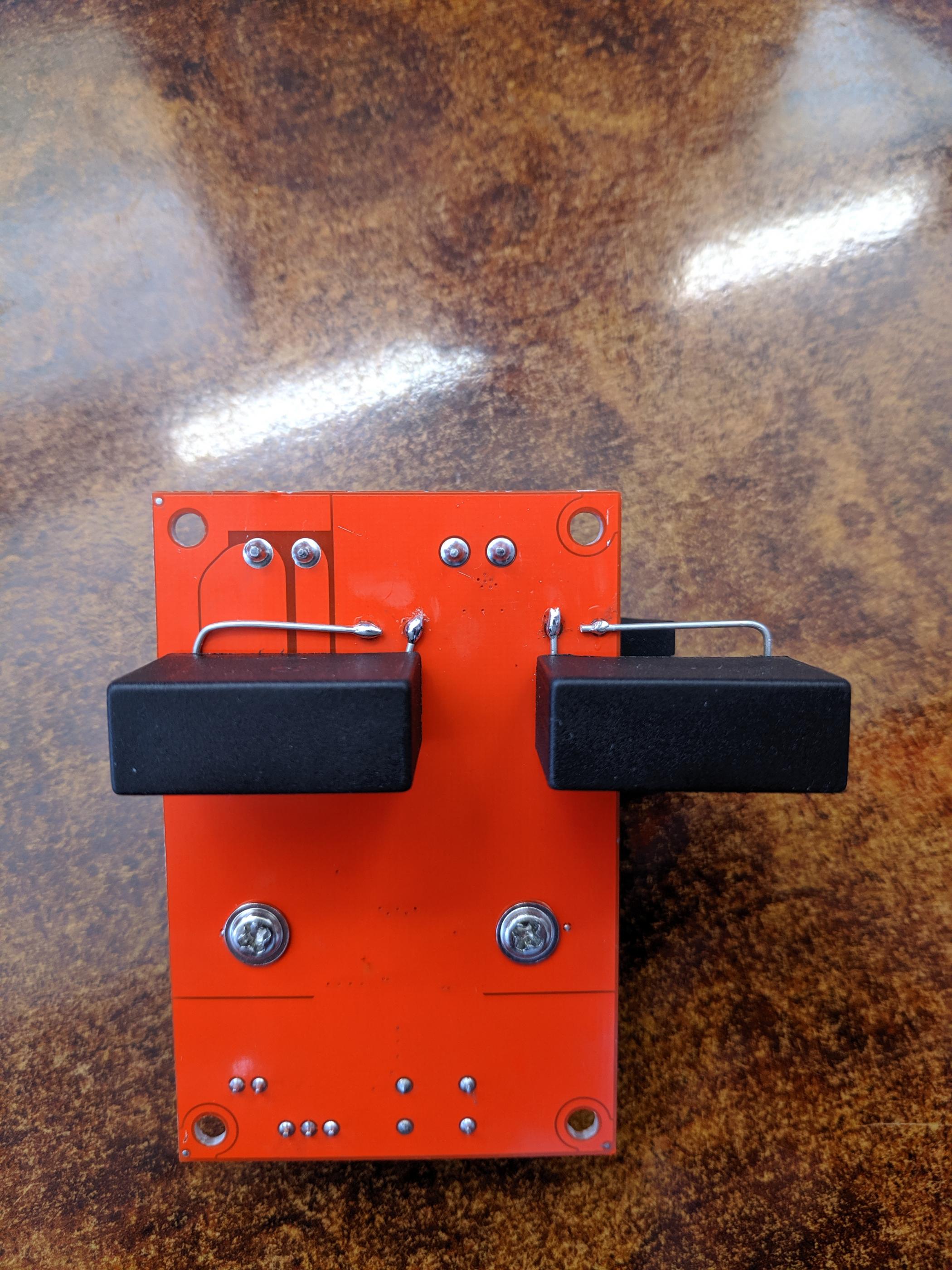

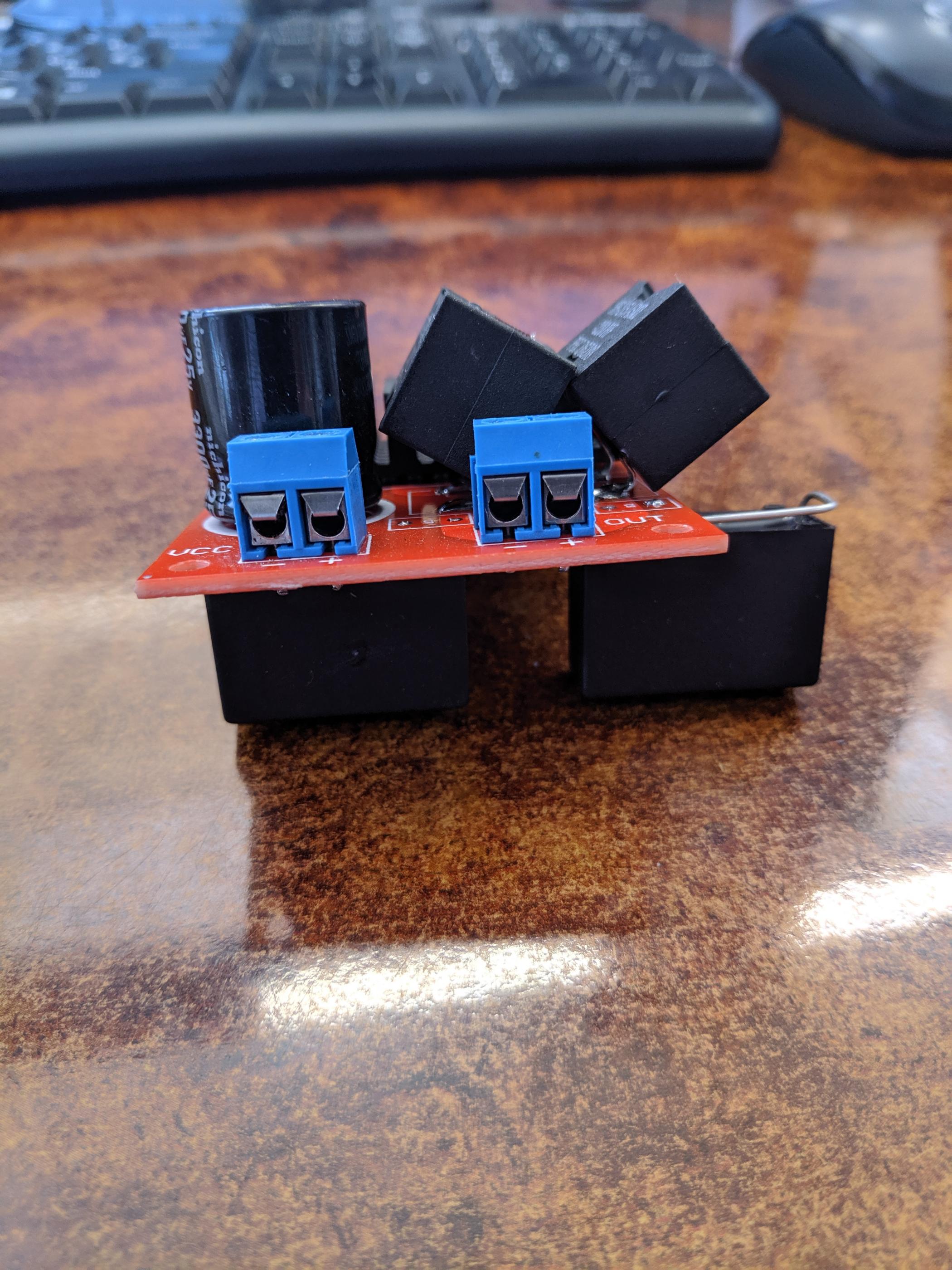

Did the soldering today, and it came out like this...
Looks stupid and badass at the same time😀
Hope those long leads won't cause any problems.
try it ! 😀
look before and check if some solder joints etc are not happend and measure with DMM if you do not get shorts.

Ok, old peasant stock boards are out, and new, upgraded, beefy ones (with output filter a few times more expensive than the amp itself) are in.
Let me say I changed one channel first, and then the other, hoping I could hear a difference. of the mod..
I guess I could use audiophool vocabulary to describe the sound now, but the simple and most honest thing to say right now is: I don't think there is any real difference. 😀
Meaning the humble Chinese amp board (with corrected carrier freq.) is a damn spectacular product.
Modded looks cooler, though. 😎
