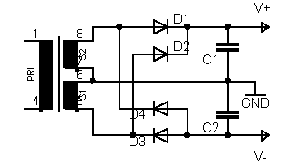

This way you use only one of the capacitors (10000uF) unless you modify the board.
Cool, man. What are the benefits to this board/circuit to simply having the capacitor going between voltage and ground?
hi
i personally do not have your board but i guess its like this: ...see pic
What FF mentoined is you have to connect it like you use just 1 output = 1 capacitor because you do not need the "negativ" voltage.
If you want to have both caps in parallel you have to modifiy the board layout.
chris
It is substantially the same. This board includes small HF-decoupling film capacitors and rectifier diodes for ensuring correct polarity. The main effect is the big 10000uF capacitor and you can also just add a separate 10000uF capacitor on the supply wires (voltage/ground).
Thanks for that!
Would this be a way to give reserves when PSU amperage is not up to spec?
Thanks for that!
Hi graham
lets go from the speakers "backwards"...
if your volume knob request more power the amps should be deliver the power.
The bass burst need the most power- for this the caps should deliver inbetween a very short time the needed current if the PSU is not able to hold the voltage and deliver the needed current.
so for some power brick the requestet short time is a problem. the concept of them is to deliver constatn a current and react very bad in dynamic requests by an amp. so a big cap could help if the PSU is too weak or your party should roll😀
so if you need much power the "correct" way is to choose i very strong PSU.e.g. 24V 10Amps = about 250-300W and not a brick with 24V 2,5A😉
chris
Thanks for that!
As Chris says, the PSU has to be sufficient to supply the power needed for the amplifier.
The supply line decoupling capacitors act as local buffers for the amplifier such that the PSU only needs to supply the average energy used by the amplifier. The capacitors will collect the energy from the PSU and forward the energy to the amplifier with the current needed by the amplifier. That current may heavily exceed the current the PSU can handle but only for a short moment. Thus you are right, a poorly performing PSU may be improved with good decoupling capacitors. The bigger the capacitors, the longer they can supply the amplifier with current without loosing too much voltage.
With a very good "capacitor bank" for decoupling, you can use a PSU of half the power that is maximum demanded by the amplifier. That is due to the "crest-factor" of music and the ability of the capacitor bank to smoothen out the amplifier energy consumption to near the average consumption.
