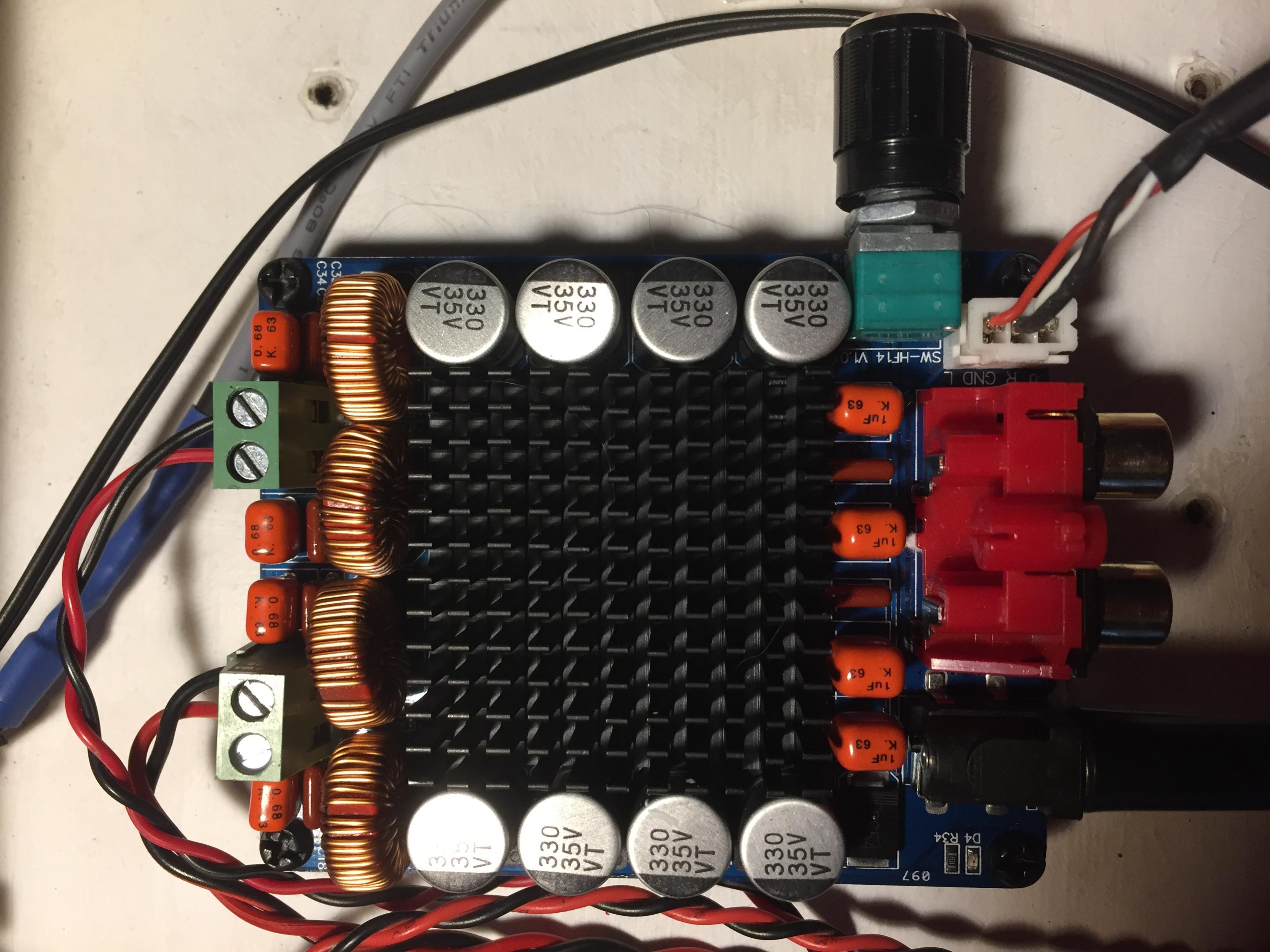

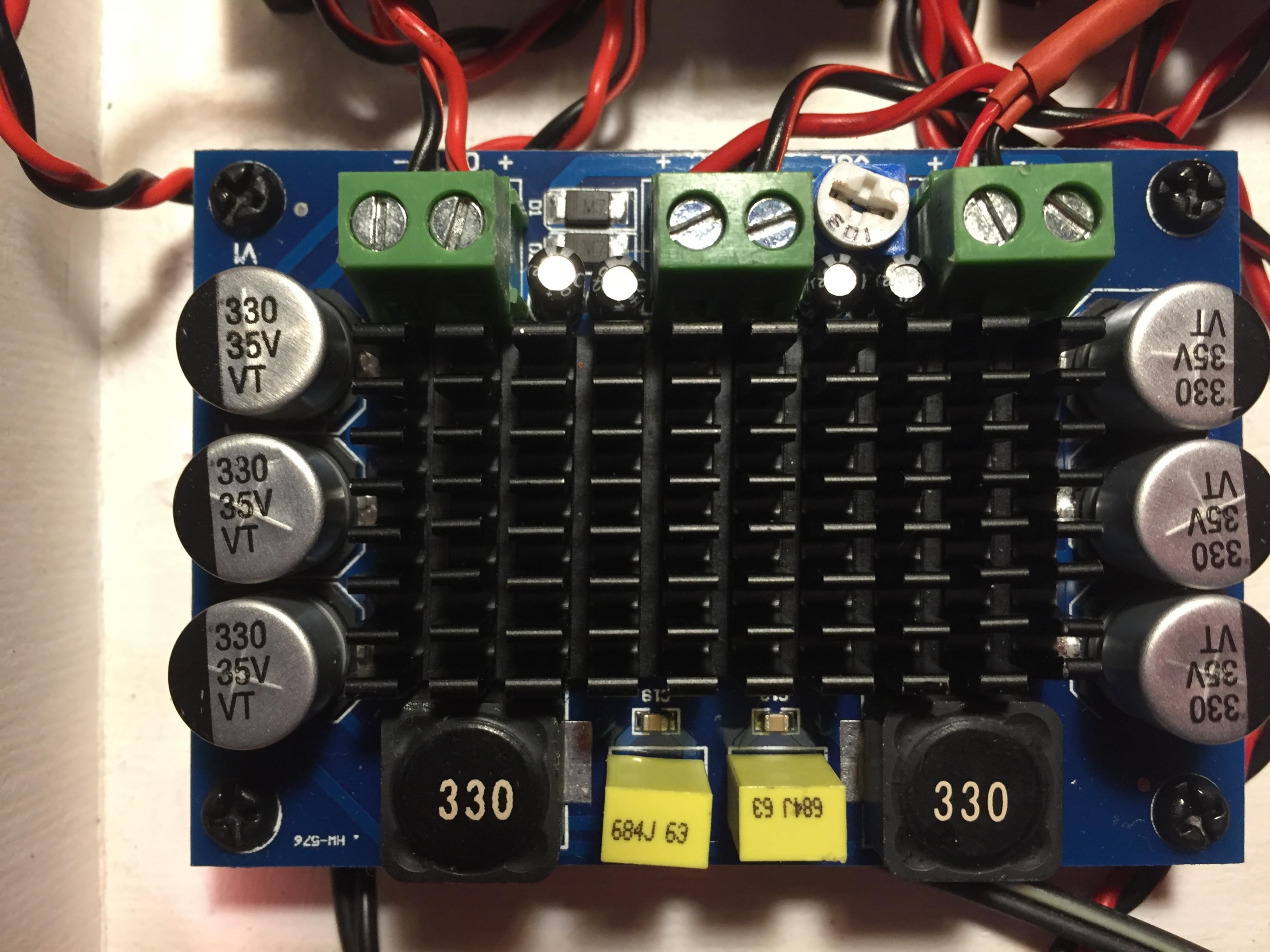

TPA3116 D2 mono amplifier as a stereo system?
I have the identical board and am trying to reduce hum/hiss. If I understand your instructions correctly, I can connect a 4k7 resistor directly across the input terminals, from positive input terminal to ground input terminal, then connect signal inputs as usual?
Also, I'm using a stereo TPA 3116 board in the same setup, so can I do the same with both signal inputs on that board?

Hi Erik,
This board should be without a volume potentiometer. Then, you just do as you say - connect 4K7 across the input terminal and ground. For the stereo board, between each of the two inputs and ground. Signal input is as usual.
If you have a board with a 50K volume potentiometer, then from the potentiometer output and ground.
Thank you FF, both boards have volume pots, so I'll have to see if I can identify which is the potentiometer output on each board.
You can connect the 4K7 directly on the volume potentiometer:
With the volume potentiometer axis (the one that is turned) pointing towards you and the three potentiometer terminals pointing downwards, you connect the 4K7 between the left-most terminal and the middle terminal. The middle terminal is actually the potentiometer output.

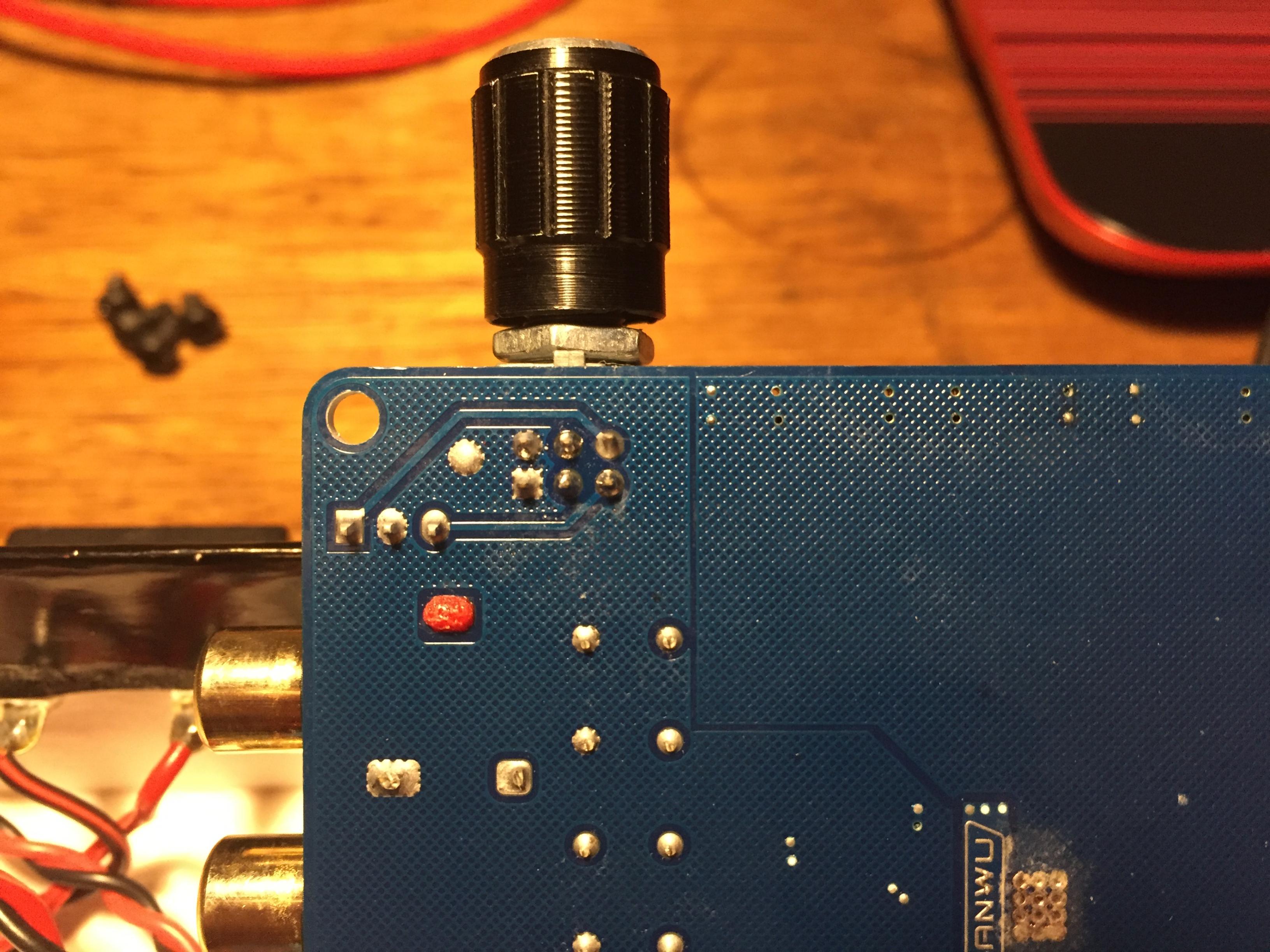

I'd need to dismantle pretty much the whole setup to get the boards out in order to connect resistors to the volume potentiometers. Instead, will the same effect be achieved if I connect the resistors at the signal inputs, since I can access these without any fuss. If this solves the issue I have, I can then remove the boards and solder the resistors in at the potentiometers.

Hi Erik,

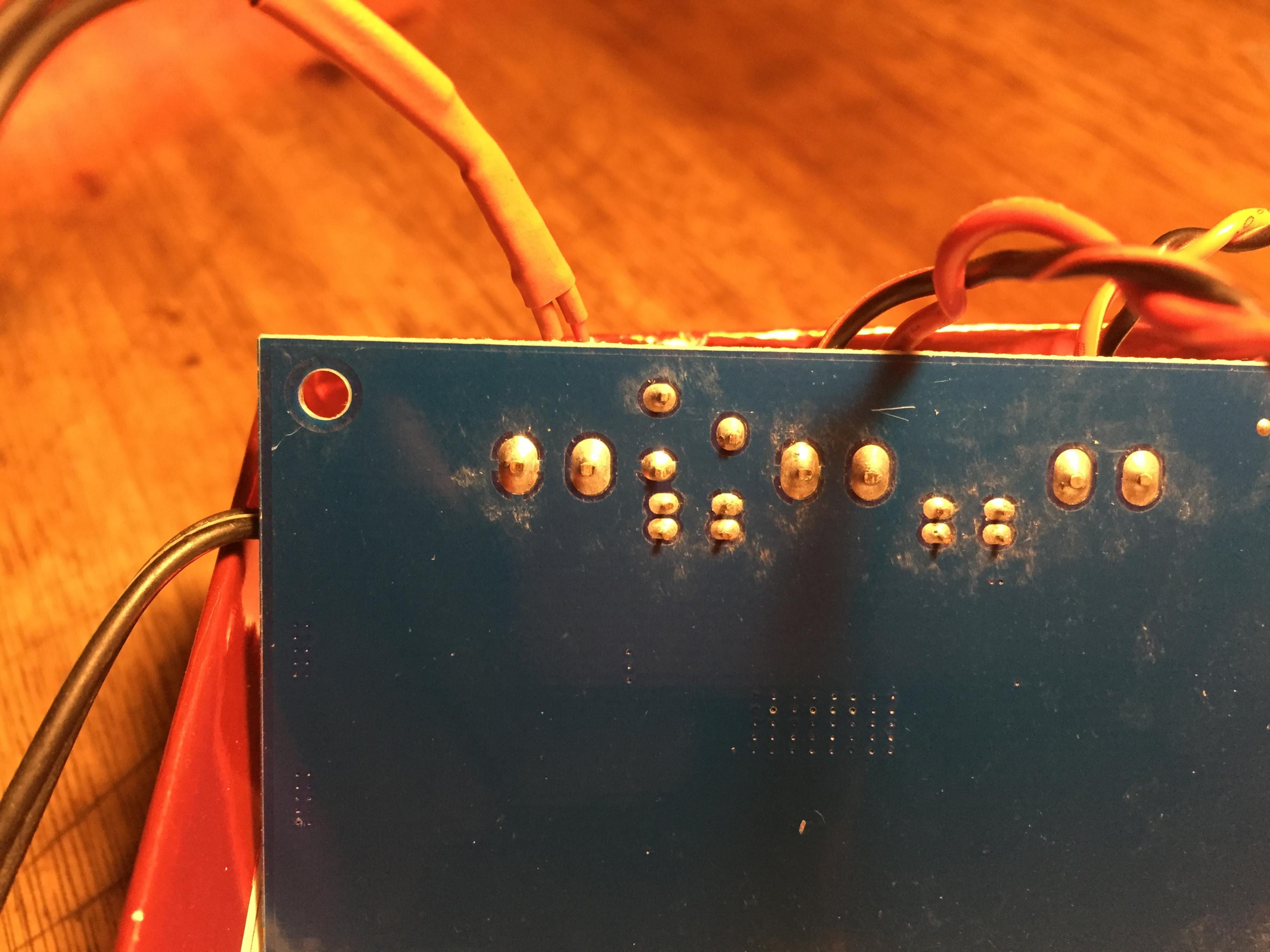

Sure, I'll take the boards out and post some photos.
The mono board - from rear of the board, the solder points for the potentiometer are the 3 points that form a triangle:
https://www.diyaudio.com/forums/att...-d2-mono-amplifier-stereo-system-img_1662-jpg
https://www.diyaudio.com/forums/att...-d2-mono-amplifier-stereo-system-img_1667-jpg
and the stereo board:

Many thanks Erik,
As I see the rear of the boards, it leaves the possibility to mount the 4K7 resistors on the rear side. Am I right?

Hi Erik,
I checked on my own TPA3116 mono-board. The small trim-potentiometer used as volume control on that board also increase the volume when you turn clock-wise. For that board and looking at the rear side, the 4K7 resistor has to connect the lower pad/pot.terminal (furthest away from the edge) to the pad/pot.terminal to the right (direction of the power supply terminals).
For the stereo board and as you show the rear side, the pad/pot.terminals to the left have to be connected with two 4K7 resistors to the pad/pot.terminals in the middle. One resistor pointing upwards and one downwards.
