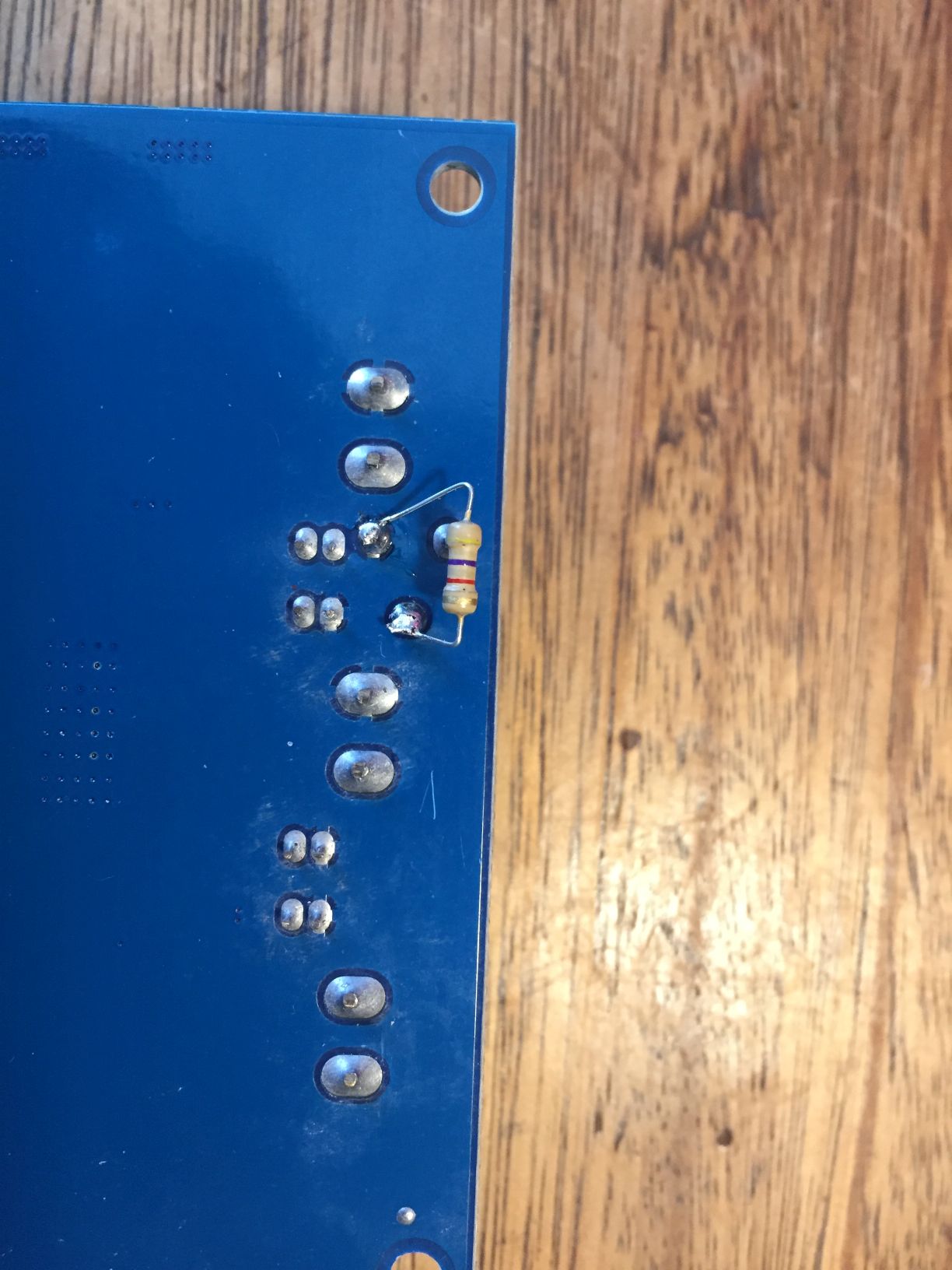

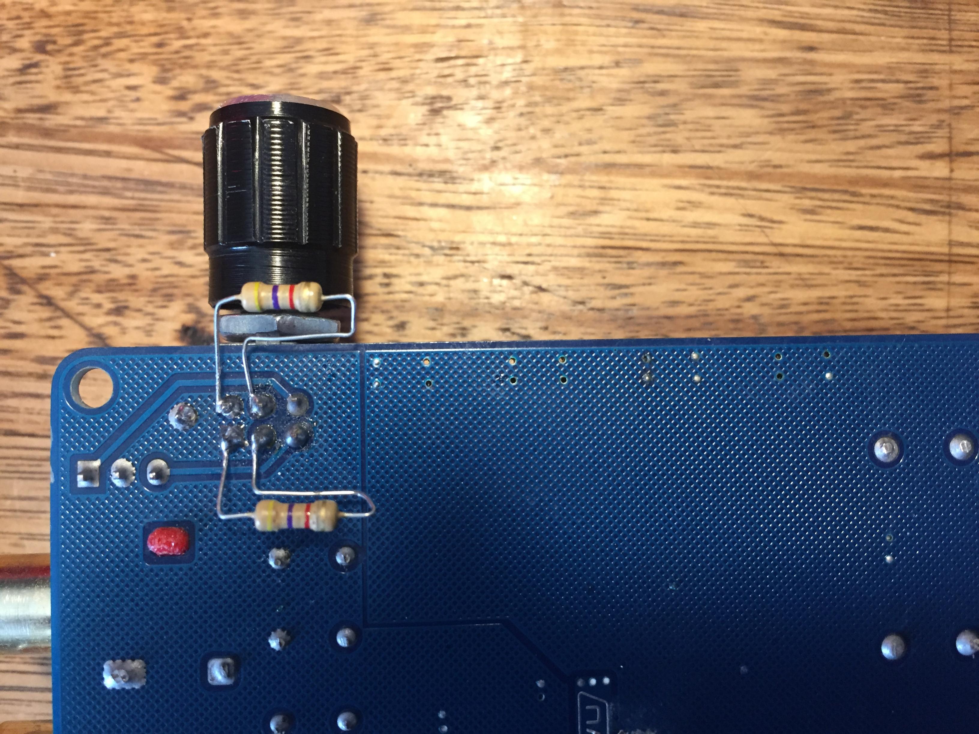

I've connected resistors as discussed above - the amplifiers are now dead quiet with everything at max volume, and I have a far more useful volume range, so I'm well pleased. During this exercise, I also discovered the source of a high-pitched buzz that was evident at full volume - it turned out to be a poor connection on the DC barrel for the stereo amp.

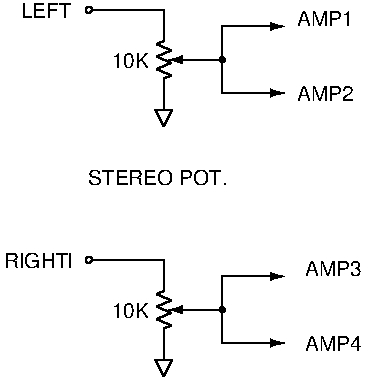

I would like to have two boards/speakers carrying the L signal and the other pair handling the R signal.
Ideally there would be a dual gang pot to keep both signals isolated.

I suggest the following connections (appended) using one stereo potentiometer.
In theory, a logarithmic potentiometer is best as it gives the best impression of the volume being increased regularly.
But, linear potentiometers are easier to find.

thx for the img FauxFrench, that's the same wiring I had in mind.
I never paid attention to the (audio) difference between a linear pot and a log one but I recently red about it so I may order both and try it myself. What (log) pot value should I get ?
( I'll connect the wiper lead to a microcontroller to drive some leds to show the volume )

10k like in the diagram. I’ve been meaning to order more ALPS pots myself.

I checked on my own TPA3116 mono-board. The small trim-potentiometer used as volume control on that board also increase the volume when you turn clock-wise. For that board and looking at the rear side, the 4K7 resistor has to connect the lower pad/pot.terminal (furthest away from the edge) to the pad/pot.terminal to the right (direction of the power supply terminals).
What has to be linked to by-pass the pot?
