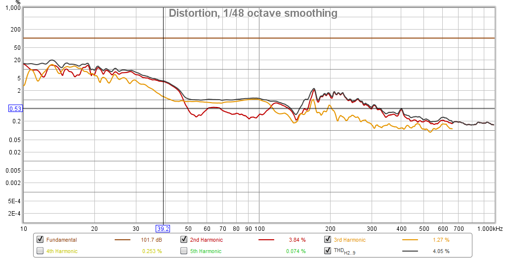

Looking at the processed response I have a hard time imagening the above passband distortion components would be noticable once the design is properly integrated with a top system.
The THD measured in that graph may not be representative of what might be expected at the SPL levels that the system will normally be played back at.

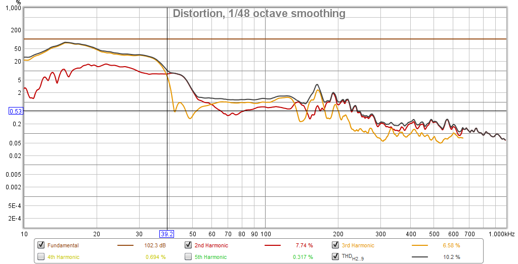

I do my THD tests up to at least 10% level in the passband to get an idea of what sort of peak level I can expect before distortion may become too noticeable. You may find that other distortion components end up showing up in the passband, or the level of the distortion peaks changes non-linearly as SPL output is increased.
For comparison purposes, see attached the distortion profiles for my redesigned Enigma 4th order BP (passband = ~38 Hz to 115 Hz -3dB). The first one shows what the THD profile looks like at the 10% within passband limit, and the other at -12 dB below this. Note how the shape of the 2nd order and 3rd order HD curves within the passband are different between the two measurements.
FWIW, I actually used the distortion profile for the 10%THD graph to help set the HP filter for this particular subwoofer -basically cut the input by 6dB at 30 Hz with a 24dB/octave filter, because most of the distortion generated below 40 Hz was due to driver excursion.

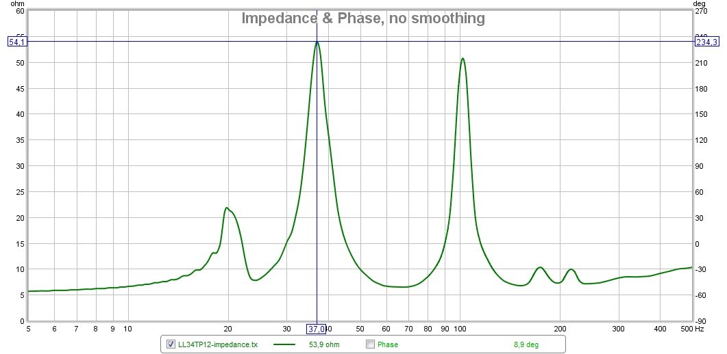

Actual measurement.

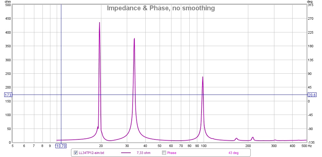

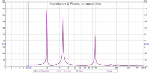

Hornresp sim.

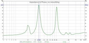

Here is an impedance measurement made with a Dayton DATS v2.
The impedance peak at 20 Hz is surprisingly low compared with the two others.
All three major peaks are quite a bit lower the the Hornresp simulation, but the 20 Hz peak is by far the highest one in the simulated graph, while it is the lowest one in the measured on.
Is this from the lack of stiffness in the 22 mm particle board walls of the enclosure?
The lowest peak will always be somewhat noticeably off from the sim because of the model that Hornresp uses. Basically some additional parameters are need for the driver, and these are not usually provided. Look up "Frequency dependent damping". All of the measured peaks will be lower than what the sim suggests they should be because the Hornresp model does not include losses.
If the frequency of the other peaks is significantly off from the Hornresp sim, then that means that the sim does not accurately describe what was built. This happened with my first TH build, and the likely cause was that my estimates for path length in the TH were slightly off.
