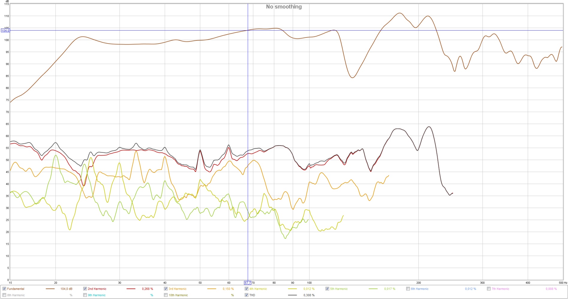

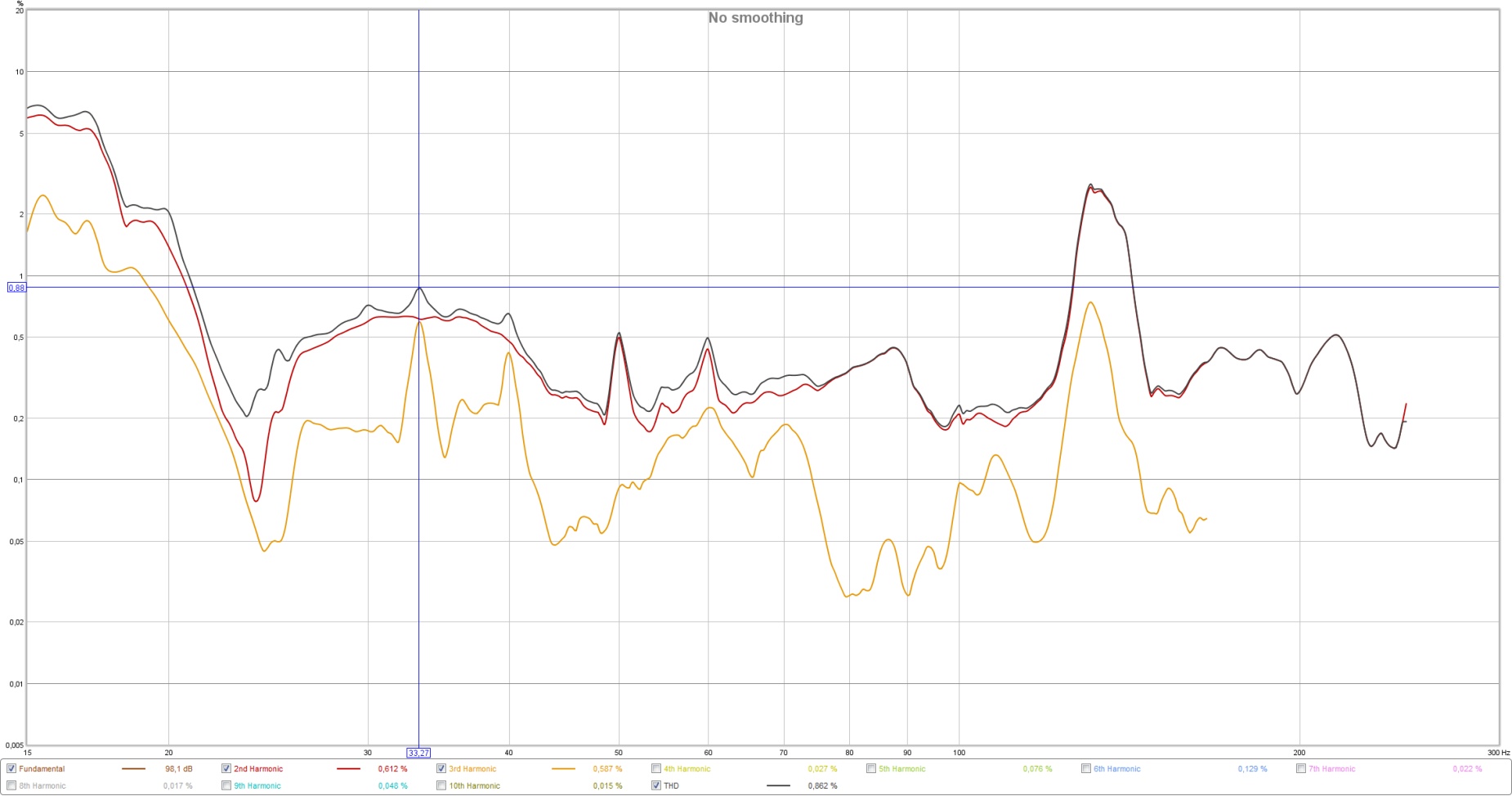

Thanks a lot, distortion profil conform really well what was expected.Here are some first measurements of this little beast.
I have overlaid the raw response with the as-used response with EQ and Xover using my MiniDSP 2X4HD. All the measurements are taken indoors with an Umik microphone and REW. Microphone 5 cm from the port on one side of the box (there are two ports. One on each side). No smoothing. The distortion graph has some small peaks where it does indeed get close to a single percent THD, but overall the THD is centered around the 0,5 percent level for most of the passband.
When scanning though the passband in the distortion graph it is very clear that the distortion is highest in the lower part of the passband where there is no acoustic positive feedback. From 50 Hz and upwards the positive feedback makes the driver behave like it had a lot more Bl and moving mass - a much more powerful driver.

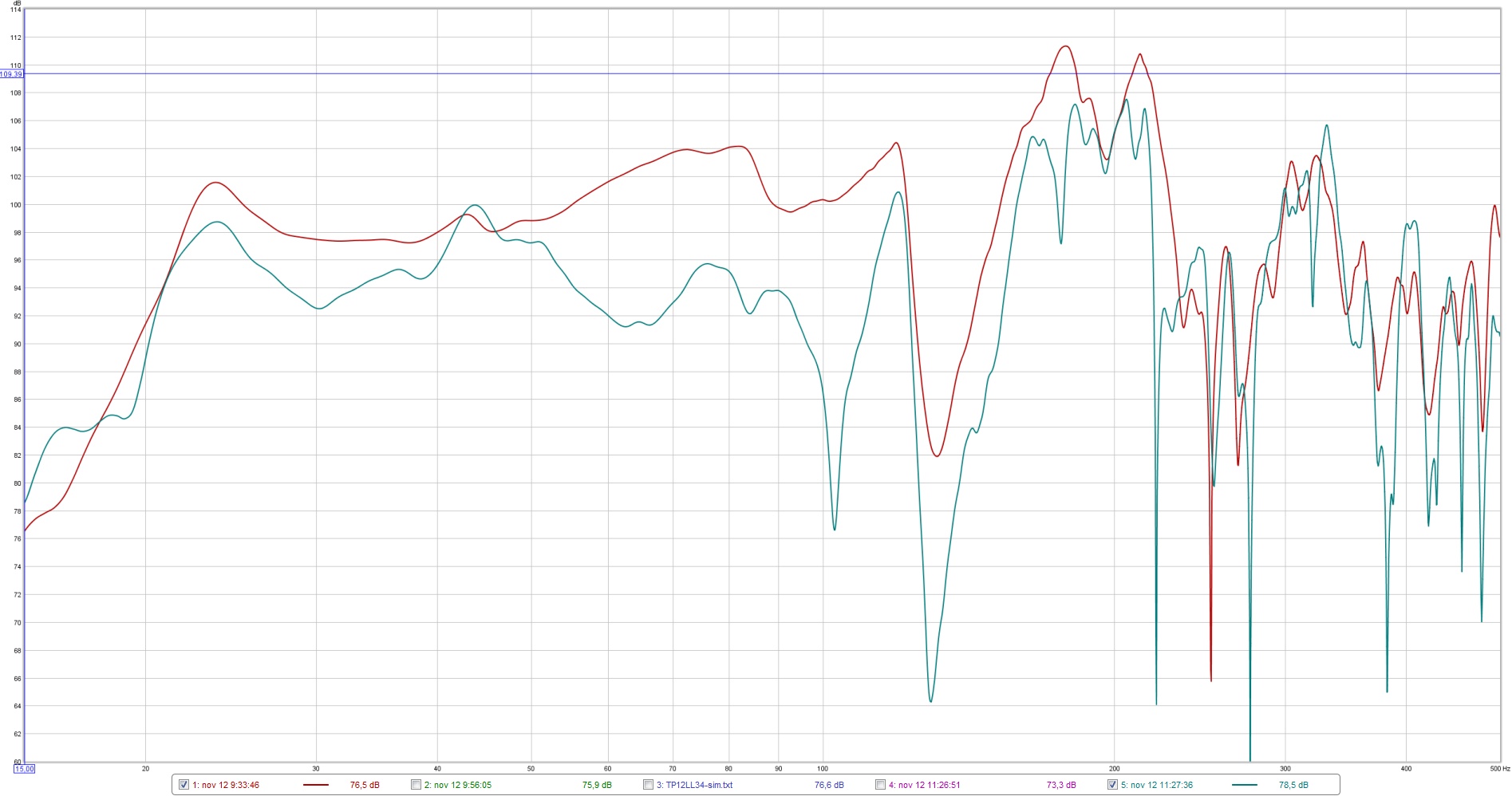

I measured from 10 Hz to 500 Hz in order to get a decent amount of the out of passband ripple and distortion. The ripple peaks 6,3 dB (not quite 15 dB) above the peak of the passband. I guess there are other ways of weighting this kind of comparison but I just took the most obvious example first. I am sure someone will tell me a better way more to your liking if anyone wants it.

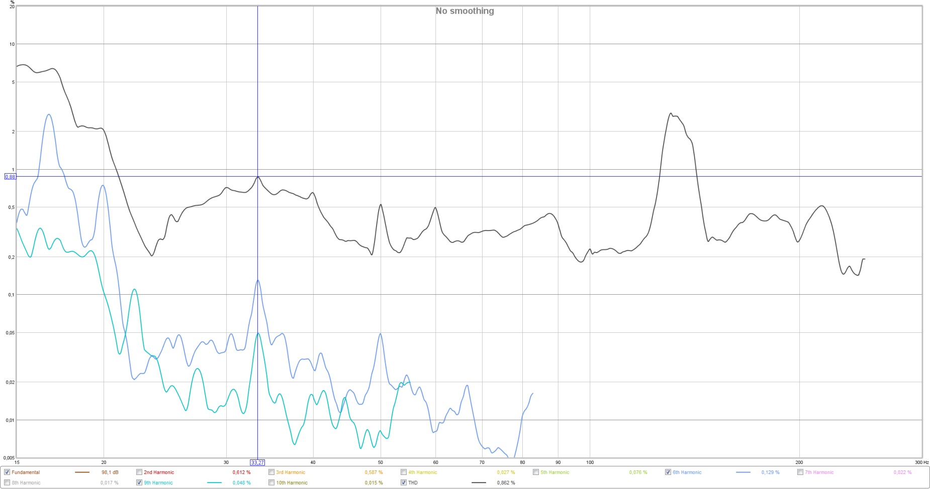

H3 between 50-70hz = distortion acting in 150-210hz just right in the spike.
H3 dip around 46hz =right in you dip at 138hz
H2 spike at 40 hz = right in the 80hz response spike
H5 spike at 40 hz = right in the 200 hz response spike
H3 at 33hz spike => this one, and some others, weren't expected ^^

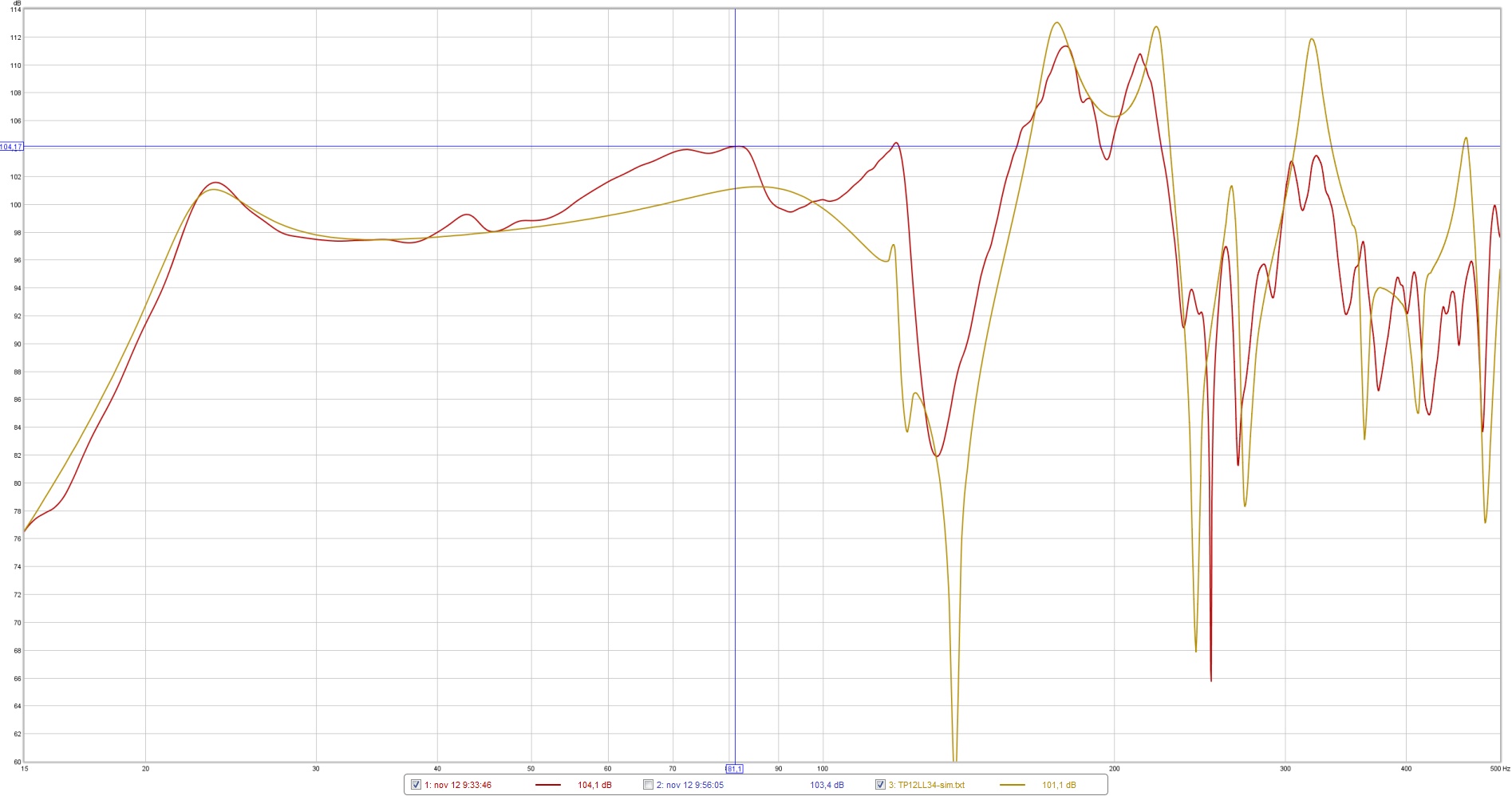

Here is the Hornresp simulation compared to actual measurement.
Close enough.

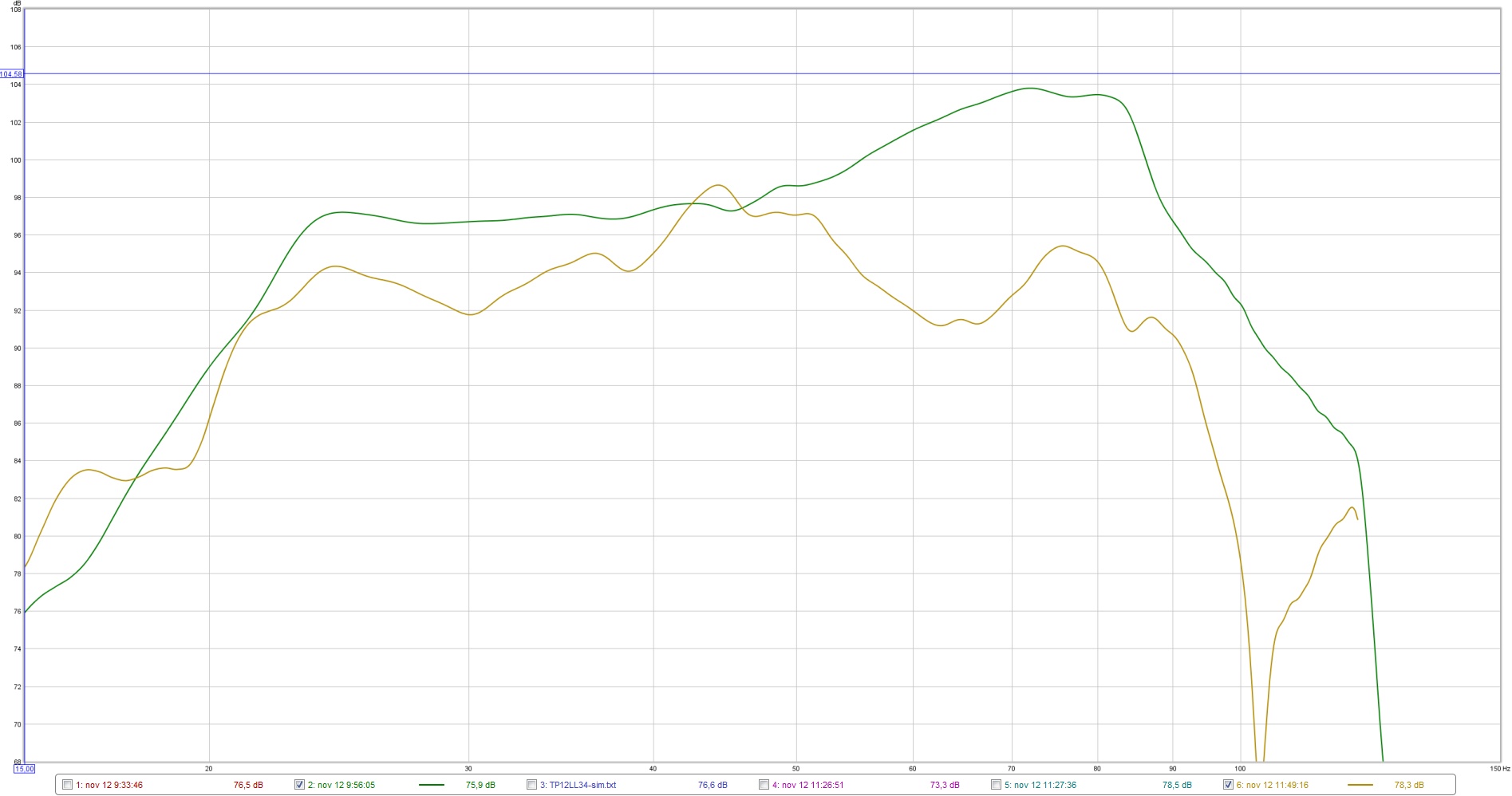

Here is the reason why I always want a midbass peak.
The room gain profile always tend to tilt the response curve the wrong way and make it sound bottom heavy and "slow".
Red curve is 5 cm from the mouth. The green curve is in my living room sofa where I usually sit when I watch movies and listen to music.
No smoothing, Xover or EQ in any of the measurements.
Now imagine a "flat" response in the same acoustic environment.....

Here it has 0,308 percent THD at 104 dB 5 cm from the mouth. I don´t know the exact power at that exact frequency, but it is a quite exact defined level.
Thanks for doing the math showing the correlation between the out of band peaks and the distortion products withing the passband. Very interesting!
Since the over all level of distortion is quite low, and it sinks with increasing frequency, it does not worry me that much for normal indoor listening levels.

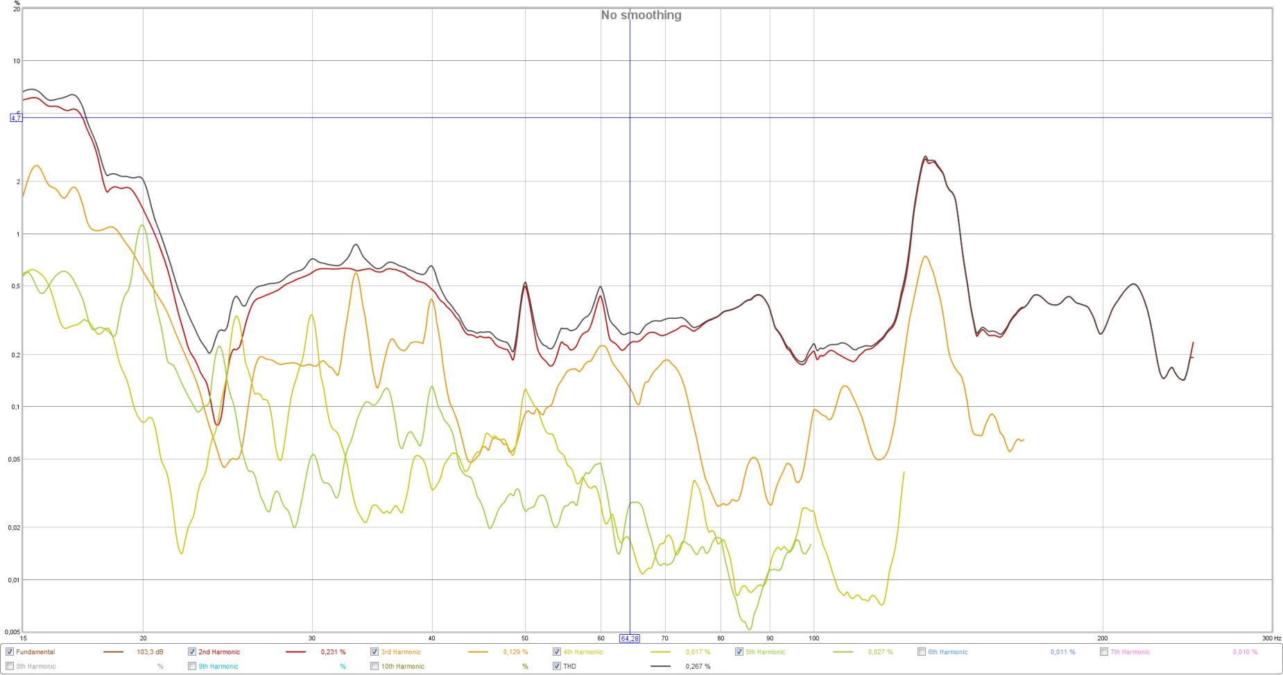

FWIW, I found that plotting distortion normalized to the fundamental is more revealing of a system's distortion characteristics. Can you the THD curves for the build with the distortion normalized to the fundamental please ?
Like this?
That's it, thanks.
Also, usually I don't bother plotting anything above the 3rd harmonic, unless the system has some audible issue that I'm trying to identify and resolve. Makes for a less "busy" graph

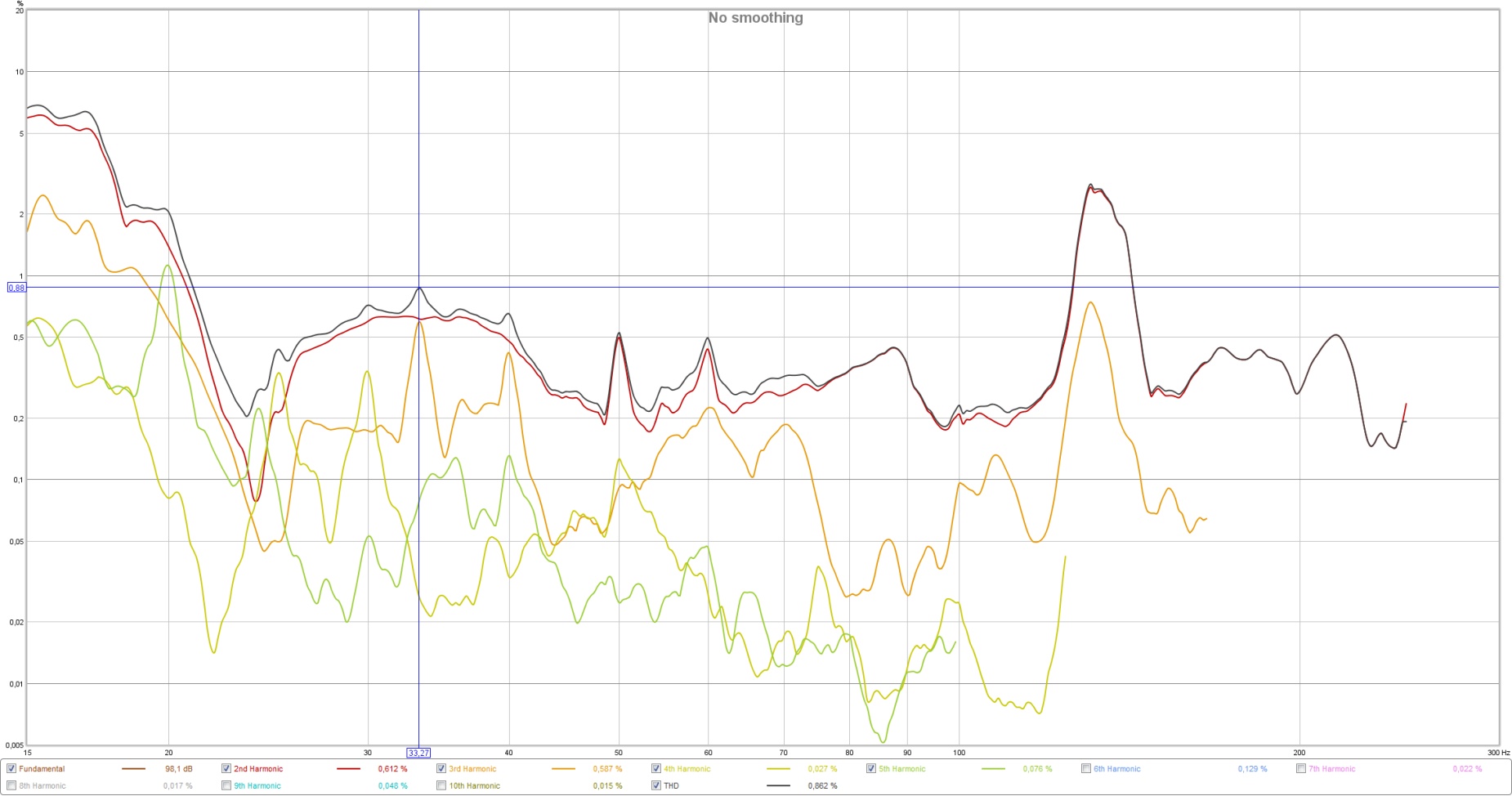

Check the 6th Harmonic 🙂
Interesting results! Good agreement between simulation and measurement.[

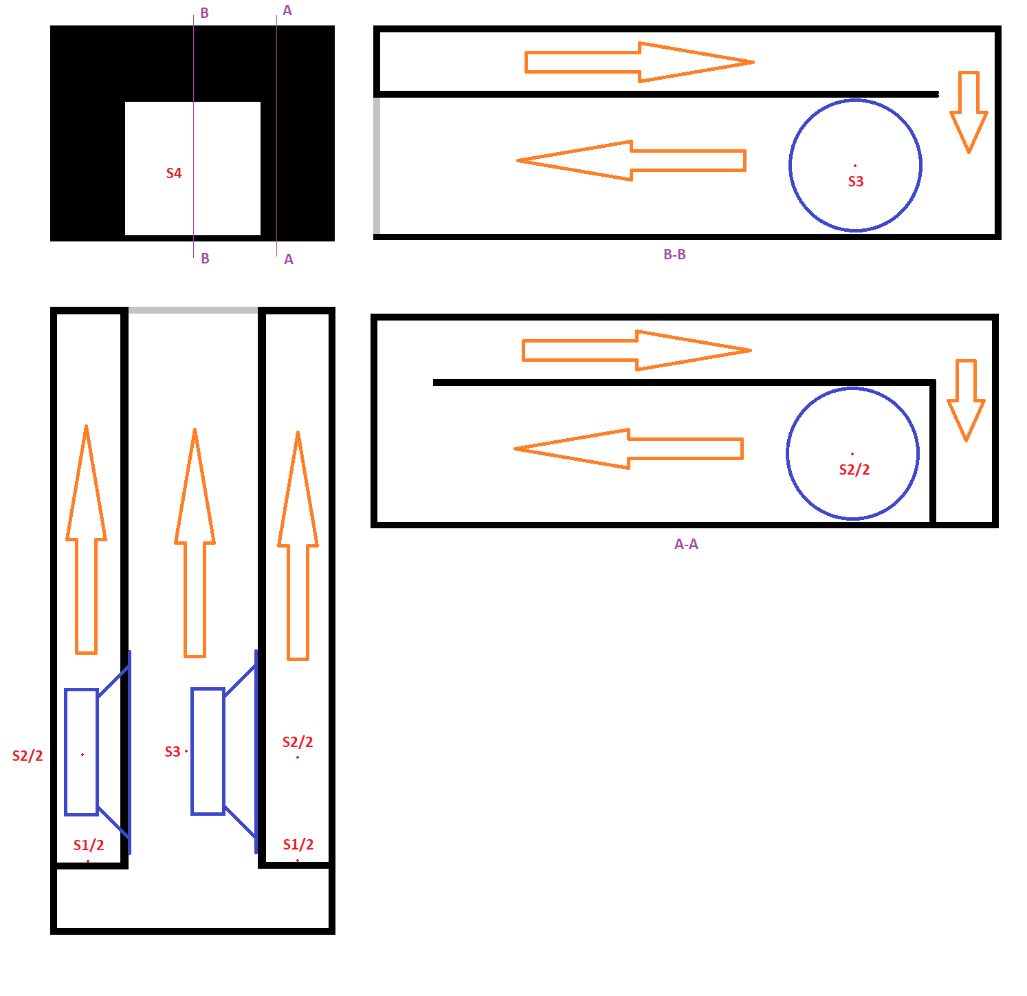

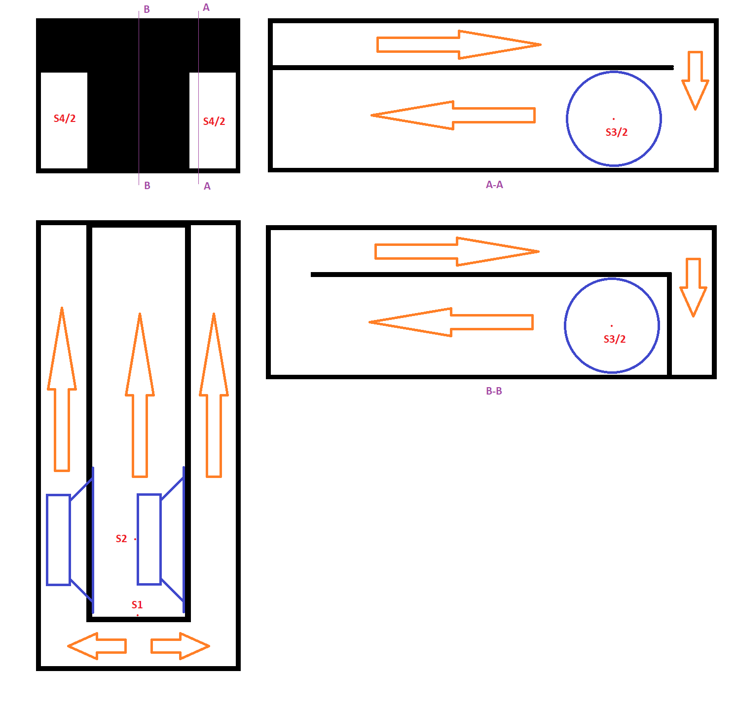

On another note: I am toying with the idea of building a very light tapped horn (glass fiber/epoxy and foam sandwich) that would require a push-pull configuration for force cancellation. How would you fold that? Usage would be as a party subwoofer. Maybe something like this:
/Anton
Or maybe better like this (one output instead of split into two):Interesting results! Good agreement between simulation and measurement.
