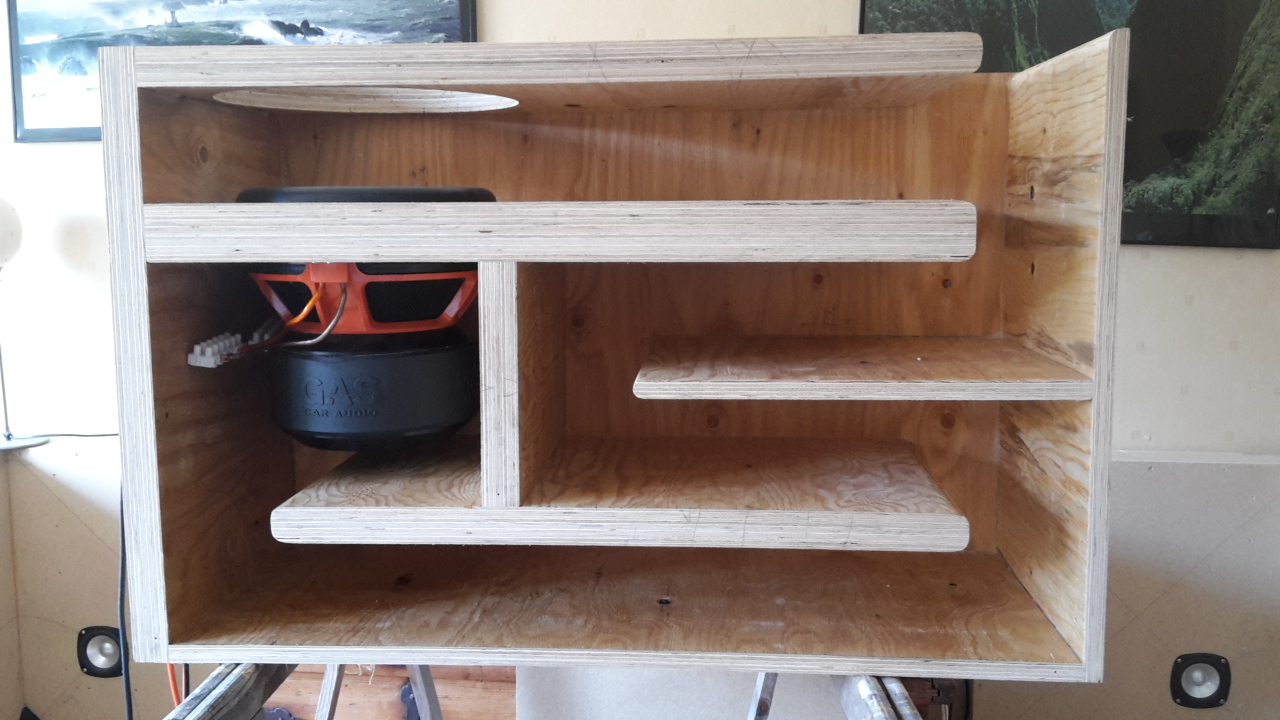

The driver is mounted in the 44 mm baffle and all the internal sharp corners are rounded with a router.

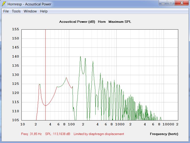

What does the displacement-limited theoretical SPL for that design look like? The driver's specs suggest a pro audio 12", and those usually have limited Xmax as compared to say a 12" driver designed for HT subwoofer use.
For comparison purposes, the attached is the theoretical displacement-limited output of a Dayton Audio RSS15HFA 12" driver (14.3mm Xmax) in a damped 175 liter offset TL design.

This is the theoretical max spl based on 8 mm xmax and 700 watts of power.
Based on my experience with lots of tapped pipes with lots of positive feedback I would say 120 dB max spl from 23 Hz to 110 Hz with some extra headroom (10 dB) in the mid bass. All in 1,0 Pi radiation angle and without the room gain.

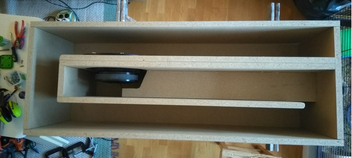

Dry mounting of all the parts to see that they all fit before I commit to the build.

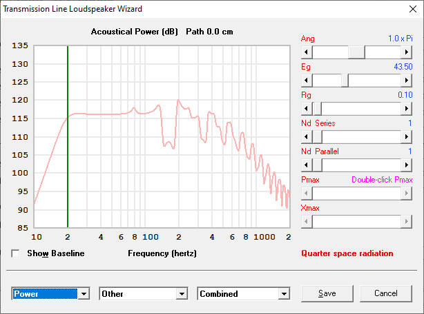

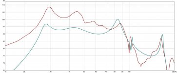

GD of your design in gray and the 167-liter version.
I don't see any problems with summation, 1/4 wavenength at 172 Hz is still 0,5 meters...

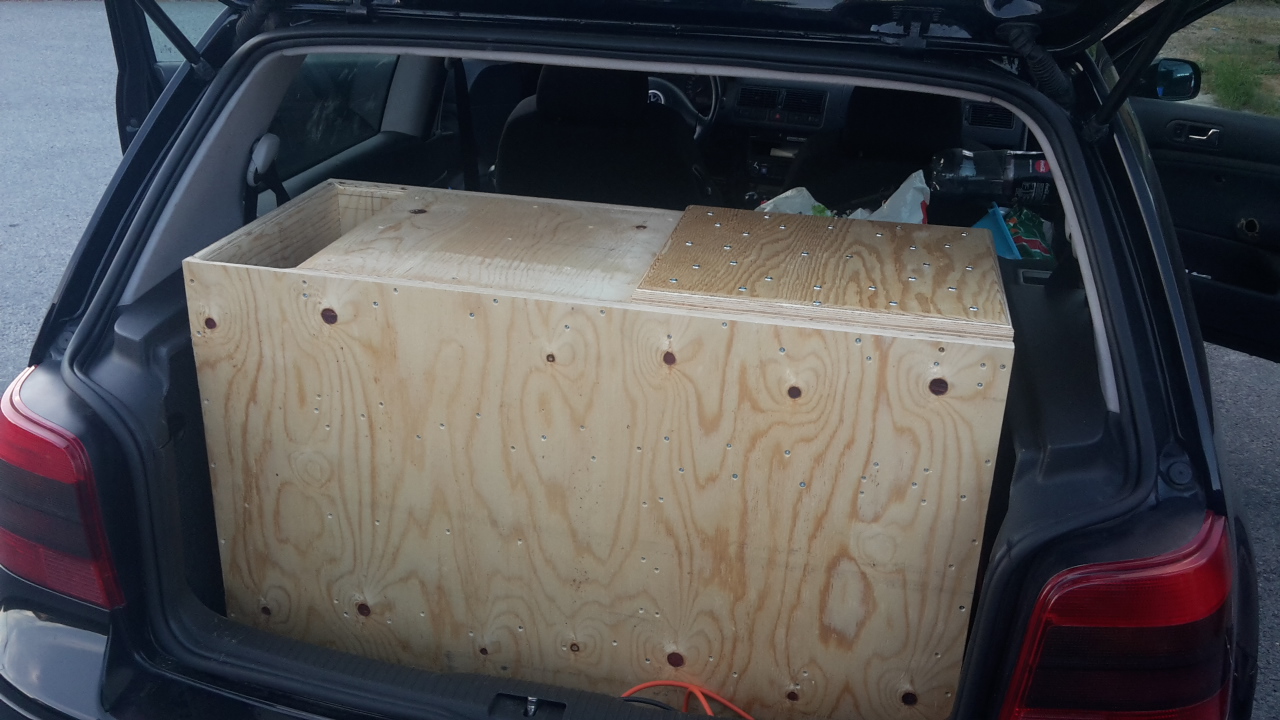

In this build there is a distinct kink in the spl and GD graph as both measured and simulated. The chamber behind the driver turned out a little larger then I intended which made the summation worse then my first simulations predicted.
The summation defect is very audible with 90 Hz 24 dB/octave xover. But is it of minor importance when playing 142 dB at 30 Hz in a car. 😀
This isn't what i asked. Playing a sinewave of 30 hz, measuring 142dB, doesn't mean there is 142 dB output at 30 hz. You mesured 142dB of total 30 hz fundamental+harmonics+noise. So you don't know what was the level of the produced fundamental. No problem. But this is of no use for evaluating sound quality of a system.

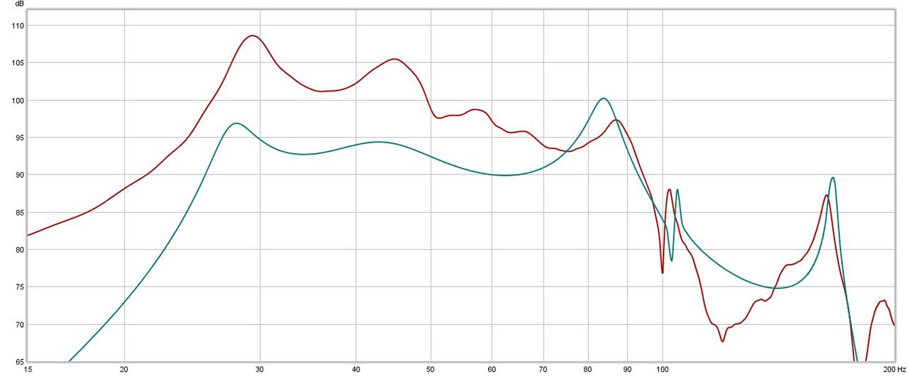

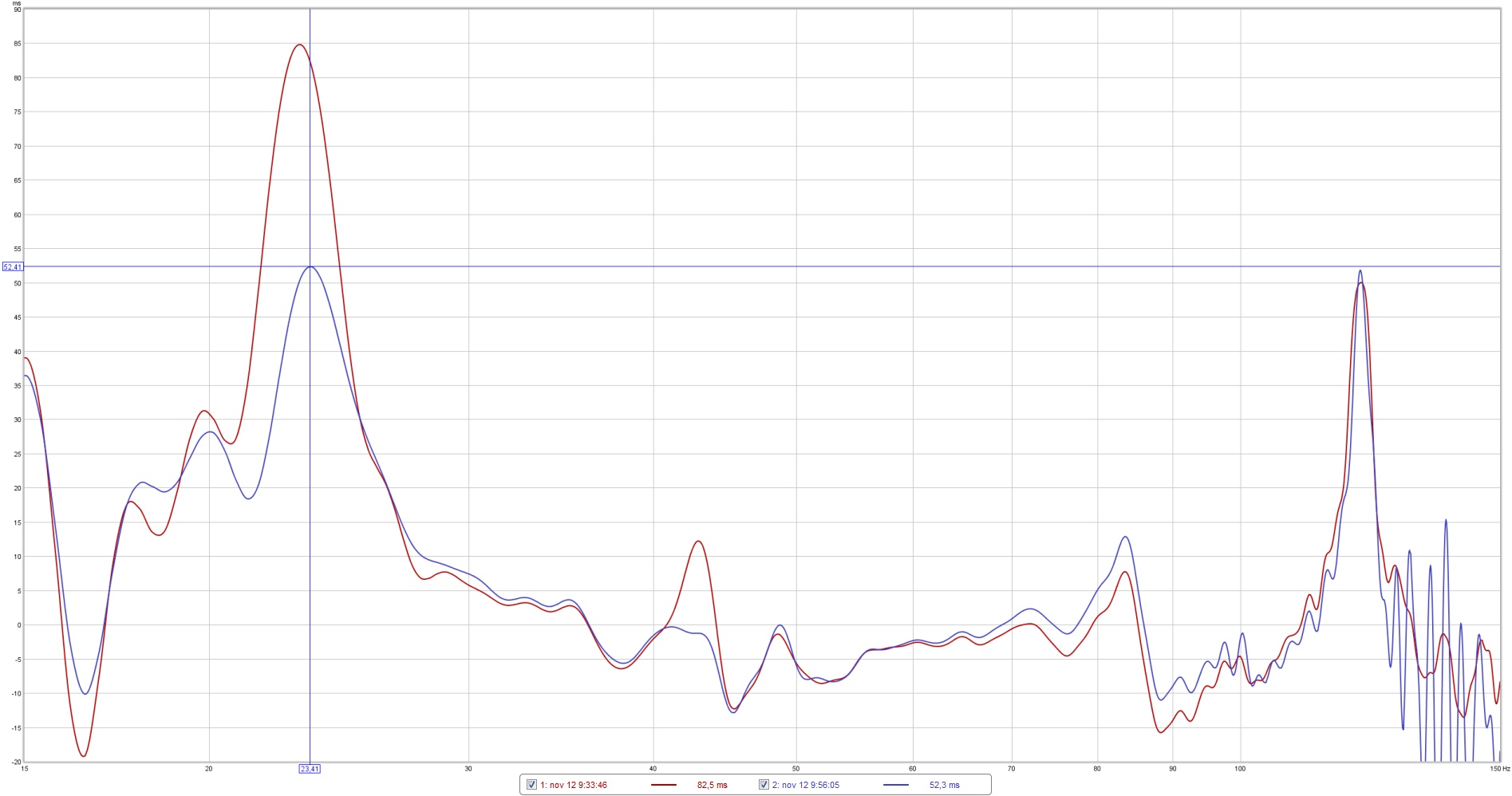

Thanks for your examples and explanations. I did some reverse engineering using your simulated SPL plot. It gave a shift of 10 dB at the kink. If I apply that to my 167-liter-125- Hz resonance nulling, it gives me a 5 cm too long segment and a GD of 80 ms. If I make it 5 cm too short, it also makes the kink 10 dB but GD gets -120 ms instead.
This makes me think whether you heared the GD shift, SPL shift or both. Your thought on this? The SPL was reduced by some 10-15 dB already at the kink by being out of bandpass. Did you listen to the sub only or was there a top system too?
As you could see in the example i linked to, there was no SPL shift in the bandpass below 135 Hz. If so (in a min phase system as this), there should be no phase/GD shift either and thus not be audible. However, to match simulation to build within a cm or two requires some iteration I guess. The reward would be greater sensitivity and bandwidth.

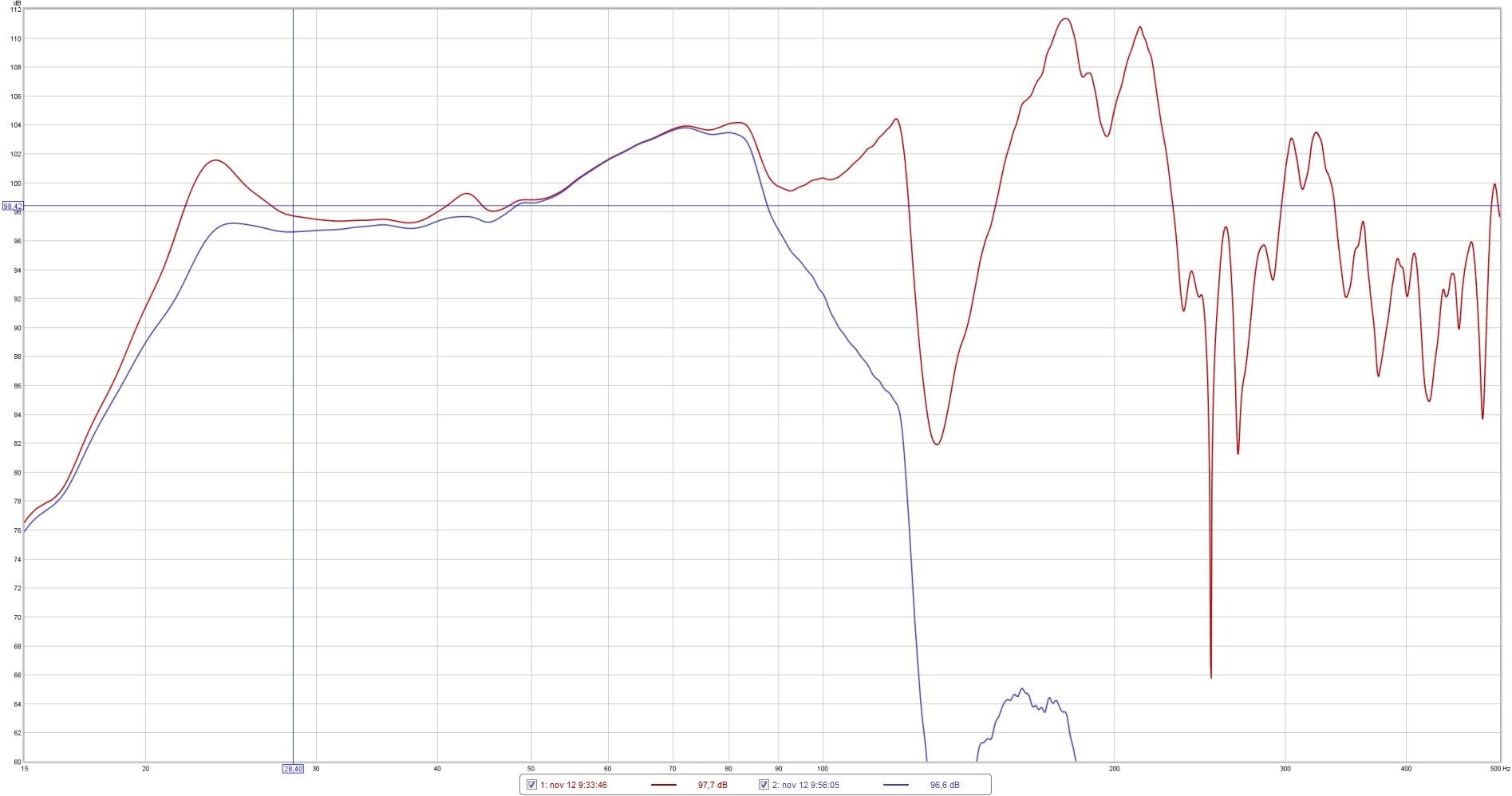

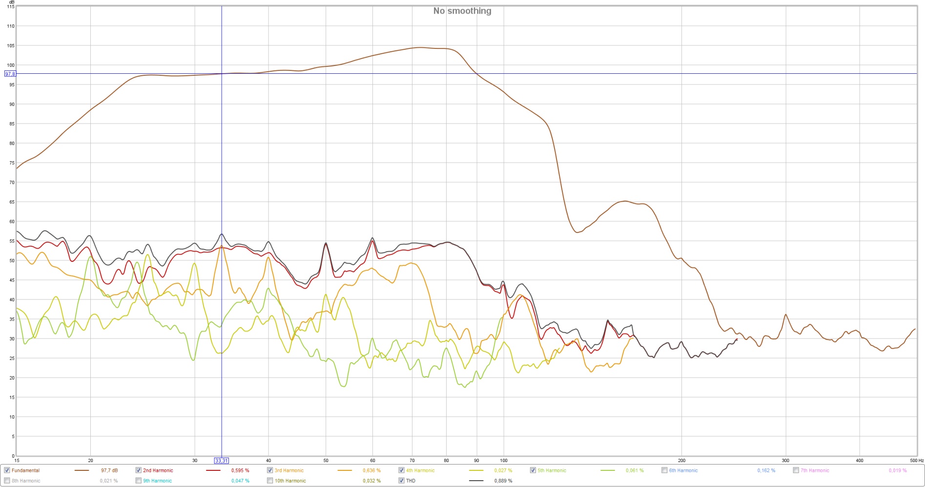

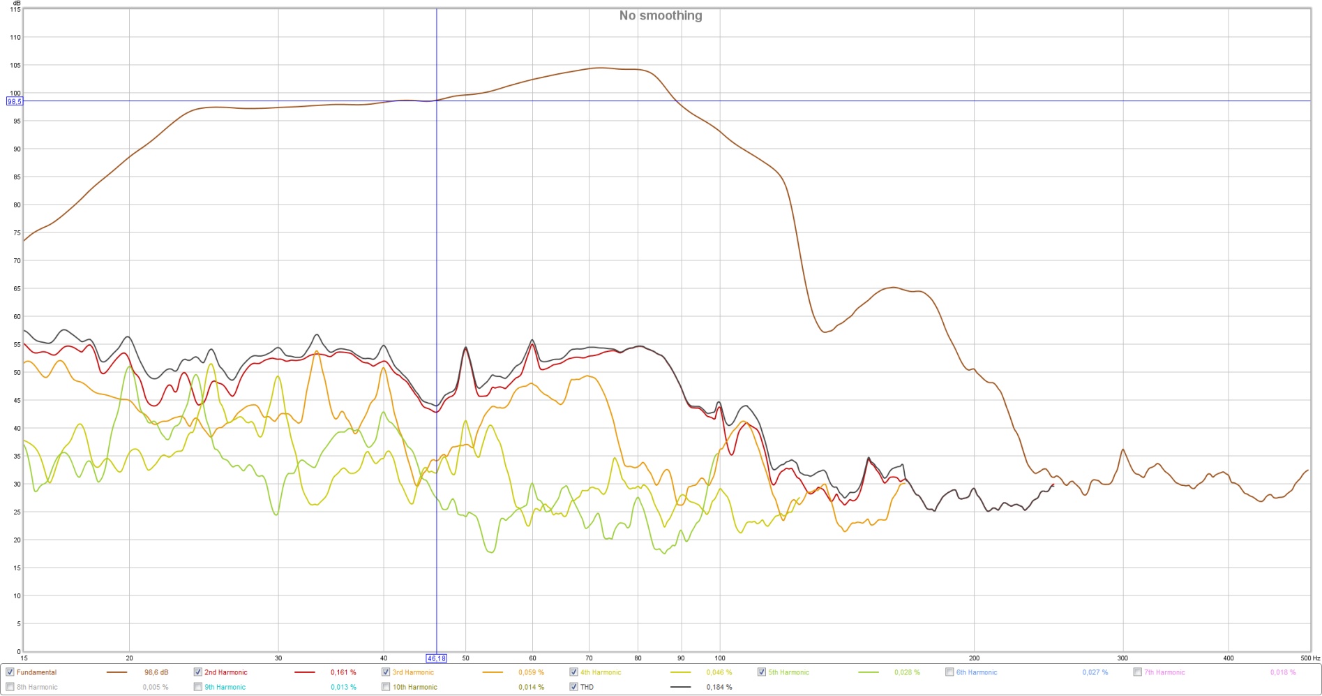

Here are some first measurements of this little beast.
I have overlaid the raw response with the as-used response with EQ and Xover using my MiniDSP 2X4HD. All the measurements are taken indoors with an Umik microphone and REW. Microphone 5 cm from the port on one side of the box (there are two ports. One on each side). No smoothing. The distortion graph has some small peaks where it does indeed get close to a single percent THD, but overall the THD is centered around the 0,5 percent level for most of the passband.
When scanning though the passband in the distortion graph it is very clear that the distortion is highest in the lower part of the passband where there is no acoustic positive feedback. From 50 Hz and upwards the positive feedback makes the driver behave like it had a lot more Bl and moving mass - a much more powerful driver.
I measured from 10 Hz to 500 Hz in order to get a decent amount of the out of passband ripple and distortion. The ripple peaks 6,3 dB (not quite 15 dB) above the peak of the passband. I guess there are other ways of weighting this kind of comparison but I just took the most obvious example first. I am sure someone will tell me a better way more to your liking if anyone wants it.
