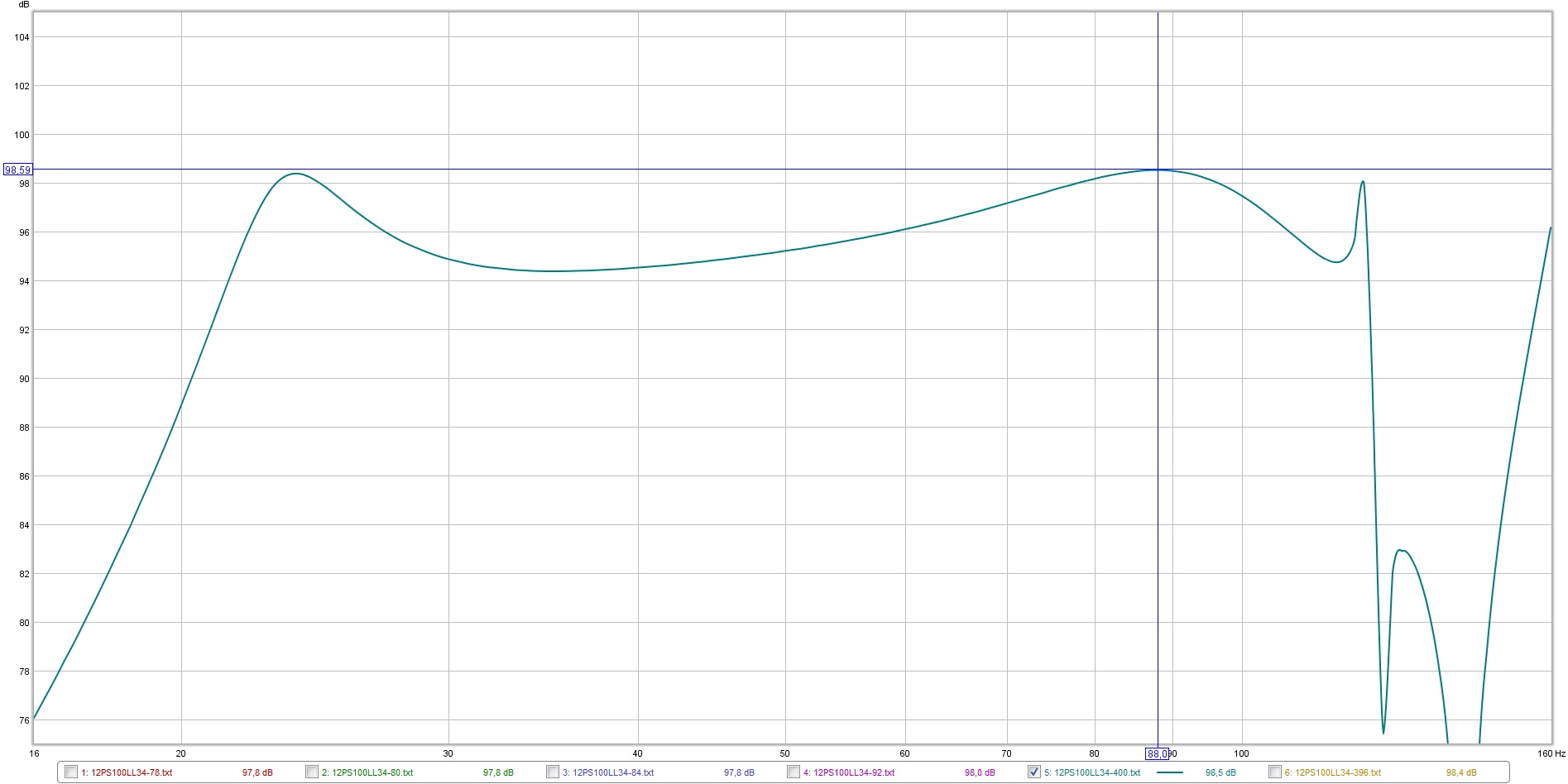

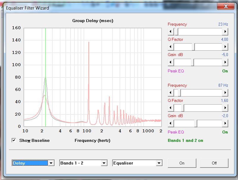

I have been thinking about and simulating variations of this tapped pipe for a while now. Today the stars aligned with the moon, my morning tea and my morning mood and access to the car, so I loaded Cypress Hill into my car stereo and went and bought some 22 mm particle board for a cheap and easy to build prototype based on my B&C 12PS100.
I hope this tapped pipe will have it all. Reasonably high efficiency, a great midbass punch and attack, reasonably small footprint, cheap and easy to build and a great extension downwards into the abyss. These desirable properties seldom walk hand in hand, but I hope a healthy dose of positive acoustic feedback will create a lot of synergistic effects enabling the presence of all those desirable properties at once.
The name TP12LL34 comes from "tapped pipe Long L34". "Duality" comes from the fact that the great extension downwards does not stand in opposition to a great midbass. Positive feedback is the pressure that the last long section (L34 in Hornresp lingo) exerts on the cone throughout the midbass.

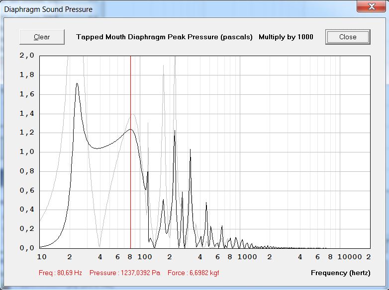

Here is the Hornresp simulation of cone pressure on both sides of the cone overlapped. The Grey line is the throat pressure and the black line is the mouth side of the cone.
There is a lot of positive acoustic feedback from 50 Hz somewhere up to almost 100 Hz. This can also be seen in the spl graph where a "normal" tapped horn with substantially shorter L34 never have such a large and low Q mid bass peak and wide usable bandwidth.

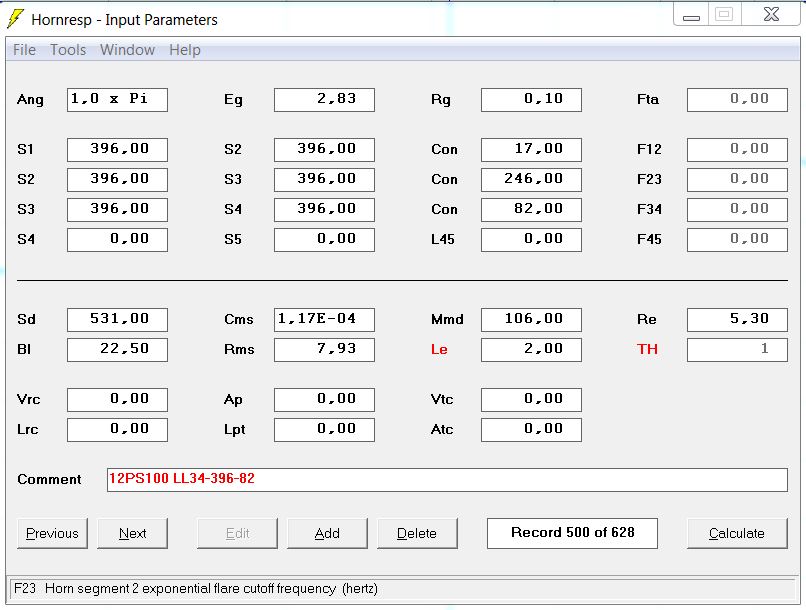

I have 3 of these sitting new in their boxes, so interested in seeing this. Question....shouldn't the sections be summed as PAR instead of CON?
It does not matter with straight non expanding sections.

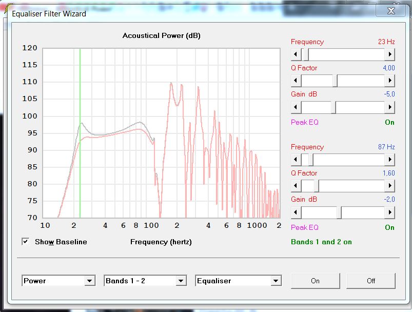

With and without EQ. It is quite easy to EQ this design to a "smooth" response if desired.
I am not overly worried about the peaks. They seem to give a nice character for HT and hifi if not overdone. The low frequency peak will add a very tactile and physical "breathing" of the body of instruments. You can sense a large scale "breathing" in the whole house with this kind of tapped pipe. Perfect for home theater. Very convincing and entertaining with typical Michael Bay movies. Might need a dB or two of EQ for Hifi to stop overwhelming the rest of the sound reproduction.
The mid bass peak is very low Q with very flat GD throughout the whole "punch and attack" range. It should normally not need any EQ, except if there is a bad room acoustic interaction (room peak coincides with tapped pipe peak).
With +15dB of THD-increasing "noise" between 150 Hz and 350 Hz, that design might end up having its own special "sound" indeed.
That is nothing that a small amount of well placed internal carpet and damping wool can´t remedy. +15 dB at and above 150 Hz is a typical simulation artifact. Hornresp treats the walls of the enclosure as infinitely stiff and solid, but 22 mm particleboard is anything but that.

I've tossed designs that have shown less out of band noise than that - they never made it from paper to wood. That level of out-of-band noise can make an otherwise good BP sub sound awful, and I'm sure the same applies to tapped 1/4 wave designs, as they're basically another form of series-tuned 6th order BP.
Yes, a few dB will be shaved off due to losses that are not shown in Hornresp, but 15dB is quite a big mountain to cut down - 3dB of losses will still leave you with a 12dB out of band "mountain range".
That range (150 Hz ~ 350 Hz) might be difficult to deal with by damping the sides of the enclosure, and damping it too much might end up killing the response at the low end of the spectrum.
Have you tried extending the S1-S2 length, and then simulating damping in that section in Hornresp? I've found that could do a pretty good job of cutting down the out of band "noise", and being able to sim the damping effect in Hornresp would allow you to re-tune the enclosure accordingly to make up for and loss of output at low frequencies.

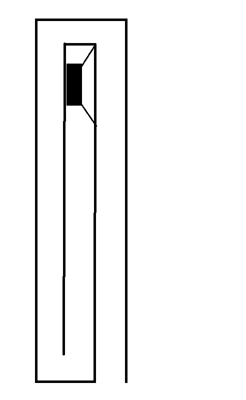

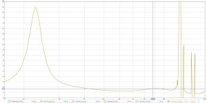

An alternative to TH; Here are two versions of Compound horns using equal cross section area and cut off frequency. They both provide greater upper extension and sensitivity. The two examples differ by canceling different resonances with different pipe segments.
The discontinuity around 185 Hz should be treatable by adding a stub to cancel out the third harmonics of horn segment 2. However, I don't know how to model it. This would increase bandwidth even further, alternatively ease integration.
The reason I don´t design speakers like that is seen in the GD graph. Those small kinks in the spl graph might not look like much but is easy to hear in real life.
